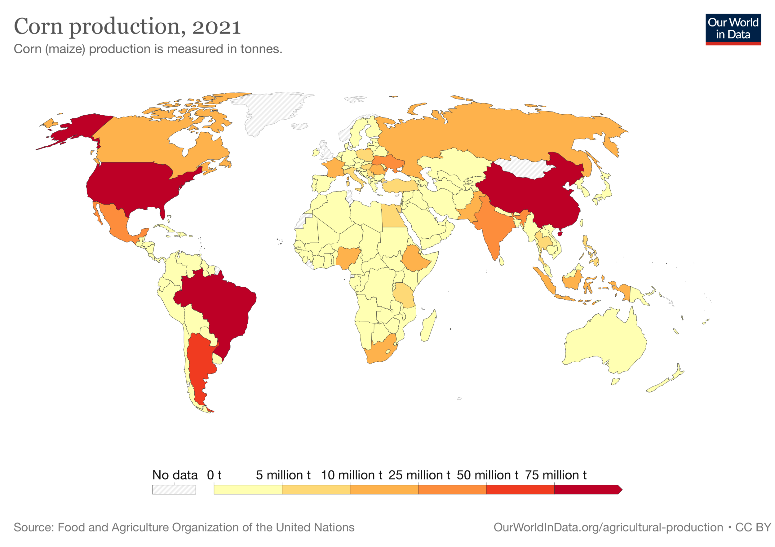

The reason for ethanol in gasoline
Actually, the REAL reason for corn alcohol in gasoline is to support the corn lobby and not much else and it's a proven fact, many times over that it takes more energy to distill a gallon of corn alcohol than the gallon produces in energy.
Without government subsidities no corn alcohol distillers would stay in business.
Get your facts straight...
Do keep in mind I am a farmer but I don't grow e-corn and never will.

I always thought ethanol was added to gas to help with pricing/shortages of oil and our (at one time?) immense ability to produce corn. Or perhaps to help subsidize the corn farmers?
I didn't know it was used or able to raise any octane levels??
Probably showing my ignorance in all of the above.
Ethanol has a very high octane rating. Adding it at low concentrations is like mixing in 115 octane fuel, adding 10% to regular gas increases the octane by 2.5 points. Adding it in higher concentrations depends on the engine it's run in. E85 is roughly 105 octane in a naturally aspirated engine, about 115 octane in a forced aspiration and aftercooled engine, and 130+ octane in a forced-aspiration non-aftercooled engine. Ethanol takes a bunch of heat to vaporize which significantly lowers charge air temps, which is a big component of power production in forced-aspiration setups.
Ethanol was initially introduced to reduce MTBE as an oxygenate to reduce emissions due to the previously-mentioned groundwater contamination with MTBE. The discussion regarding corn subsidies came a bit after that. The fact that it raised octane levels did not appear to be a factor initially as the initial ethanol blend here was 89 octane mid-grade and that was it. This was regular 87 octane with a little under 10% ethanol added. If it was about raising octane they would have added ethanol to all grades right off the bat and you would have seen them add ethanol to 92-93 octane premium to make 94-95 octane super-premium. E85's very high octane rating would have also been widely publicized, instead I have seen an octane rating on exactly one E85 pump ever. Now that we very well know ethanol raises octane, it still isn't a factor. It seems any time there is discussion outside of the racing community (where it has some big fans) about actually using ethanol to boost octane and moving beyond the 1970s post-leaded-gas malaise-era 87 octane standard, you get all of the "it screwed up my chainsaw I hadn't used for four years" or "you are just making evil Monsanto rich", "you are starving kids in Zimbabwe," and the other usual responses. And now we are stuck with DI setups and their significant drawbacks in gasoline engines in order to try to work around running a heavily-turbocharged engine with double-digit compression ratios on the same swill that barely ran engines with maybe an 8:1 compression ratio in the '70s.
