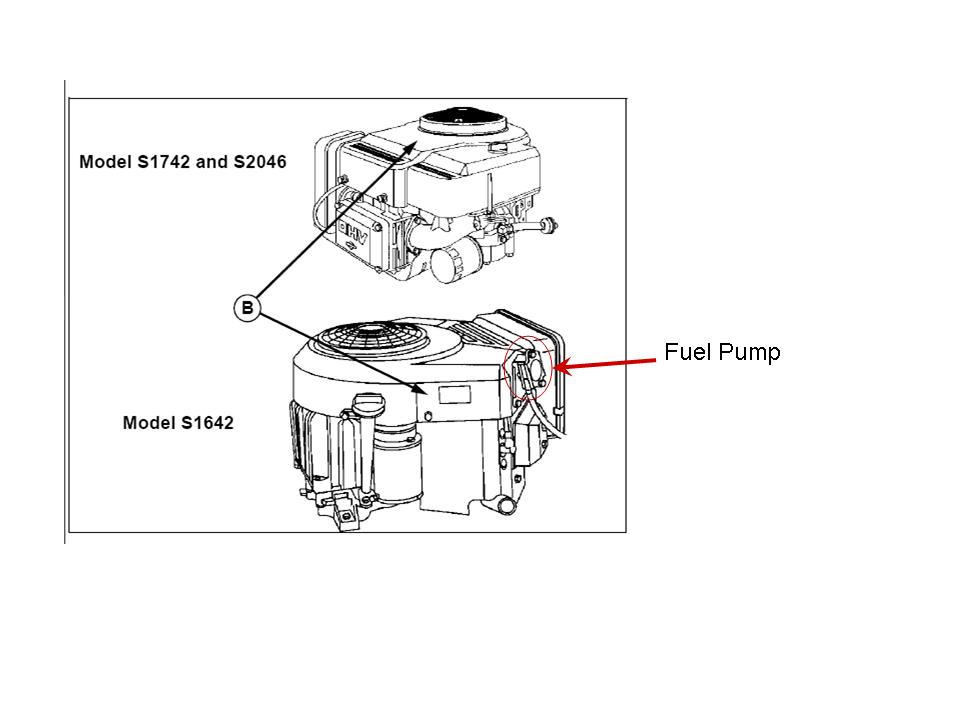

If you see a data plate on the engine with the model number, that would be helpful. The picture I showed is off Kohler's website. If I have the exact model number of your engine, I can try to find more specific info.
What I did find is a description of fuel feed. It said applications with Kohler engines having the fuel tank located above the engine have gravity flow. Those with a fuel tank at or below engine level have a fuel pump. Your pump may be integral to the carb, but I'm pretty darn sure that hose from the valve cover is to provide power to the fuel pump and would be the source of your fuel getting into your engine. I'd check that hose by removing the valve cover end and look for evidence of fuel smell/dripping.
EDIT: I looked at the op manual and it seems your fuel tank is located just in front of the steering column and above the engine. You may not have a fuel pump. However, I found this illustration in the op manual that seems to show a fuel pump on the engine. I think this illustration could be wrong and have the engine models reversed. Perhaps the 1642 engine is at the top.

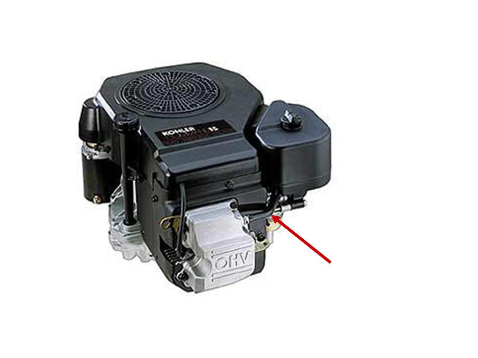

I'm attaching a photo of your correct engine. The arrow is pointing to the breather hose I think might be the problem. Also, you should recheck the carb as you've stated you plan to do.
You can go to this website and enter as a guest. It has your engine and all the detailed parts diagrams you will ever need. You can't order from this site, but you can use it to find part numbers to order. I've already looked at the John Deere version of the CV16 engine this morning. Also, the "S" on the end of your model just means "electric start."

yep that is the one! I forgot what it looked like when it was clean and new.
