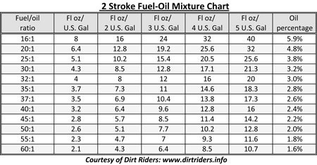

32-1 = 3% oil While 50-1 = 2% oil . One ( 1 ) Percent difference .
