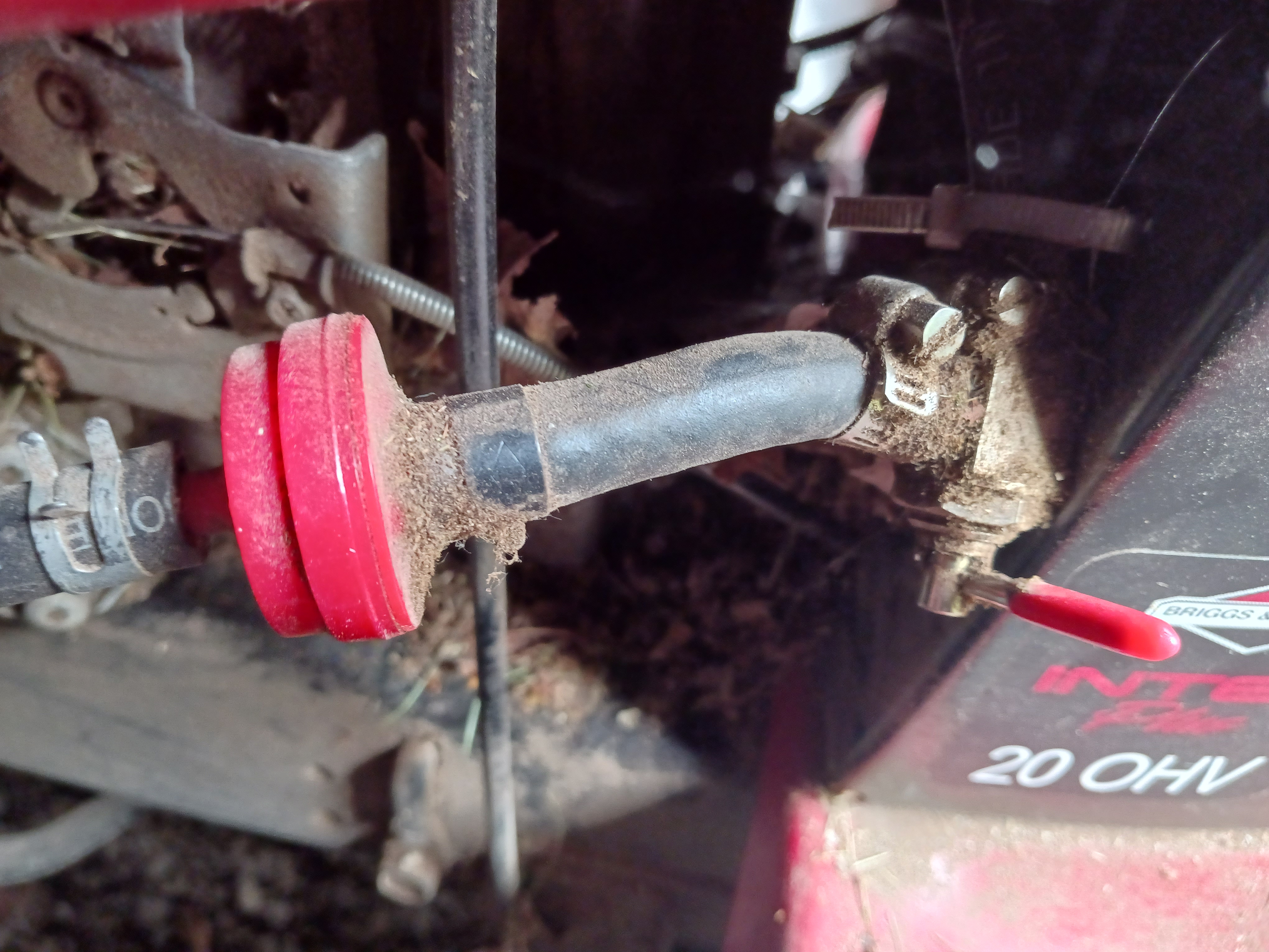

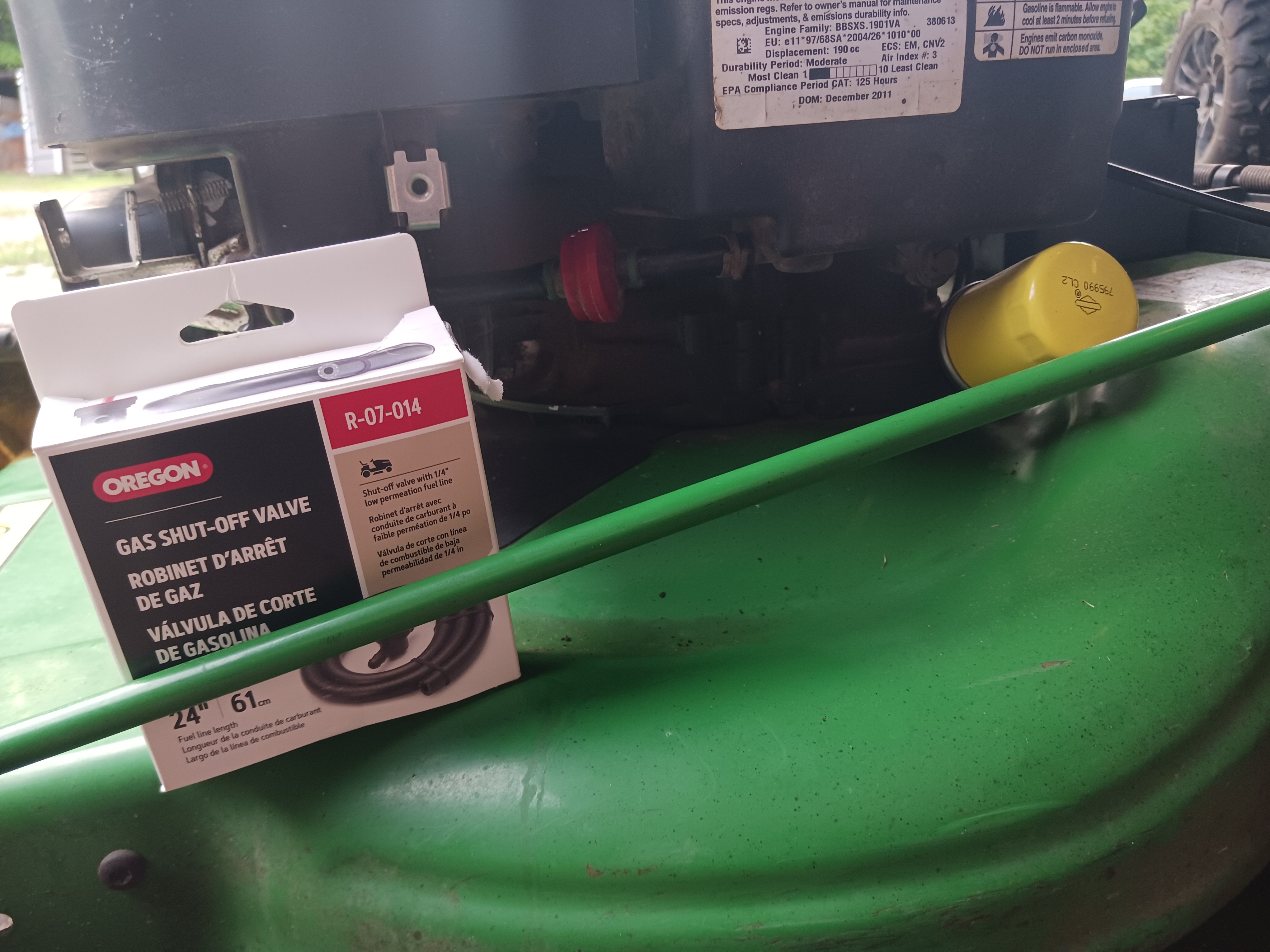

Todays mission, installing gas line shutoff's and filters on every small engine I have.
I buy premium gas that is supposed to NOT be ethanol, I run Marine Stabil in all my gas and still I just had my John Deere push mower and my generator quit mid use and found the carbs to be completely gummed up.
Gas quality is getting to be crap here now.
My small engine mechanic friend just went for his renewal training for his B&S master license and he said they told him gas only has a life of 30 to 60 days now.
From now on I'm going to run carbs dry after every use.

I've installed those shut-off valves on my older lawn mowers. My newest is a Honda and it came from the factory with a shut-off valve installed in the fuel line. If any of my small engines are going to sit for any length of time I turn off the valve and let the engine run until it runs out of fuel. Carburetors last forever if you do that.

Running it dry = can’t be done. Shut valve and engine will die before bowl is truly dry leaving product to evaporate and leave “lacquer” that eventually flakes off and gets under needle and looks like grit. It can also get past the needle and plug passages. Empty bowl is an environment for repeated condensation development.
Filling and vale open = no air space for condensation in bowl or tank.
With a properly working system as the fuel evaporates from the carburetor via the vent the float will allow it to refill eliminating lacquer and moisture.
Especially would not run a 2-stoke out of fuel because the leaning out of the fuel air as it dies is about the worst thing you do to a 2-stoke GAS engine that is when you burn holes in pistons. Note that it’s not good for 2-stroke Diesel engines either because shutting off the fuel would remove needed lubrication from the injector pump and brings a whole bunch of other requirements to get it running again.

Same. But after my monthly gen test or an actual use, i shut gas off, let carb run dry.
