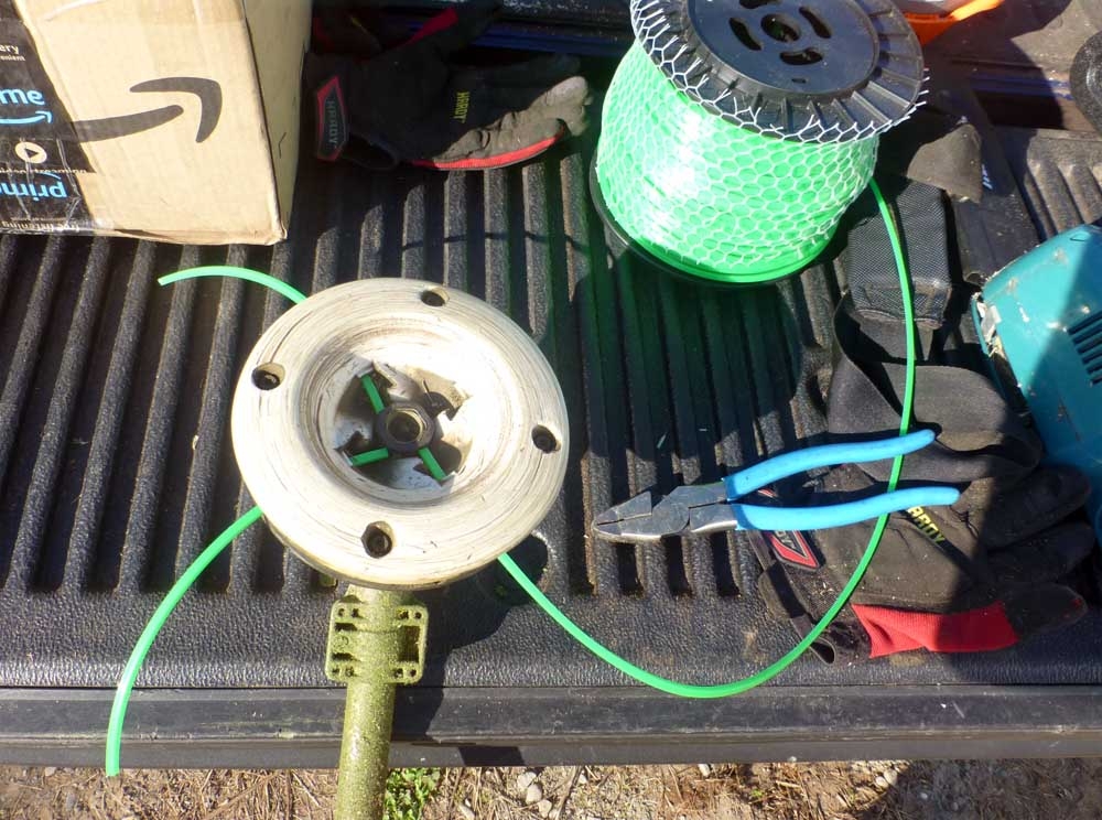

We operate saws and strings off the same gas power heads. Strings take the most HP by far. Of course we only use serious string diameters.
   / Gas string trimmer aka weed eater recommendations wanted #77
.105 string? My earlier curved shaft cheap wackers would see that and self destruct before I could even use it lol.
   / Gas string trimmer aka weed eater recommendations wanted #78
.155 is all we run but have tried 170. We are trying to go bigger.
   / Gas string trimmer aka weed eater recommendations wanted #79
.095 string made my cheap curve shaft whackers destroy themselves.
