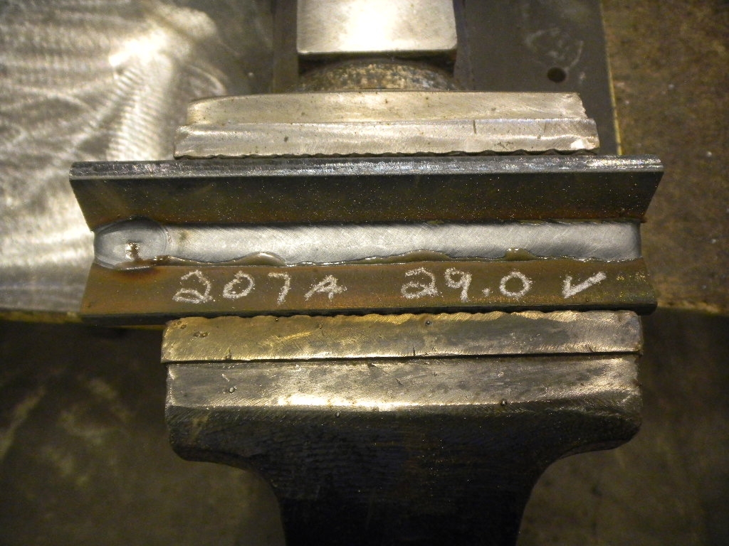

She's fast, and deposits lots of iron. That picture was .045 wire on 1/4 inch flatbar. With .035 wire no problem making a honest 3/8 inch fillet weld traveling very fast.
Here is an .035 Lincoln L-56 wire.
