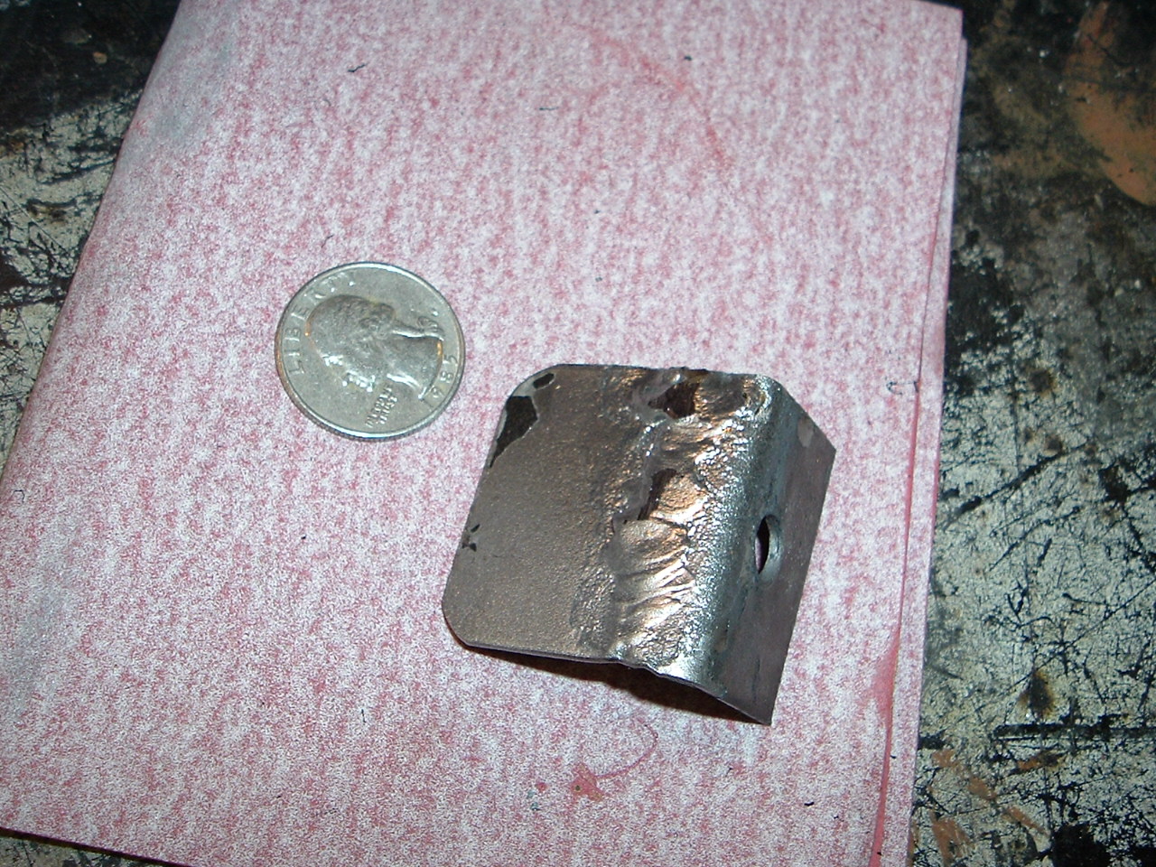

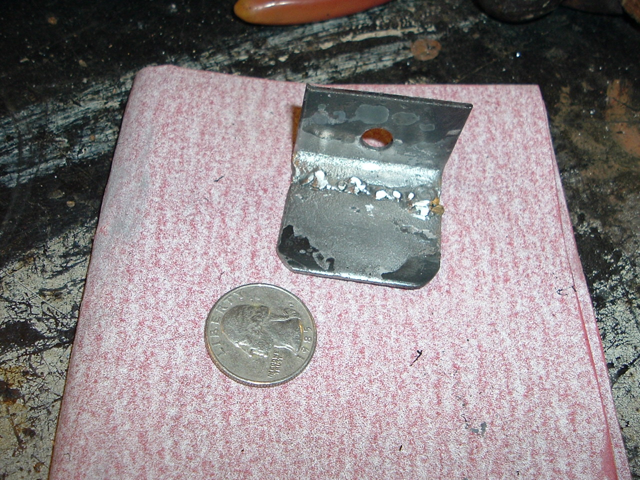

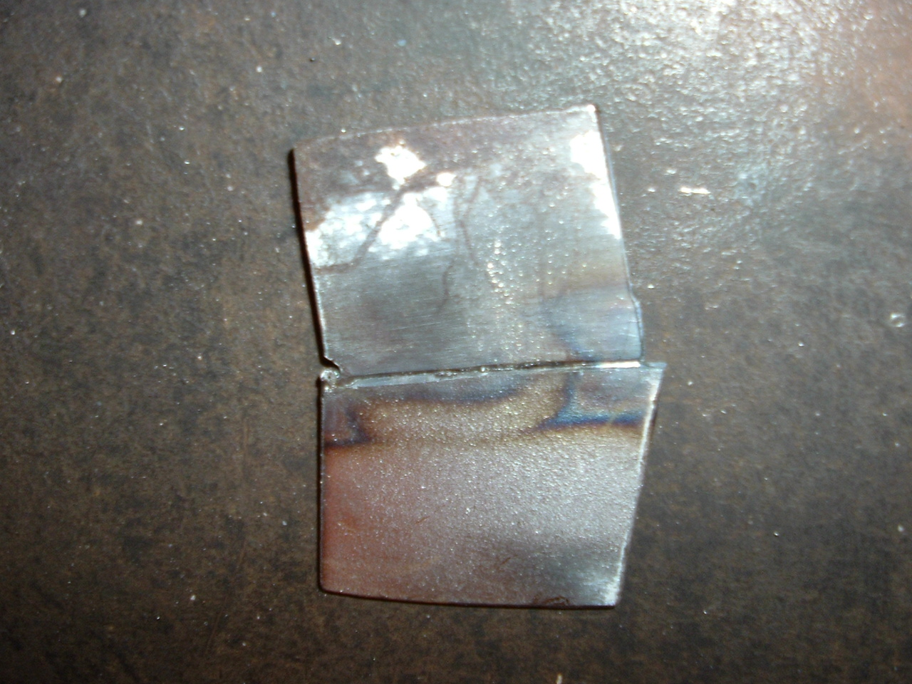

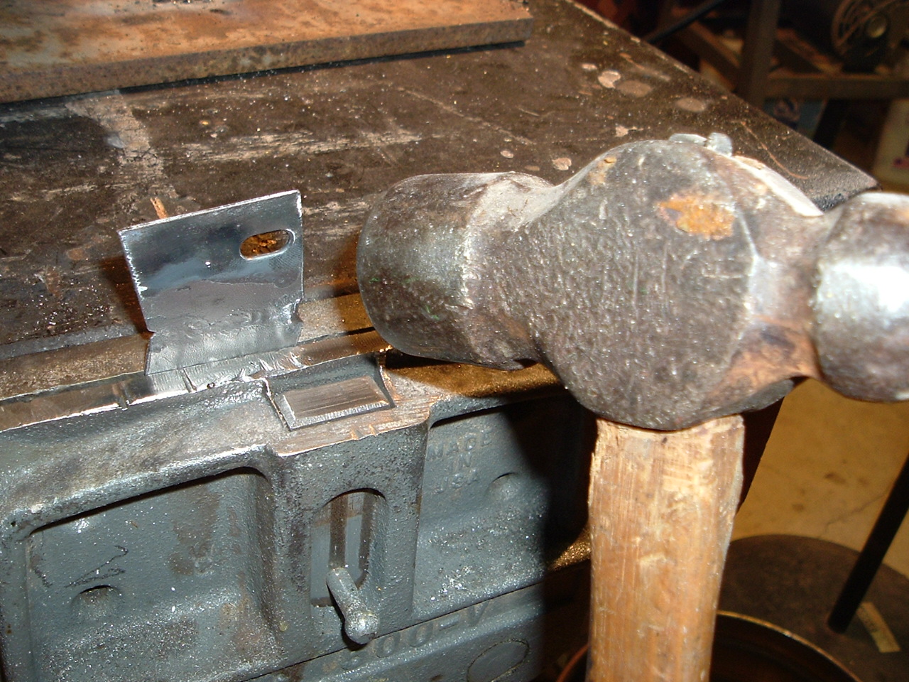

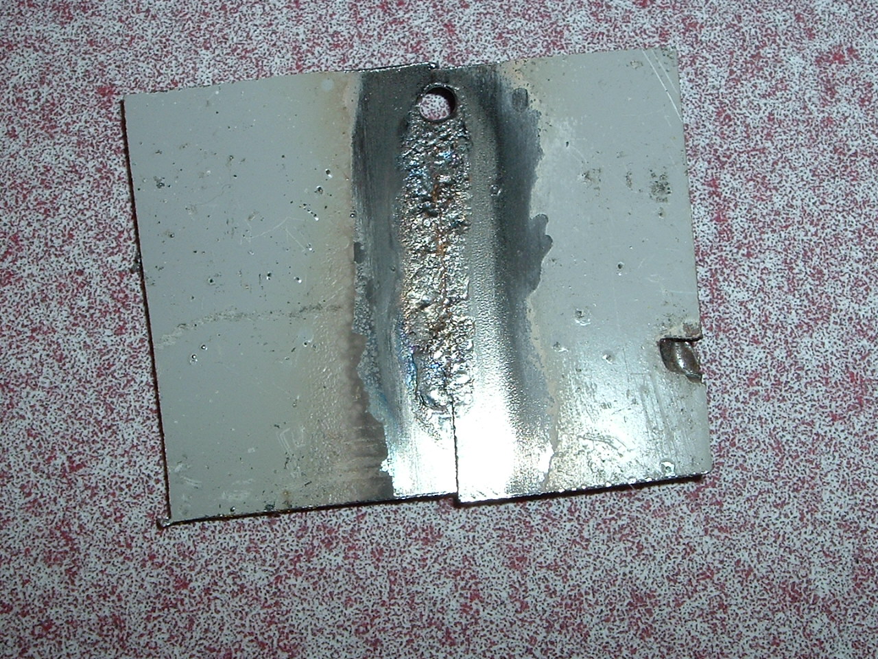

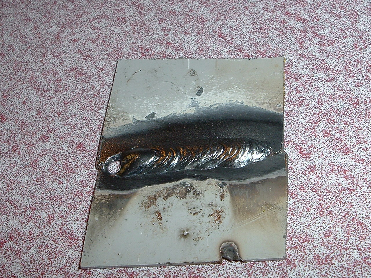

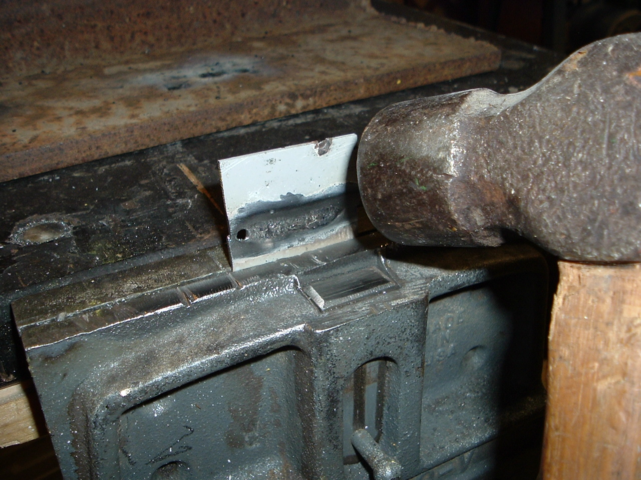

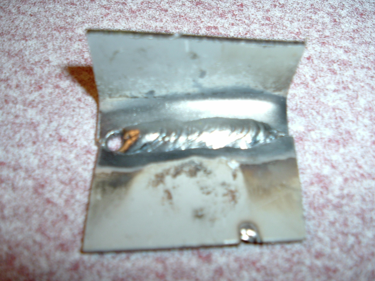

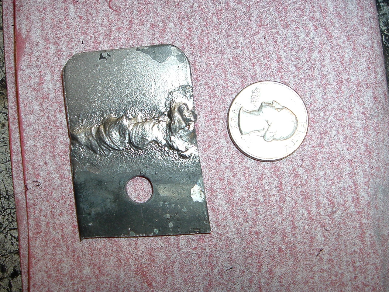

I tried some butt welding practice on a small scrap of rusty steel I cut in two today just for fun.
Welder: Lincoln (Harris) PortaTorch.
Tip : #1
Rod: RG45 1/16
Pressure: about 2 lbs of Ace and Oxy
Metal thickness: about that of a Quarter.

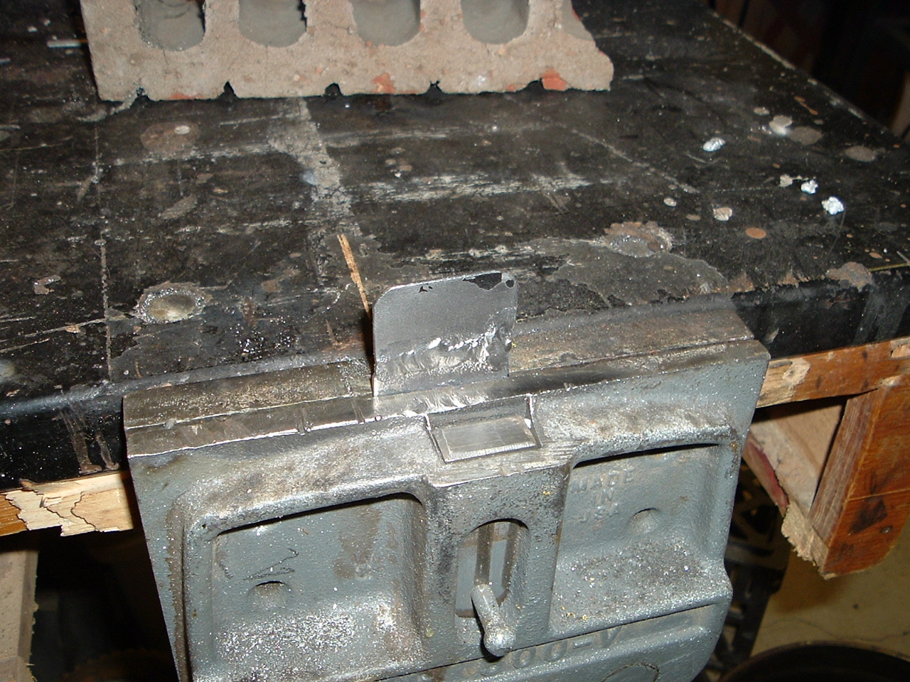

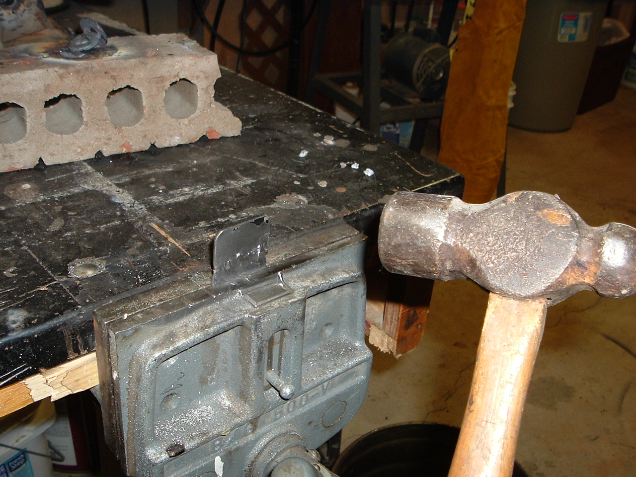

Notice side 2 is more smoothed out. I practiced that technique, of running the puddle with the torch. Hit it with a hammer, and bent the base metal.
I will get better with practice.

What kind of torch are you using? I'd step up to a larger welding rod. It also looks like you have a lot of cold lap going on there. Watch for the keyhole to develop and then add the rod at the rear of the key hole using a slight circular motion, swiping from one side to the other side of the weld to create nice, smooth ripple. Keep the rod on the edge of the flame, just enough to keep the end of the rod wet but not melting. Are you using a forehand approach?
/ Gas Welding Practice #4
Well,you got it stuck together but you failed the test,,,first test is to make it look good,,than you see if it will bend,,,forget about fusing two pieces together for now,,practice just running a bead on a piece of steel and making it look uniform without filler[just get a puddle going and move without melting through,,might need something a little thicker],,than try to do the same with filler,,than when you got it looking decent,,,than put two pieces together.

One of the interesting things I've found out about welding is if you concentrate on making a good weld it will usually turn out a good looking one. You can't say the same thing always about welds made to look good, especially with mig.
I personally recommend learning to weld first using gas. That's because you learn what's happening with the metal. It also reinforces a saying I use, "when you're almost melting it away you're closer to welding than when you're not."
Welding is about the "wet". Forge welding (blacksmithing) is done with the metal wet. So is gas, arc, mig, and tig. It's easiest to see and understand with gas welding.

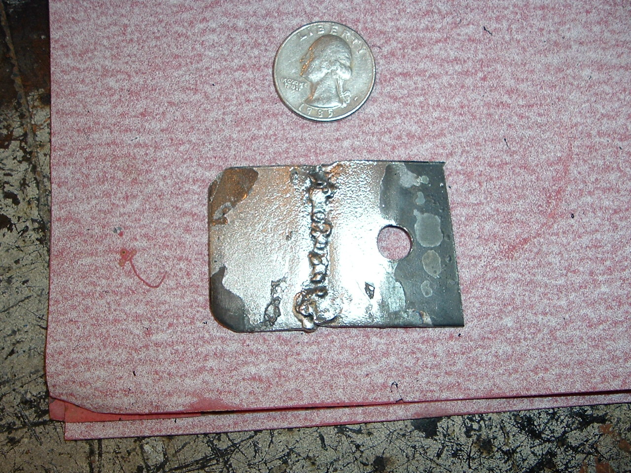

For the stick, did you have the torch stuck in the positive side? It looks a little like straight polarity. What were your amps? What rod? Campbell hausfield should stick to air compressors. Get some real rods whether hobart, lincoln, McKay or even US forge. And get at least 3/32 to weld anything like that. It'll work just fine at about 60-70 amps. A little more for 7018. You should have easily penetrated through that.
Gauthier, the best welder I ever knew and could make anything hold did not have pretty looking welds. But they were strong and he could make and weld anything.(and fix anything too). My first welding instructor, that taught most of the commercial welders in S. GA, taught us, he'd rather have a gorilla weld rather than a nice smooth finished weld that didn't have any penetration. He defined a Gorilla weld as: Ugly as sin, but strong as a gorilla.
Mark it was electrode positive. yes Campbel Hausfeld rods are pretty much junk, I just did that for fun.. I know better, and can make pretty good welds with good rod and correct technique on the stick. It was 39 amps and 1/16 rod. this was pretty thin metal.

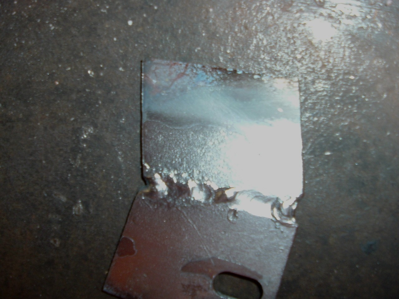

well guess I failed the look good test again.. but sure didn't fail the knock the he** out of it test! the hole at the end was where I stopped, and wanted to fill the "weld crater" oops.. too long, blew a big hole in the little quarter thickness sheet-metal..
Welder: Everlast 160
Rod: US Forge 7018 3/32
Current: 69 amps DCEP
Sheet-metal: thickness of a quarter-dollar coin, No paint removal (we don't need no stinking weld prep). Actually I suppose weld prep is a good thing.. I was just too lazy to do it, and the pieces were very small. So not all that pretty, but strong, and I could have fixed the hole easy, but that would be cheating. Personally I am satisfied that I can make functional welds on pretty thin stuff with some care. and 1/8 or 1/4 inch stuff seems easier to me. I think I can learn to make pretty gas welds, given enough practice and gas:laughing:
