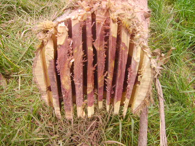

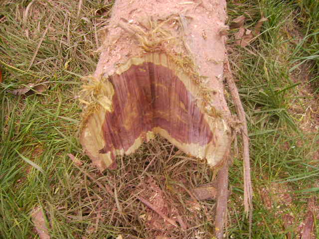

I recently started the fabrication and erection of a new gate entrance at the driveway of my getaway cabin. I am going for a western ranch style look. I cut three cedar logs off the farm where the cabin is located. The vertical logs are about 10 inches in diameter and the horizontal top log is around seven inches.
These two pics show how I cut notches in the top end of the vertical logs with a chainsaw and then cut out the remaining wood to form cradles for the horizontal log to sit in.

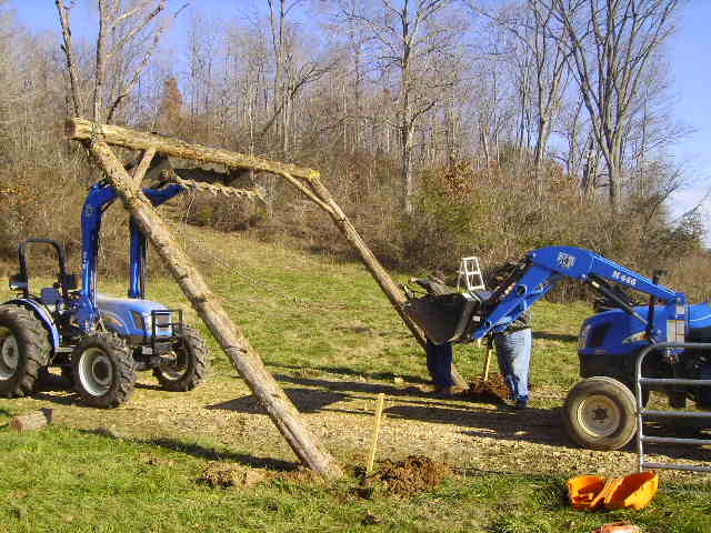

I then started the process of attaching the horizontal top log while the three logs are still on the ground. I would have preferred to put the horizontal log on after the vertical logs were put in the ground, but the my FEL doesn't reach high enough. The vertical logs are 16 feet long, and I would have to have rented some sort of high lift to place the horizontal log so I decided to try to erect it all at one time. Here is a pic of the logs still on the ground during fabrication.
/ Gate Entrance Project Started
After attaching the the logs together, the next step was to "attempt" to raise the completed entrance high enough to get the vertical logs to drop into two previously augered holes. Here is a pic of that attempt. I raised everything as high as my FEL would go, but unfortunately there wasn't enough bucket height to get the poles to drop into the holes. Here is a pic of things as they stood at maximum bucket height.

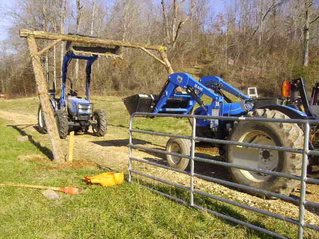

Not to be defeated, I borrowed a neighbor's tractor and chained the two vertical logs to that bucket and backed up verrrrry slowly.
Finally the logs dropped into the holes. Hallelujah! I ran out of daylight and all I could was brace things up for now. I will go back later and put concrete in the holes. I also have a lot of fence work to do as a part of this project. I will make some wooden gates maybe hang a sign and who know where this will eventuall go. I'll update as things progress further.
