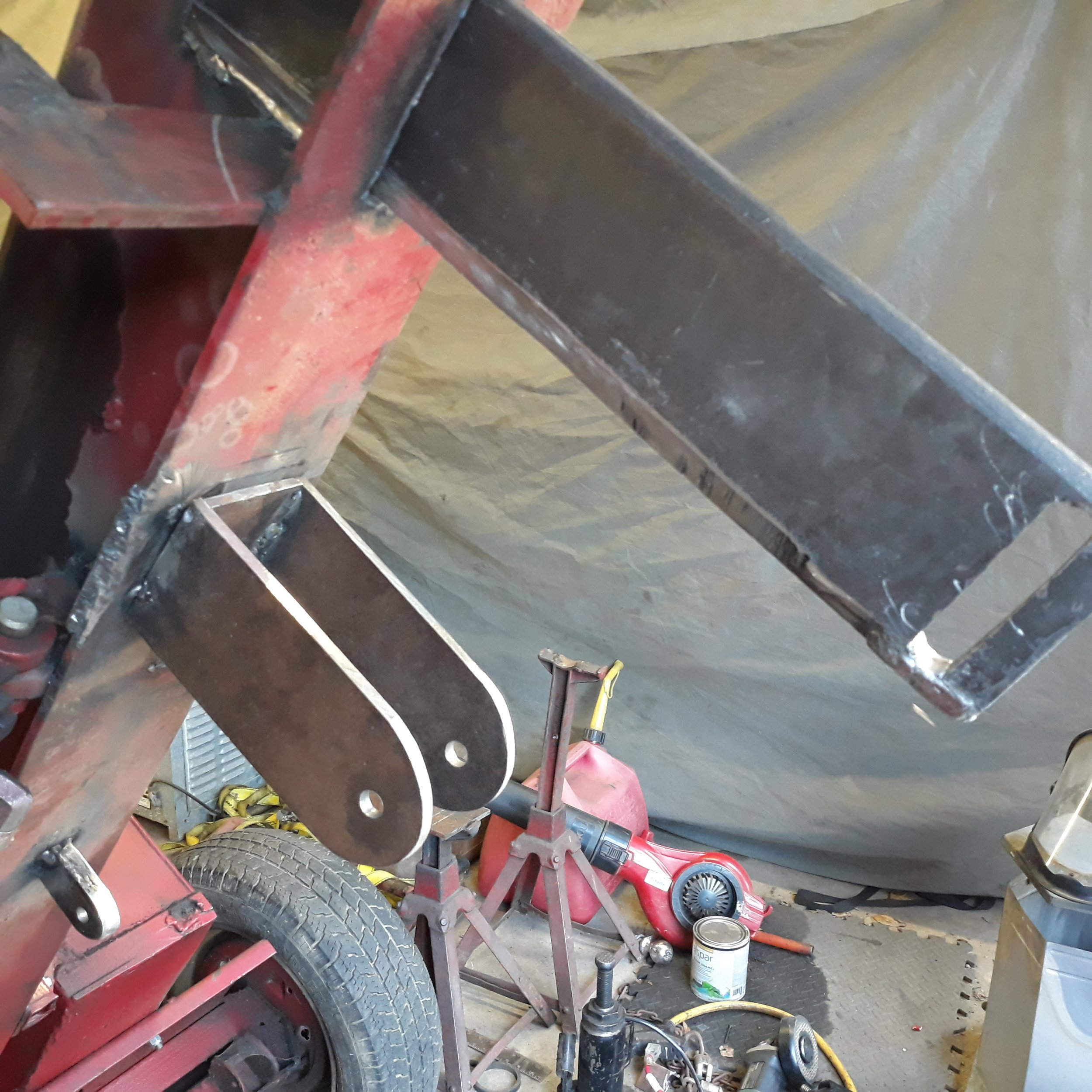

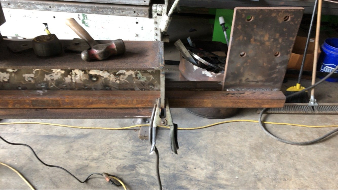

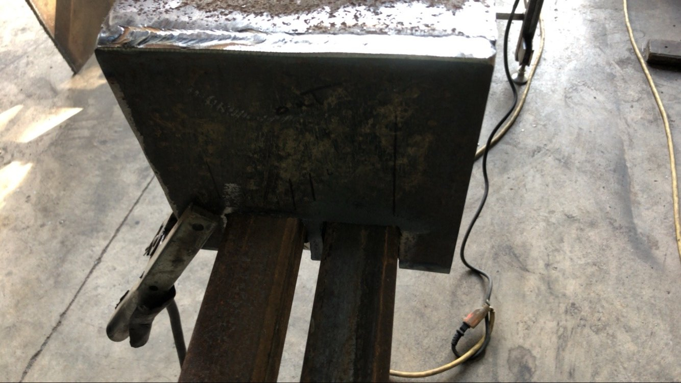

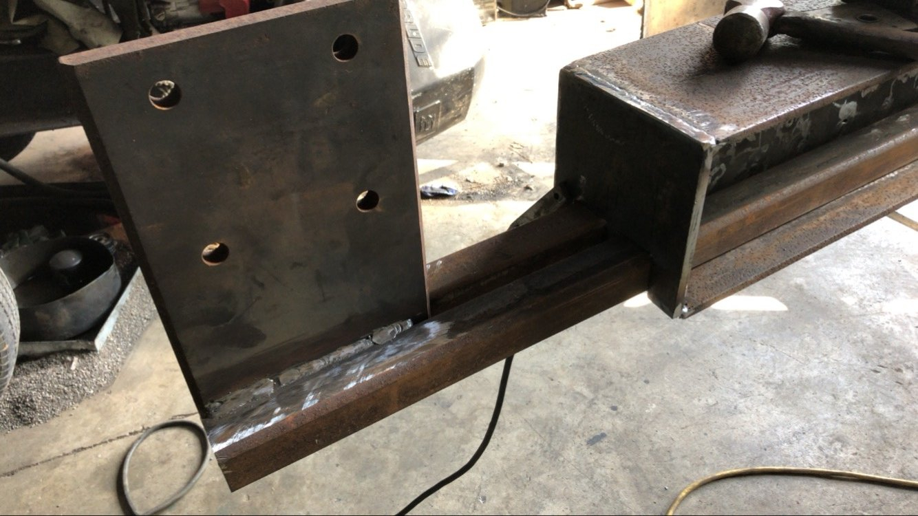

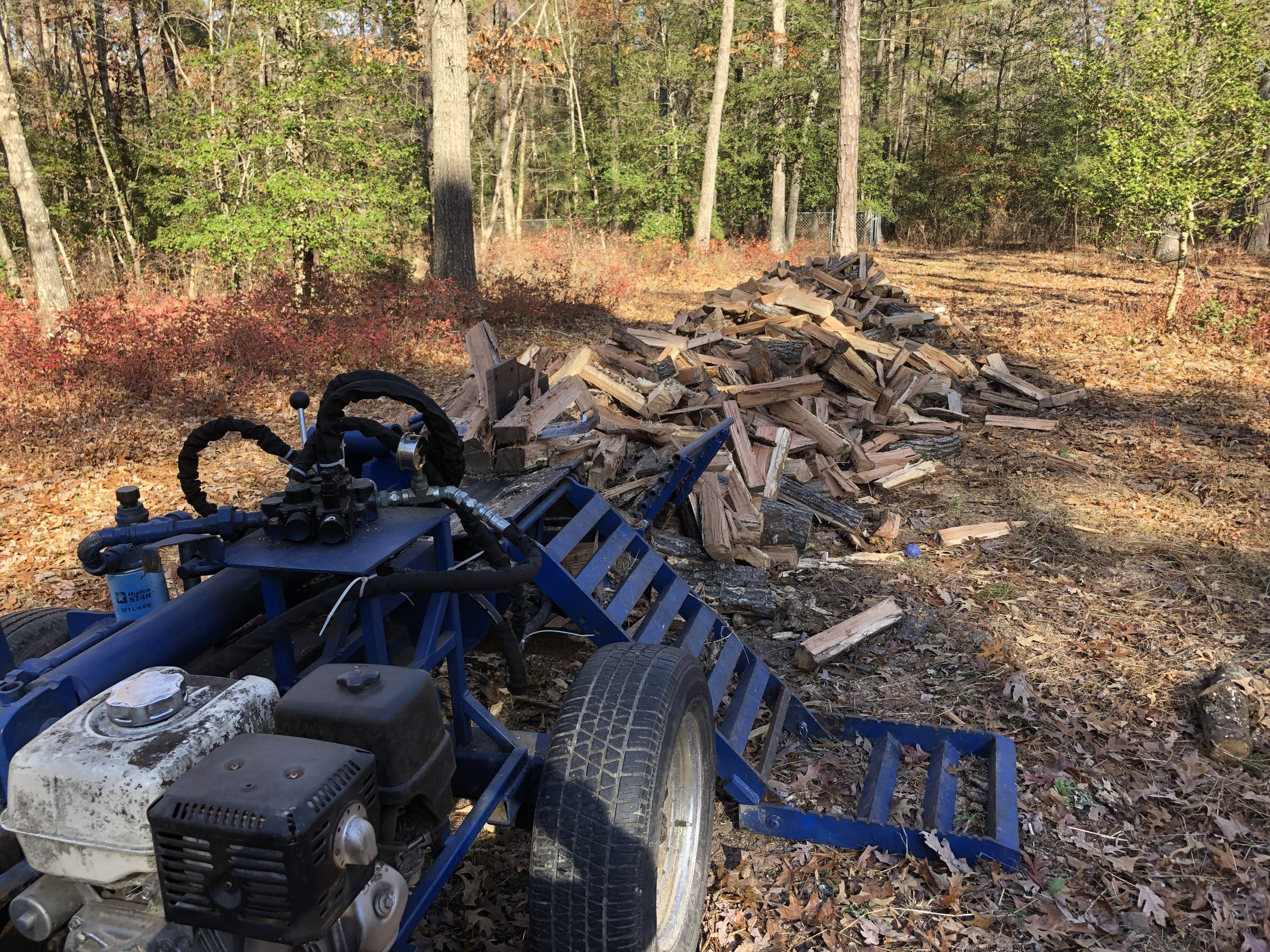

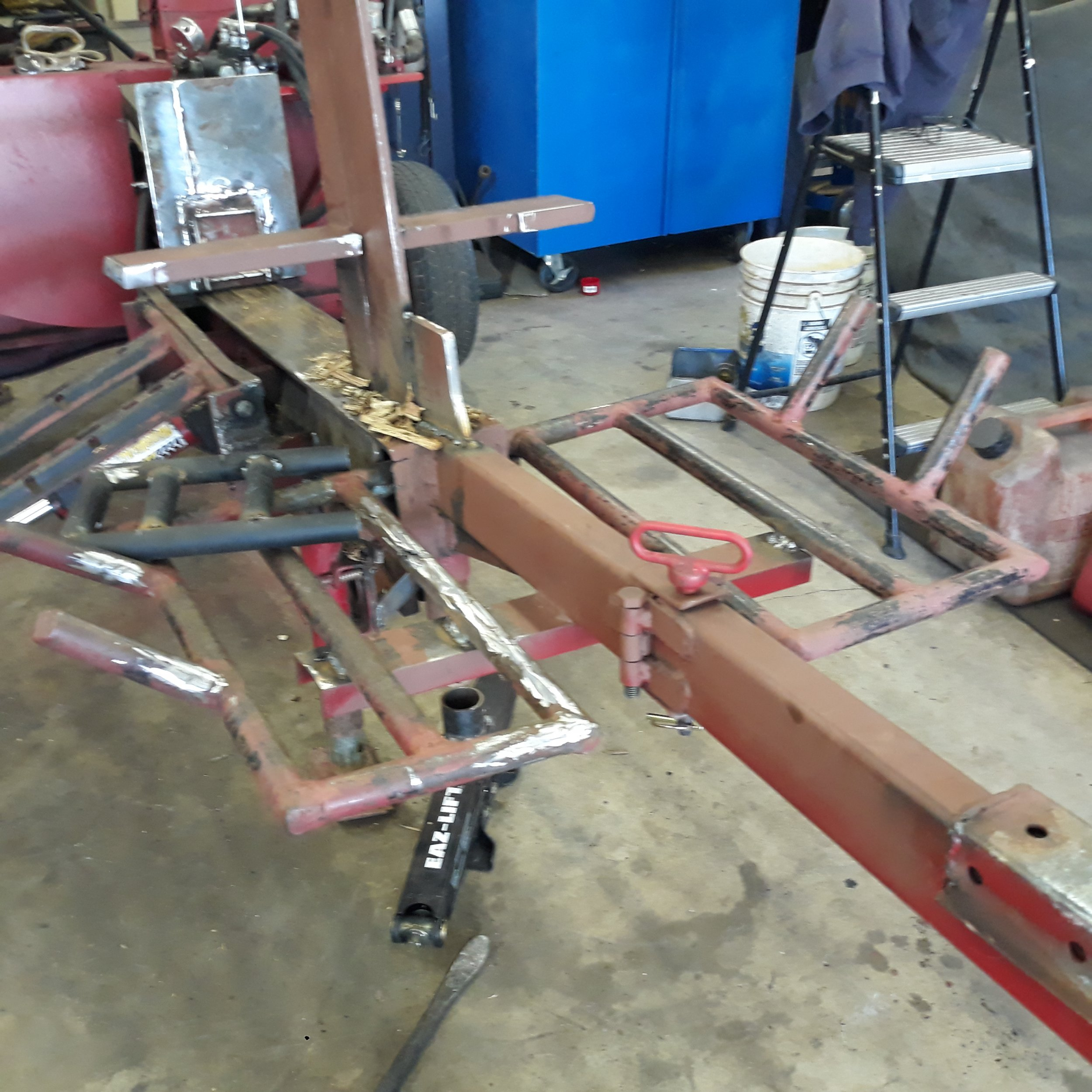

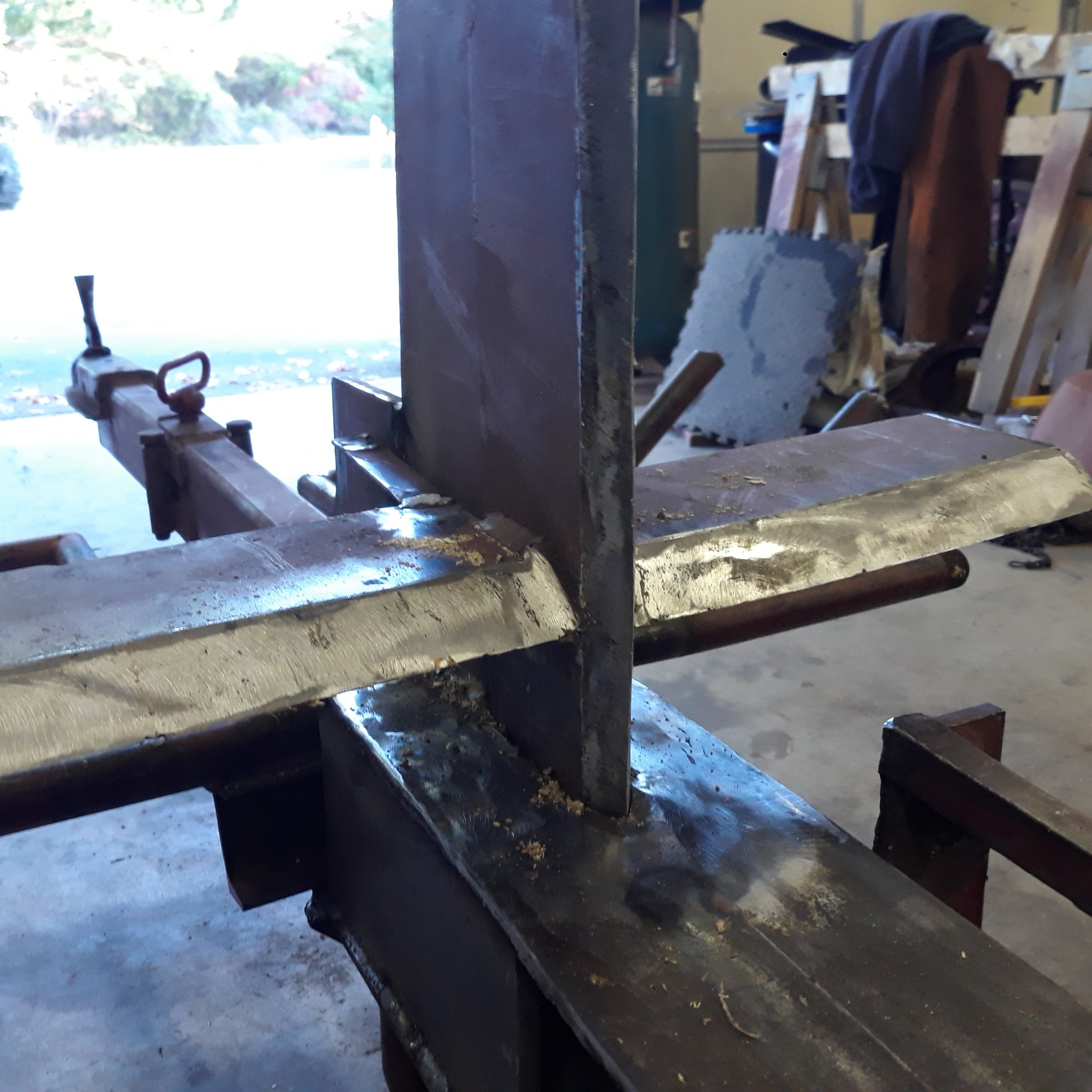

I recently added a hydraulically adjustable 4 way wedge to my home built wood splitter. I bought the splitter many years ago for around $200.00 and over the years I have replaced everything but the I beam, basic chassis, and the oil tank. I added a 13 HP HF engine, high flow pump, auto return valve, and a log loader.
I bought the hydraulics and I have access to the drops at a friend's steel fabrication shop. I think I'm all in for right around $250.00 for this project.

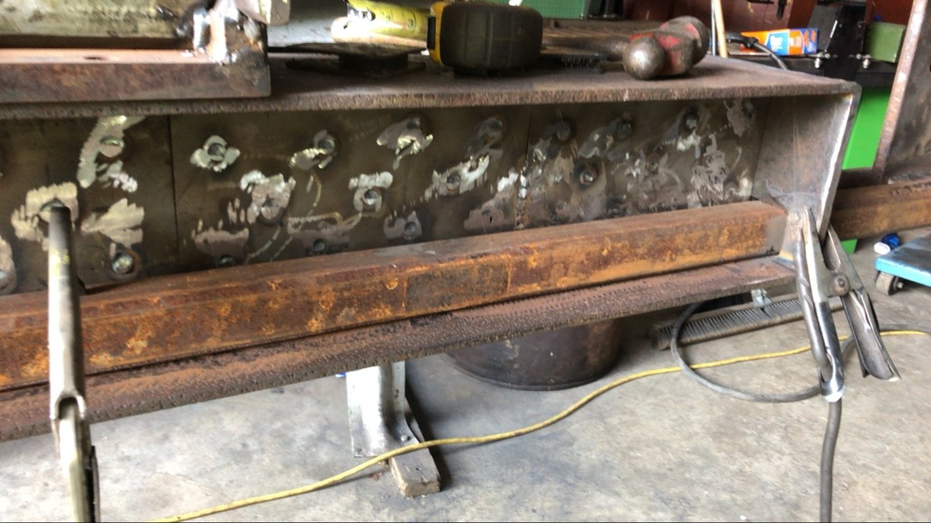

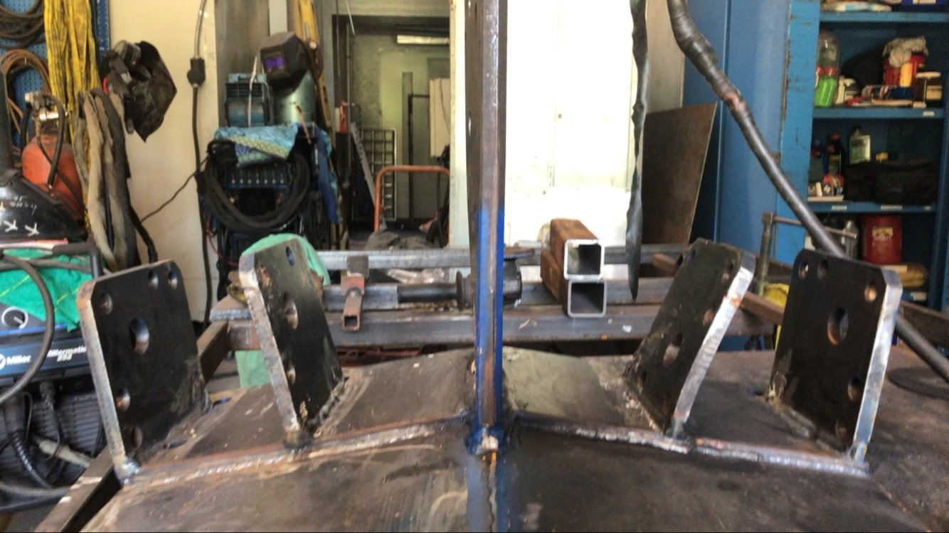

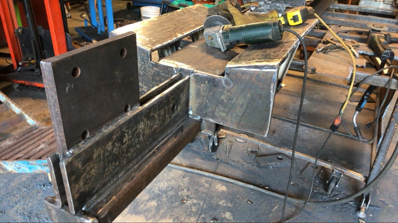

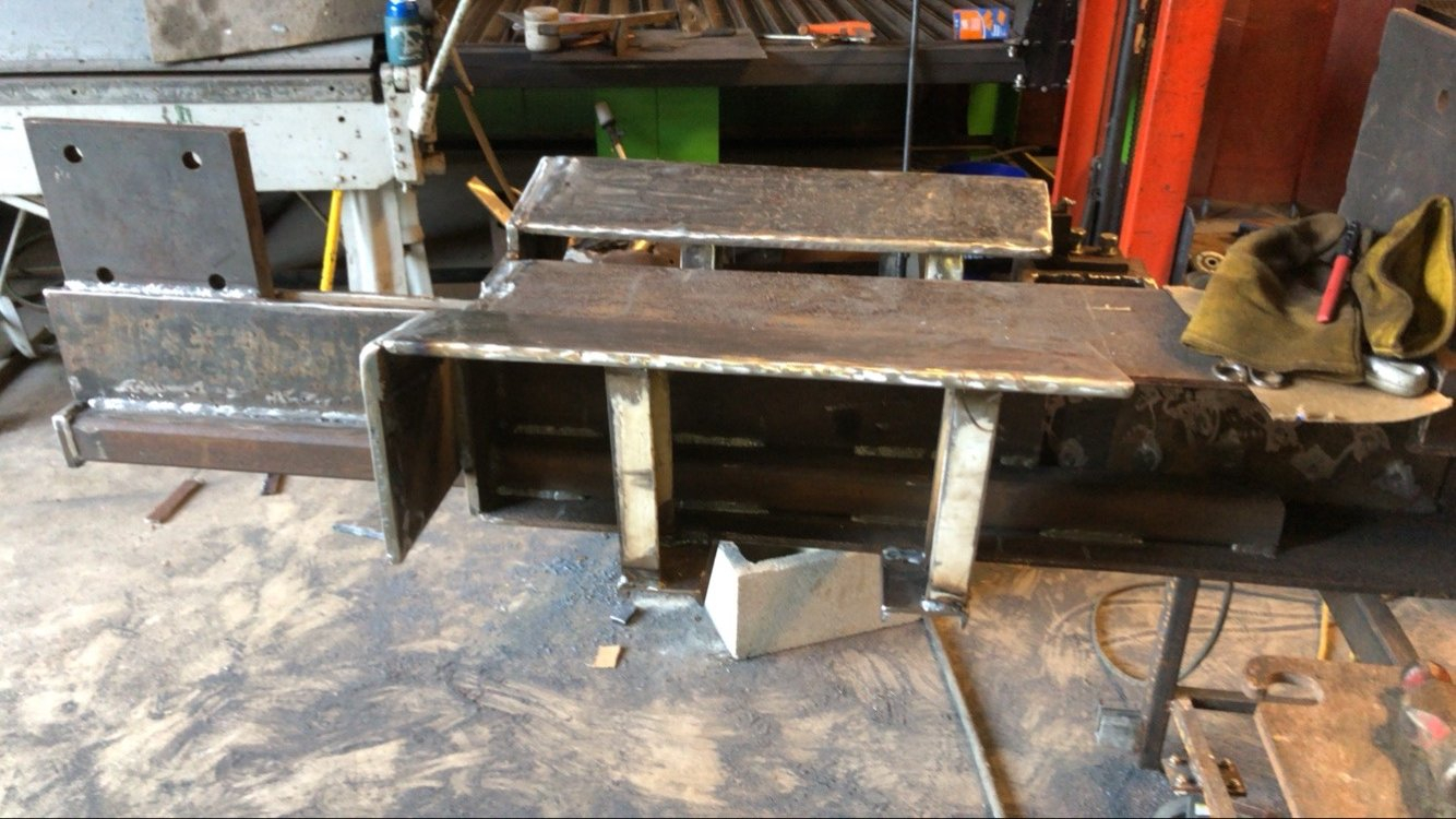

The wedge is 1" plate, the brace behind the wedge is 1/2" plate and the actuator is made from 3/8 plate. I cut the 1/2 and 3/8 using a Milwaukee steel cutting circular saw. The rough vertical cuts on the 1" were made with a torch and cleaned up with a cut off wheel.
I was looking at adding a box wedge, but after doing some research I wasn't sold on it so I decided to add a the adjustable wedge instead. I had three concerns as I researched the idea; what were the measurements for the actuating mechanism?, how could I cut the slot at the bottom of the wedge?, and how could I get a sharpened edge on the wedge?

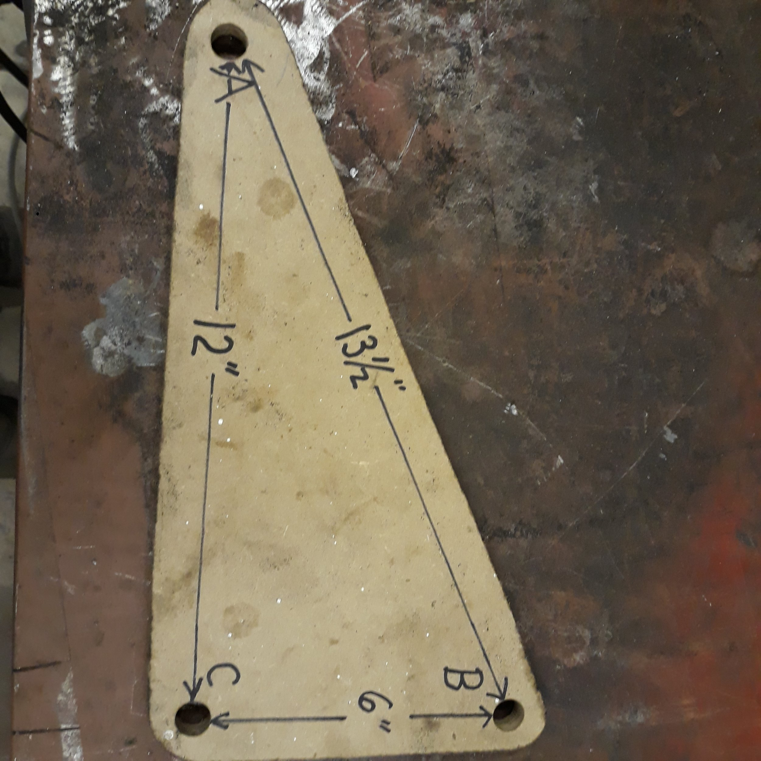

I looked for the measurements on-line without success, although I'm sure they are out there somewhere, so I ended up freezing a video of an adjustable wedge which allowed me to use dividers to measure the one known given dimension of the hydraulic ram. In turn I used that measurement to figure out the distance between the holes on the actuator and with a little math I came up with what I figured would be a good starting point. I then mocked up the actuator using MDF and plywood and much to my surprise the dimensions worked. The dimensions are in the picture below. As the saying goes "Past performance is no guarantee of future success.", but here is what I used.
Point "A" is where the pin goes through the slot at the bottom of the wedge, "B" is where the hydraulic cylinder connects, and "C" is where the actuator connects to the bracket mounted on the bottom of the beam. A to B is 13 1/2", B to C is 6", and A to C is 12" (All dimensions center to center). The bracket is 7 5/8" from the beam bottom to the hole center. The distance from "B" to the mount for the cylinder will vary with each cylinder, but you want the pin in the wedge slot to be about 1 1/2" from the front edge of the slot with the piston fully retracted and the wedge at the full up position. This in turn sets where the bracket gets mounted. The wedge was 5" wide before sharpening and the slot is 3 3/4" wide.
I was able to cut the slot by drilling holes in each end of the slot and than connecting them with a 4 1/2" cut off disc. A little filing and it worked. I initially made the slot 5/8" diameter, but that proved too tight, so I widened it to 3/4".
The wedge 5" x 30"x 1"with a 12" vertical range of motion. The horizontal wedges are mounted 12" above the beam resulting in the ability to cut a 24" log into quarters and was cut from 1" thick stock by a friend who is much better than I ever was or will be at using a torch. I then finished them using a 4 1/2" grinder equipped with 36 grit sanding discs. I filled any deep slots with weld to speed up the process, but it still took several hours of grinding. The vertical wedge is ground to a "V" and the horizontal wedge is a flat bevel to prevent the wood from binding under it. This also allows wood to slide up over it with the wedge in the lowest position.
Overall I'm pleased with they way it came out, but I made a couple of mistakes that needed fixing. The big boo-boo I made was initially cutting the slot in the beam that the wedge rides through too long. This resulted in allowing the wedge to move front to back and put all of the force on the brace behind the wedge which failed from that and the improper weld from using too cold a setting to weld it initially. I ended up cutting a "Dutchman" in the top of the beam and welding it in to close the gap up. I also added plate to the beam bottom positioned against the wedge to hold it in alignment. Once I re-welded the brace properly the wedge does not move under full pressure. My advice is to cut that slot a precisely as you can so the wedge just fits length wise.

Pretty interesting project !! I can see a lot of thinking and time went into that. When you are running it do you find yourself setting it to center often or do you mostly leave it in one position until you have a drastic change in your wood size ?
gg
/ Adding an Adjustable 4 Way Wedge
Thanks; I just finished it up, so the only wood I have split with it is what I used to try it out. But, since we do not buck up our logs until we are ready to split them my guess is that we will not need to re-set the height too frequently since the pieces we feed to it should be of similar size.

Cool...I like that but i'm wondering why you cut out the beam like that and not just add the slide parts to the end of the beam. Oh I just went back and reread your first post. I can see that now because you would have to move the cylinder forward to make it work. It just looks like to me that you would lose a lot of strength that way because of the loss of the beam web right where it matters most. But who cares if it works keep on splitting.
You have to have some beam behind the wedge to support the wedge backing piece and having a longer stretch of beam beyond the wedge let me add a longer brace to the top of the beam. If it were at the beam's end it would be "floating" and would be pushed over by the ram without splitting the wood.
You are correct in that this is the weak point which is why the beam is boxed at this point to reinforce it.

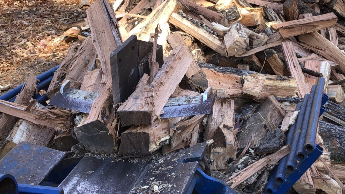

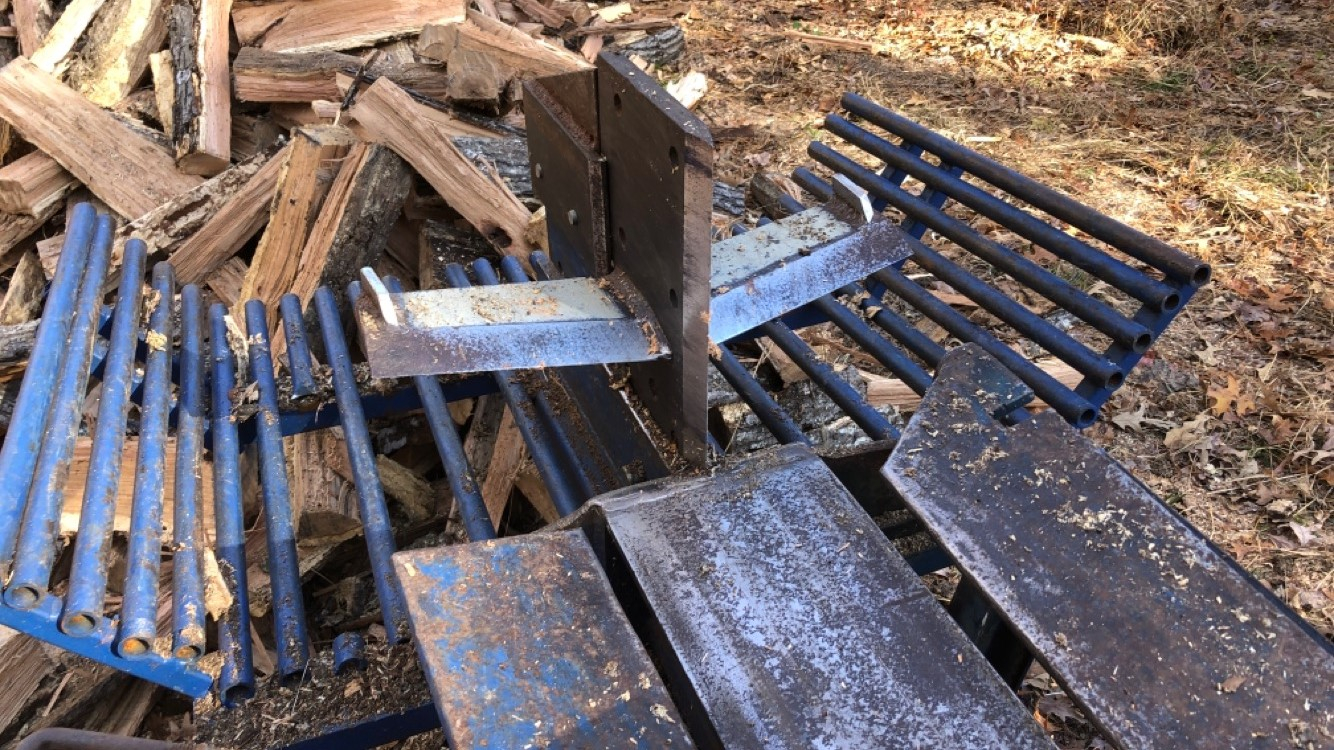

I looked up this post to help out an OP on another post when it occurred to me that I never added a critique of how this worked out after we used it to split wood this past fall.
Combined with the neighbors we split around 15 cords over six or seven days this year which is an average amount for us. If we hustled with four or five of us working along with the L4060 we could do two or more cords a day including bucking up the logs and stacking the split wood into IBC cages. In addition to the splitter improvements I also used a full chisel chain on my MS390 saw to buck the logs which also sped the process up.
Overall we were really pleased with the adjustable wedge as it sped the splitting process up considerably. We did adjust the wedge much more than I anticipated; changing the height for almost every log, but the time spent doing the adjusting was more than made up for by the increased productivity of splitting logs into four pieces instead of two. A 16 inch diameter log would be split with three strokes instead of six with a single wedge for example. I like the split wood to be small so that is one reason for the number of adjustments.
I did not notice an increase in the number of logs the splitter could not split because of the four way wedge and if it balked we would simply lower the wedge and try to split it into two pieces instead. There were still some stump pieces, mostly over 24 inches in diameter, it could not get through without the logs being cut in half vertically. I did notice that there were far fewer logs that flew off of the wedge than before since the four way held them down and seemed to allow the internal stress in the log to be relieved.
The wedge wore the slot I made in the beam a bit which in turn caused the wedge to start leaning to the side and forward a bit. I welded a small strap to the wedge around the upright support behind the wedge which solved that problem.
As I anticipated the wedge adjustment is a bit finicky since it is too fast. Once you get used to it you can slow it down by careful manipulation of the valve, but I think I'll do something this summer to fix the issue by either adding a bigger cylinder or a more restrictive flow restrictor, or both.
Was it worth the time and money? Absolutely! If you are splitting more than a couple of cords a year I highly recommend either buying this as an option on a new splitter or adding it to the splitter you have.
