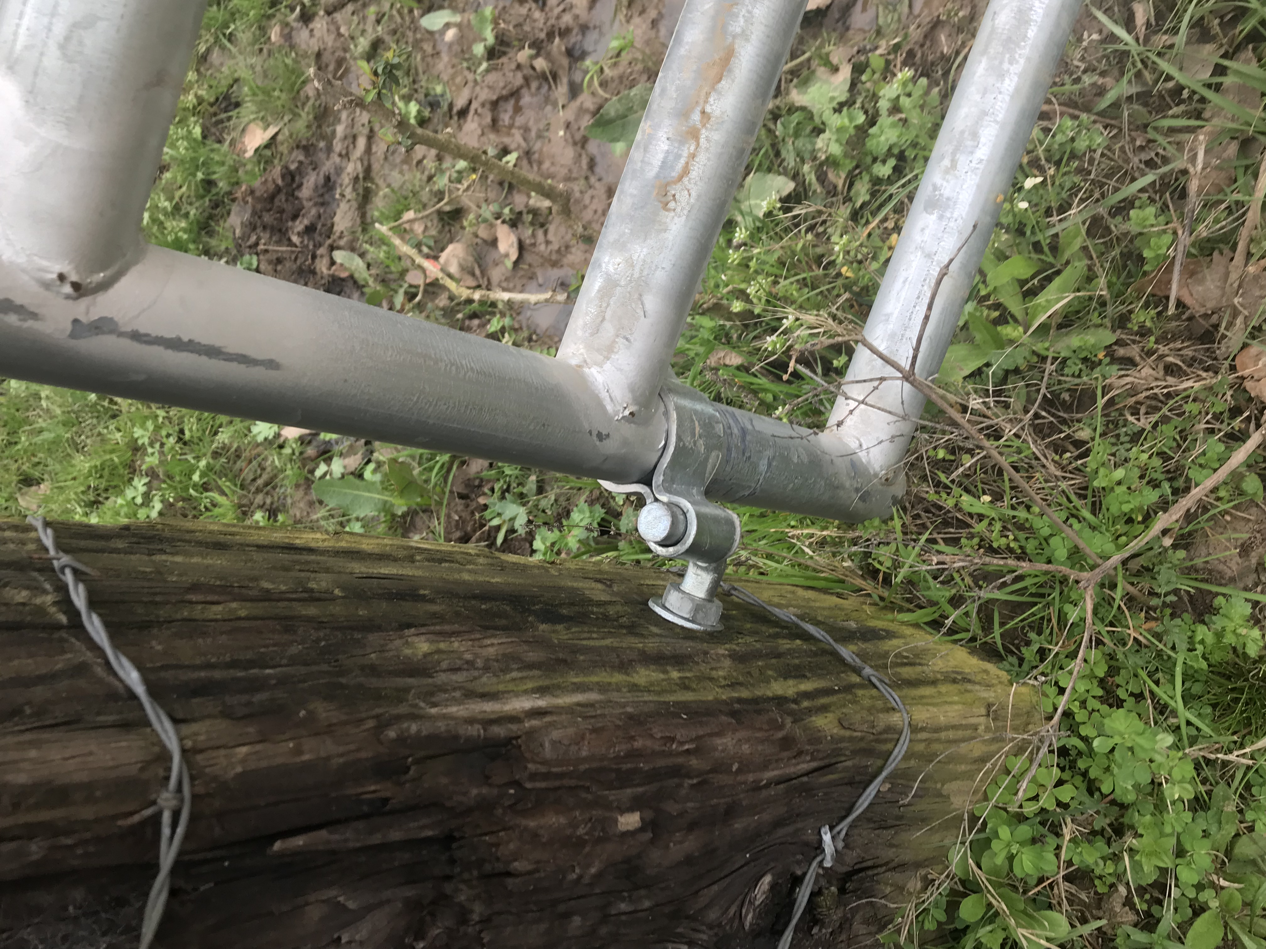

No matter how many times I reset and retighten this bottom hinge it twirls right back around again. Not a newbie to hanging a gate but dadgum this one will not cooperate. If I was a welder I would be inclined to weld the bottom piece. Out of ideas at this point.

Run a self drilling screw in on each side. Problem solved.

Self tapping screws work but then the issue will be the gate frame material will wallow out and you will lose the screw if you’re lucky and or the frame will collapse if you’re not.
I would drill through the hinge bracket and gate frame and install a bolt and nut. Make sure everything is tight, original bolt and clamp, and the new bolt because if you don’t you will have a wallowing out issue.
The best answer is to have a welder change out the 16 gauge gate frame upright for one made with schedule forty pipe.

Is the gate supported on both ends when it’s closed? I’ve found that a block of wood or something underneath the non-hinge side when it’s closed helps relieve the twisting pressure on that bottom hinge over time.

You could place some inner tube type rubber between the gate hinge and the gate pipe and tighten the hinge again onto the rubber.

WoW!! That looks EXACTLY like my gate. Open pipe gate hanging on a greasy old railroad tie. Forget the self tapping screws. Pull that gate out and straighten out the hinge. Drill a hole completely thru the hinge and gate. Install and tighten a bolt and nylock nut or secure the nut with a second nut and Locktite.
Self tapping screws don't have the power to hold. They will loosen, drop out and you will be right back where you are now.

The top pin is turned down. The issue is with the bottom swiveling no matter how much I tightened it.
