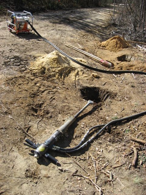

We rented a 60 lb. hydraulic jack hammer with a hydraulic power pack. Here I am using it. This thing worked me to death. I had to dig 4 post holes with this thing. It did the job but it was slow hard work.

However, the jackhammer did just what you said; it didn't break the rock up in chunks, it pounded it into sand. Then I dug the sand out with the hand post hole digger. Then I jacked hammered some more. It took a few hours to dig 4 holes.
Obed

Here's a picture of the jackhammer and gasoline powered hydraulic pack. I had asked the rental place if I could hook the jackhammer up to the hydraulics on my tractor and they said no. However, after picking up the equipment, I think the jackhammer might have run off of my tractor. But using the power pack was convenient because it freed the tractor up for doing other things.

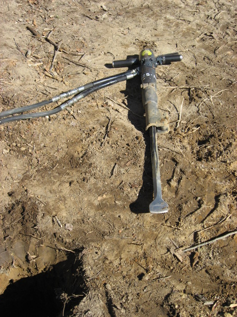

This picture shows the jackhammer bit that worked best. Notice the wide chisel like end. I first tried a pointed bit. The pointed bit just dug small holes straight down. The pointed bit would tend to get stuck in the hole and I'd have to kill myself to get it unstuck. Then I tried a chisel shaped bit that was the same width as the shaft of the bit. This bit worked about the same as the pointed bit. Then I tried the wide chisel shaped bit. This bit was the dullest so I was afraid it wouldn't work very well. However, this bit did the best job; I suppose that's why is was so dull; everyone else used it too.

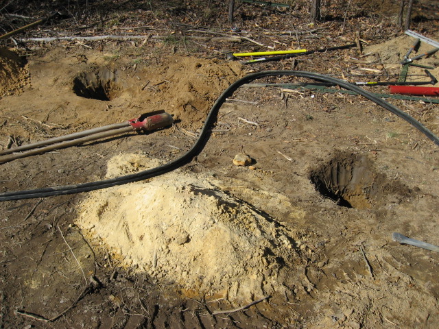

Here's a hole (on the right) after finishing digging through the rock. Look at that big pile of light colored sand. All that sand was hard solid rock. If you look closely you can see a couple small rocks that came out but that was rare. Mostly the sandstone just turned to sand.
This hole will host the gate post. I hit rock at 15 inches and then dug down with the jackhammer for a final depth of just below 3 ft. I made the bottom of the holes a little wider than the tops to help resist frost heave. Making these bell shaped holes with the jackhammer wasn't a hole lot of fun.

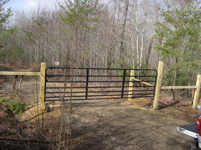

Here's a picture of the 4 holes with the posts set in them and the 16 ft. gate after hanging it. The posts are 6x6 treated wood. Three of the posts are 8 ft long. The gate post is 10 ft. long. Getting this gate hung was a really big accomplishment for me. I've been very concerned about how I would get the post holes deep enough to hang the gate.
I hope there's a better way to dig through this rock. The way I dug the holes worked but it was much harder and slower to do than I imagined. We called several rental stores in three counties to try to rent a rock auger but nobody had one. My wife talked to a professional fence builder in our area. He said he uses a 90 lb. jack hammer to dig his post holes through rock. So maybe our method is the best way to go around here. But I'm still not quite convinced.
Maybe the hammer drill method would work better? I might run into this issue again as I think about building a pole barn sometime down the road.
