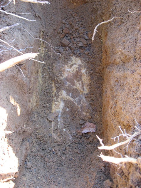

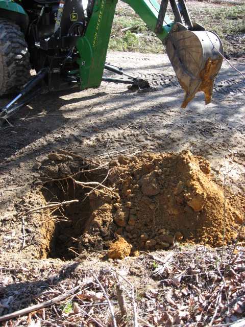

Here's the test hole. The lighter colored part is the sandstone.

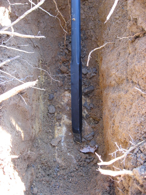

#22
Here is the digging bar I purchased. It is 5 ft long. I found out the 5 ft was not long enough. My dad's bar is 6 1/2 or 7 ft long - but they don't seem to make 'em like that any more.

#23
Here's the hole after about 20 minutes of digging with the digging bar.

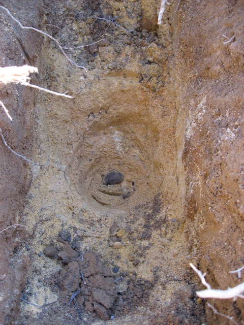

#24
Here you can see the the sandstone remains that I created with the digging bar. My digging turned the sandstone into sand which I removed out of the hole with the posthole diggers. Note the contrast in the the color between the light sandstone and the darker colored dirt.

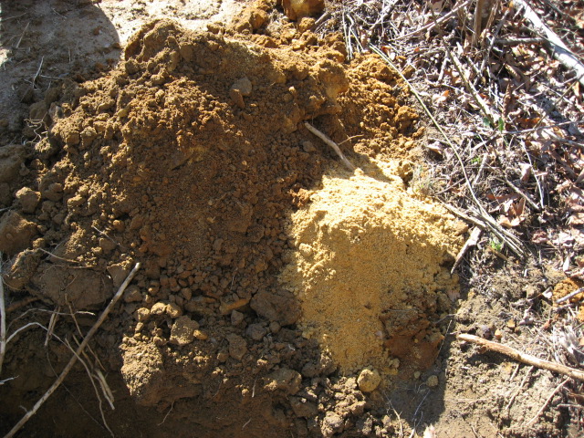

#25
It was a cold day in the upper 20's/lower 30's (F). However, using the digging bar warmed me up real fast. It wasn't long before I was shedding faster than a siberian huskey in Alabama. Check out this pile.

#26
Believe me, digging this pitiful little hole was really tough work. After 20 minutes of solid digging, I only penetrated the hard sandstone about 4 inches deep and 6 inches in diameter. I need to dig almost two feet deep through this rock and 12 inches in diameter. This digging bar isn't going to work. I'll never get my gate put up using this tool.

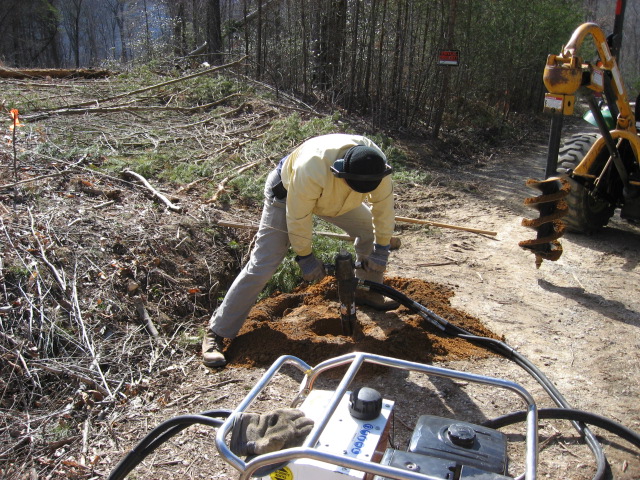

We rented a 60 lb. hydraulic jack hammer with a hydraulic power pack. Here I am using it. This thing worked me to death. I had to dig 4 post holes with this thing. It did the job but it was slow hard work.

You described things just as well as if you had been here. Yes, this was sandstone, not sand. I didn't know if I could get down deep enough with a hammer drill. My holes were between 15 and 21 inches deep when I hit the base sandstone. My goal was to dig the holes 3 ft. deep. Would it be possible dig down 3 ft with a hammer drill?
However, the jackhammer did just what you said; it didn't break the rock up in chunks, it pounded it into sand. Then I dug the sand out with the hand post hole digger. Then I jacked hammered some more. It took a few hours to dig 4 holes.
Obed

Here's a picture of the jackhammer and gasoline powered hydraulic pack. I had asked the rental place if I could hook the jackhammer up to the hydraulics on my tractor and they said no. However, after picking up the equipment, I think the jackhammer might have run off of my tractor. But using the power pack was convenient because it freed the tractor up for doing other things.
