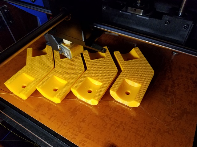

Still printing!
   / Gathering Materials for a Homemade Snow Cab for my John Deere X300
#22
The 45's are done and now I am printing some TEE's. Meanwhile I will be working on the top again and plan on posting some pics in the next week or earlier. As per someones comment about the lights I decided to buy some 'marker' lights.

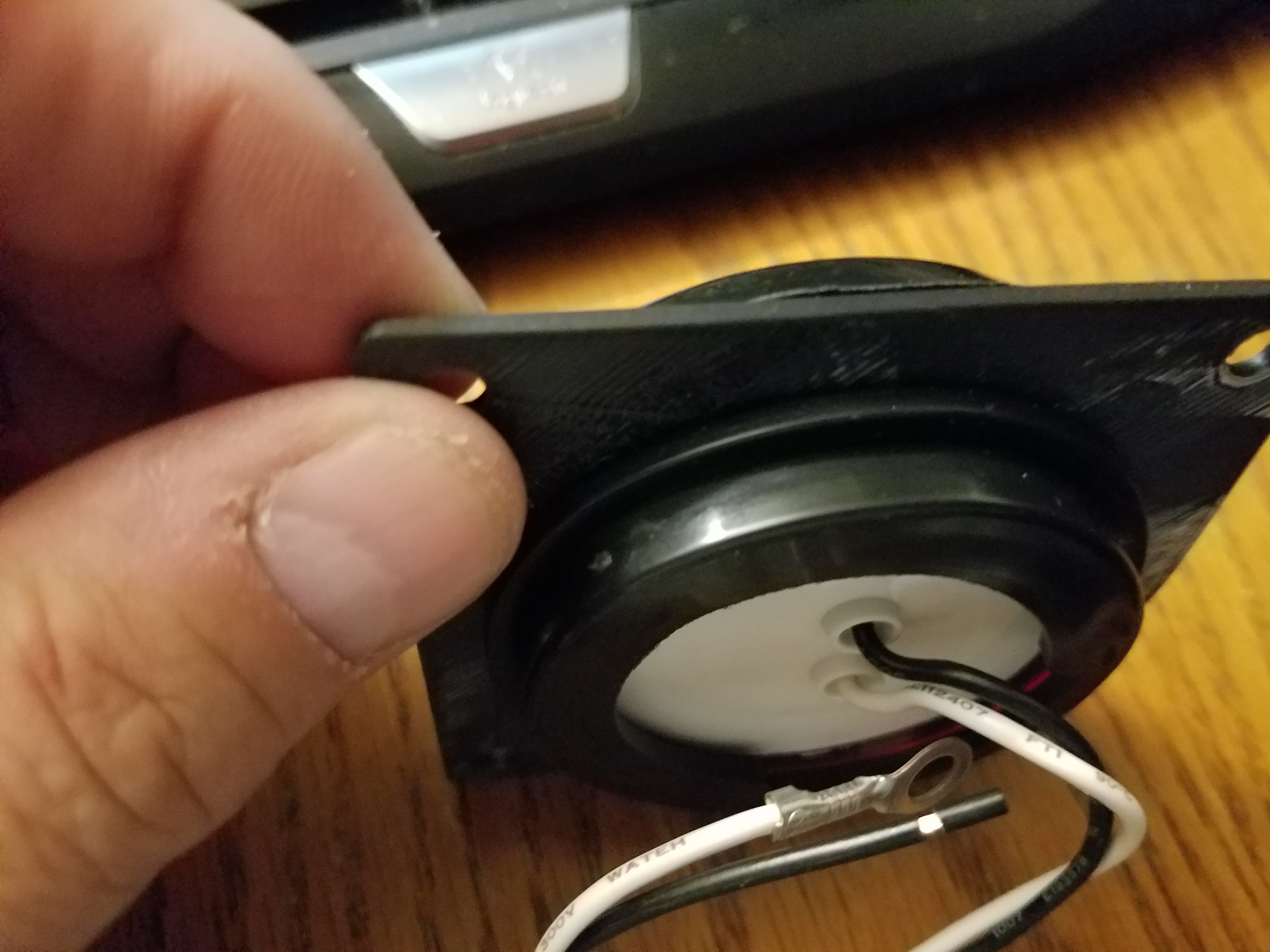

Today I designed some brackets to hold the marker lights: THESE LIGHTS----> Amazon.com: 2 Amber 2 Red LED 2" Round Clearance/Side Marker Light Kits with Light and Grommet Truck Trailer RV Pack of 4: Automotive
I decided to put some 1x4 around the bottom edge of the cab top so I can have a place to mount these marker lights. I will drill a 2.5" round hole where I wish to mount them and then mount these brackets over that hole. It should give a nice clean look. I designed a square bracket and a round bracket. I printed the square one and am now printing a round one. I think i will like the round one better. Here are the two designs:
Once the round one is done then I will add pics of each.
On a side note I have another 3d printer kit I will be putting together at some point. I wish I had it done now as I could get more done on the 3d printing side of things!
#24
After printing both square and round brackets, I will be going with the round ones! It's a much nicer looking and cleaner setup I believe. The following are the two....
