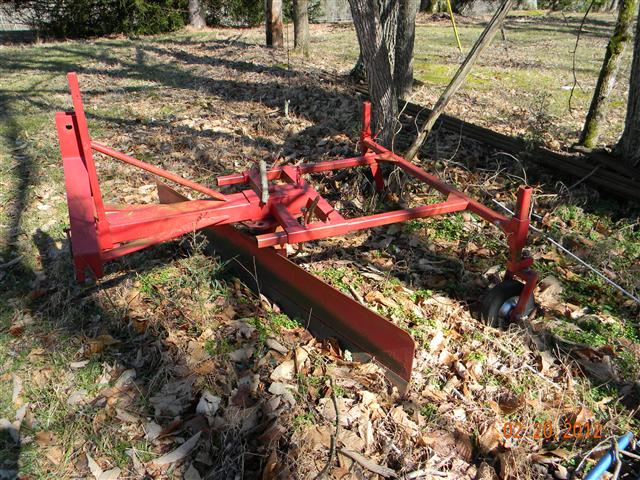

I had been grading the driveway with a box blade for close to 20 years before I had even heard of putting gauge wheels on a rear blade here on TBN. So I already formed habits (good or bad) that I'm probably not even concious of at this point.
I'm posting a picture of my wheel design just in case there's something about my design that makes for less than desired results.
Having the wheels spread apart requries that I be able to set the wheels back from the blade in order for it to fully pivot. That's different from your design where the wheels are more centered. Having the wheels set far apart on mine also makes it more difficult to do ditch work without removing the whole assembly.
I will also say I don't care for the wheels I used. They were cheap and what I could find at the time. Sometimes I suspect that a larger diameter wheel would be an improvement in ability to grade smoothly. I also think that a slanted mount instead of a vertical mount would help the wheels track more evenly.
Any other observations from others are welcome as they might help someone else who is considering building some kind of gauge wheels for themselves.

2manyrocks,
Gee it looks like your blade will pivot 360...almost! I suppose you could lengthen the square tubing that runs back....but probably not worth it. I used 8" cast iron wheels from Amazon of all places: $44 delivered for the pair. I wish I could have found wider ones, but the prices go waaay up for 4" wide wheels. I used 45* (degrees) of caster and it's not too much as far as I can tell. Most designs call for 30* or so, but I wanted them to track and not shimmy all over the place.
I got my rear blade to dress the gutters mostly, but also to run the loose gravel at the edges of the road back towards the center and maintain a crown. It does a pretty good job of those tasks without the wheels. The gauge wheels almost seem like a specialty tool at this point; really only useful after the bulk of the work has been done and then only to get that final grade to be as smooth as possible without the little hills and dips that develop without them.
I'm glad I built them, and I'll use them occasionally. I'm glad that they are easy to store in the up position and can also be removed easily and quickly.
