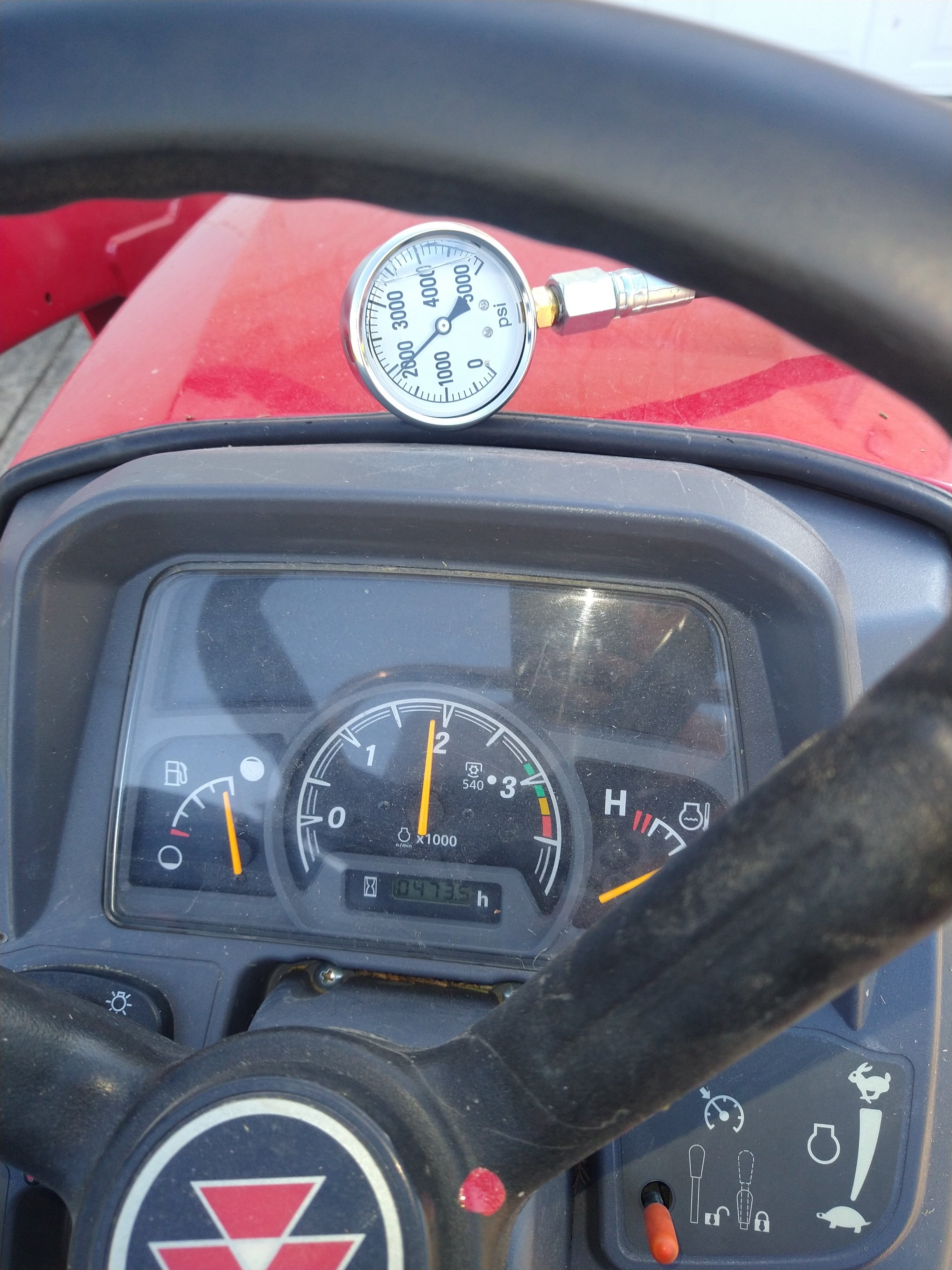

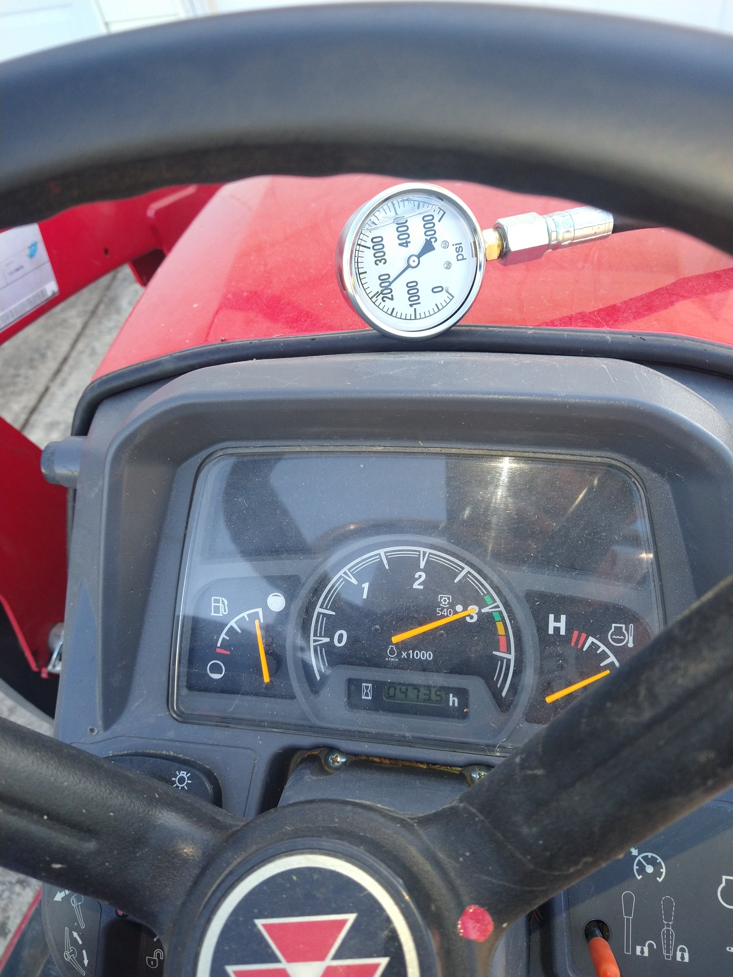

@kennyd of Ken's Bolt on Hooks fame, I believe sells a pressure gauge with the hose and fittings to fit ... That's where I got mine ... It plugs into a loader line ...
Book calls for 1920 psi IIRC ... For my GC 1725 MB.
If you don't have a loader, either Kenny or @dicktill may have a suggestion where to plug into the system ...

Is the 1920 PSI for implement like loader or PTO? I believe PTO operating pressure is much lower like 200 - 300 PSI range but not certain on the GC series.

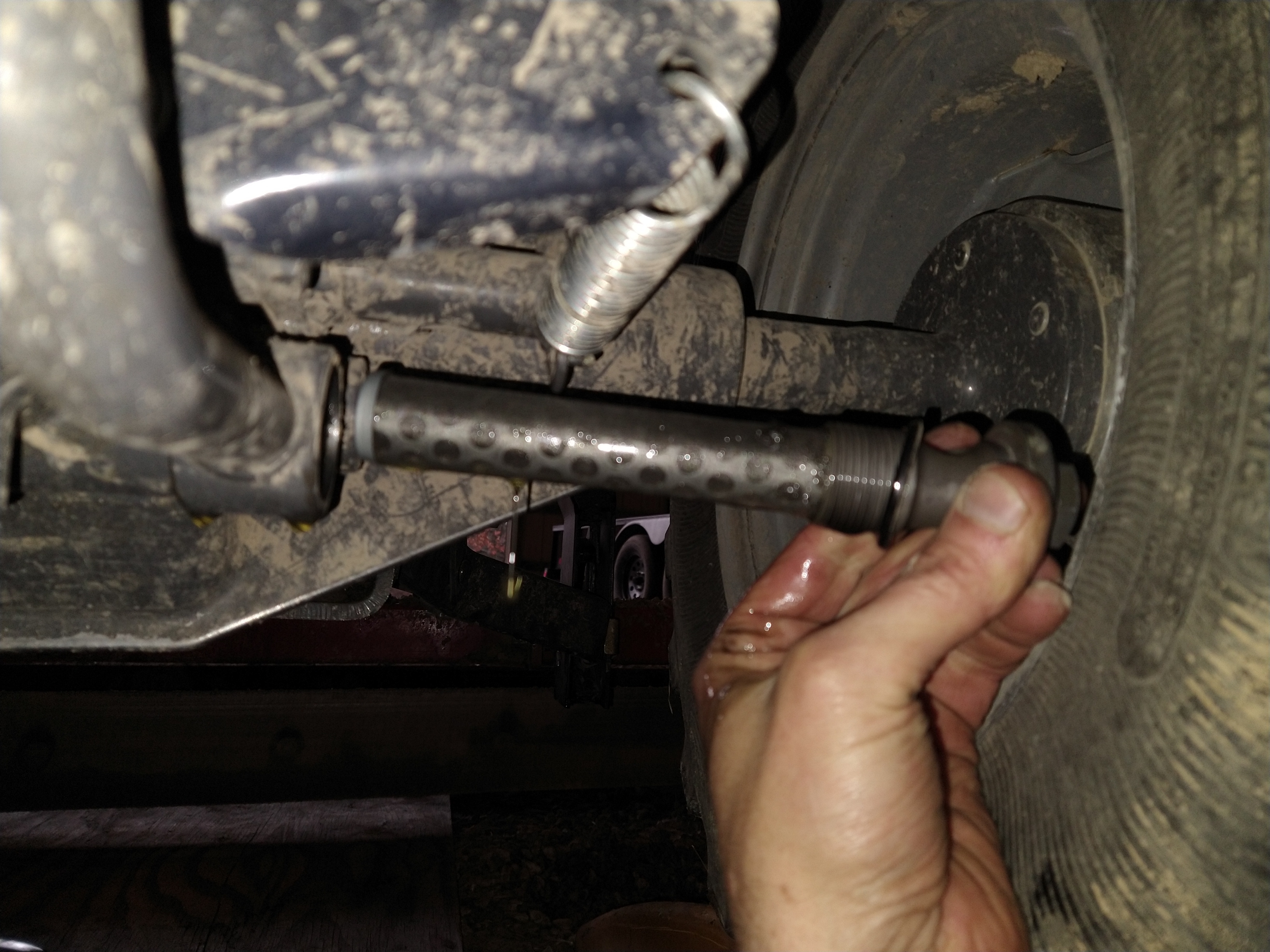

While I'm not a hydraulic's wizard, I'd also check a few more things ... When was the hydraulic fluid last changed? If you did it yourself, did you also clean the screen shown below? (I have 3" wheel spacers, so I don't need to remove the left wheel to get to this ...) does the fluid look clear or milky in the sight glass?

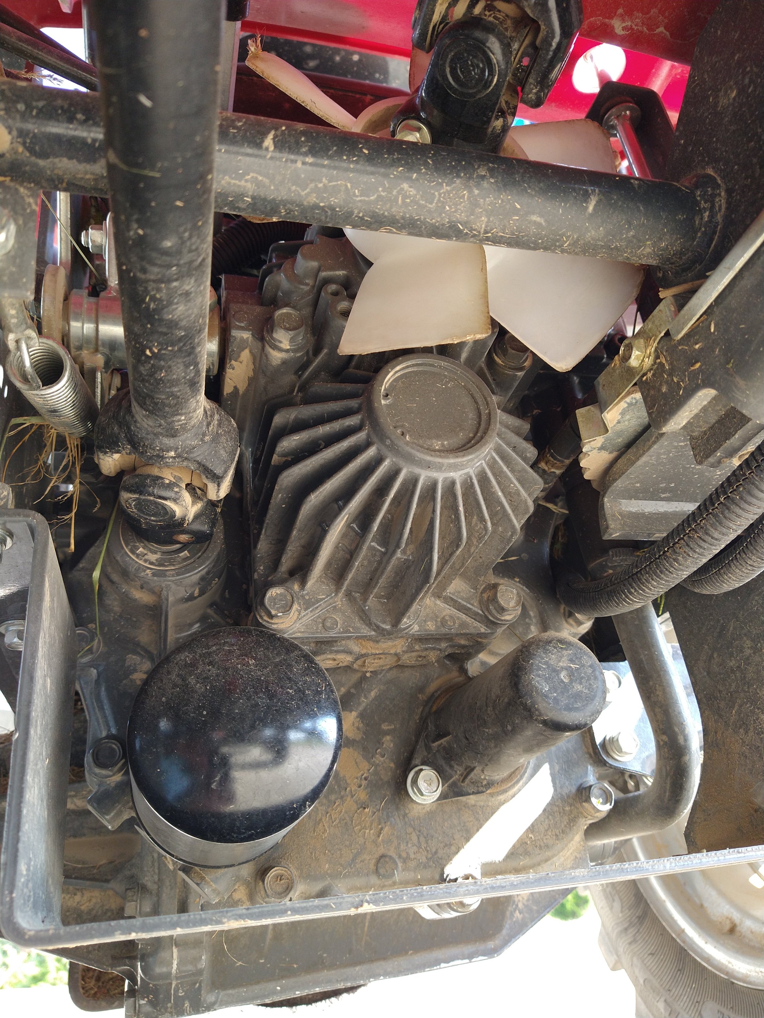

"IF" the fluid is "hot" as in hotter than normal, of course there is no gauge on it, but there is a little fan underneath to assist in cooling ... If you have been running in brush or sticks, it's possible to have broken the fan blades off ... The fan is located on the left side as you are sitting on the tractor, up above the mid PTO shaft outlet on the transmission ...
