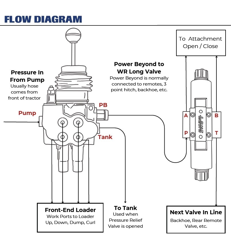

Nice work. I used to draw one-line hydraulic diagrams for work that were more pictorial with valve layouts, labeled ports, hose sizes, etc., used in a production environment where JIC schematics were not necessary but helped speed of assembly. I will find one somewhere and post back. Any chance you could do this 😁
I can try; thx.
I can try; thx.

I am remiss in posting any of the diagrams for my ongoing updates with remotes (a work still in progress). However, basically you have to break into the "power beyond" line (#6) from the loader valve to the backhoe (assuming you have one), otherwise the "power beyond" line (#11) from the loader valve back to the "control valve", to feed the new rear remotes valve(s). All must be in series and the valve(s) need to be open center and have power beyond capability. You also need to add a drain/return line back to the sump (transaxle housing) and this can be tee'd into an existing one.
Good luck and please update us with your progress, Dick

My apologies, I have to access my old .dwg files at work, but I will get you some samples of what I was referring to.
Here is something atypical from a 3rd function kit, would need to know what all the GC valves look like if available.
Wow, that's a tough order; I'm not particularly adept at freehand drawings. I can certainly send you photos of the valves either here or by email if that's what you're asking for. And yes, I can work with *.dxf (or *.igs) files.

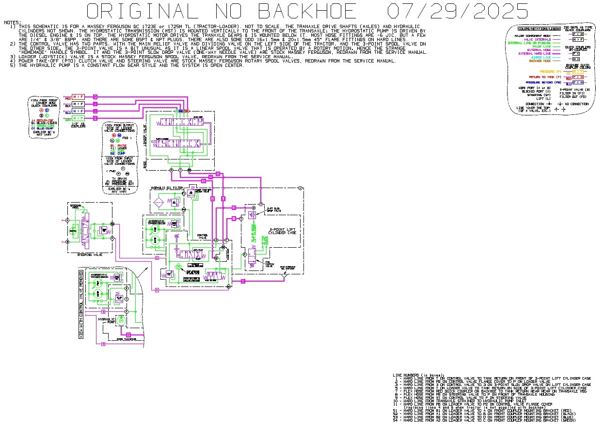

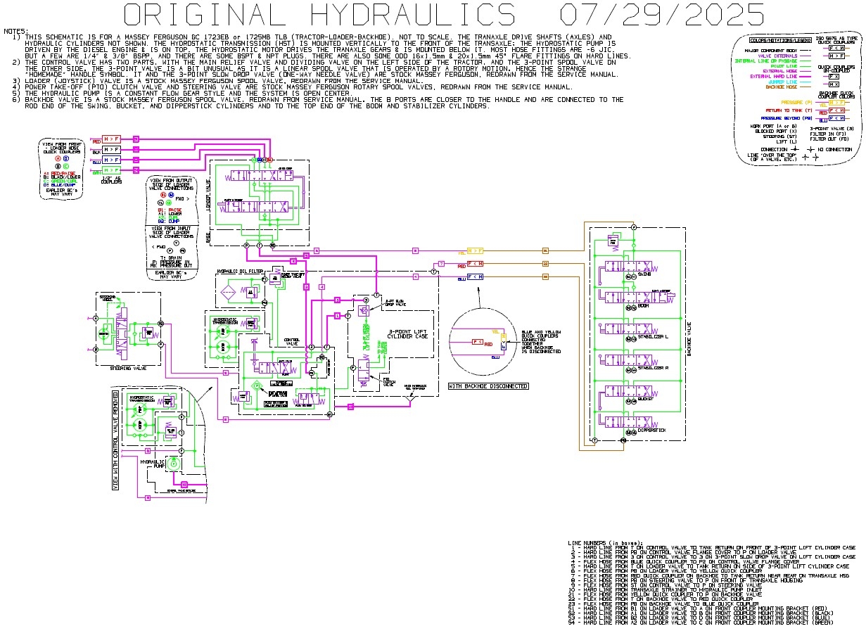

#29
Here are the revised schematics, with and without a backhoe. I have updated some of the line fonts, made a few changes to (hopefully) make these easier to understand, yada, yada, yada. Please review the "colors/notations/legend" section in the upper right as some of mine are unusual, again in the hope that it clarifies things.
Again, I have posted a picture of the schematics and then pdf's of them so you can open them up and zoom in.
edit: replaced picture/pdf because a line was missing : (
  • original hydraulics.pdf
  • original no backhoe.pdf
