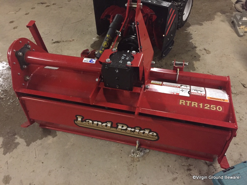

I bought my Land Pride tiller with the tractor new. I tilled over 3 acres with it last Spring, and it did fine. Getting it adjusted correctly on the 3 pnt will come with experience. IMO, tilling deep isn't good for your soil. 5" of tilling depth is plenty.
Thanks - that is useful info. And, that one seems to be a heavier duty one, as well. My thoughts on tilling deeper initially are for creating some drainage, though my tractor also came with a plow.

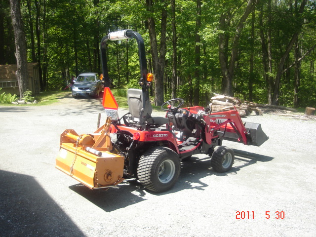

I have a Woods GTC40-2. Don't use it a lot, but it works very well and at 40" is just wide enough to cover wheel tracks on my GC.
