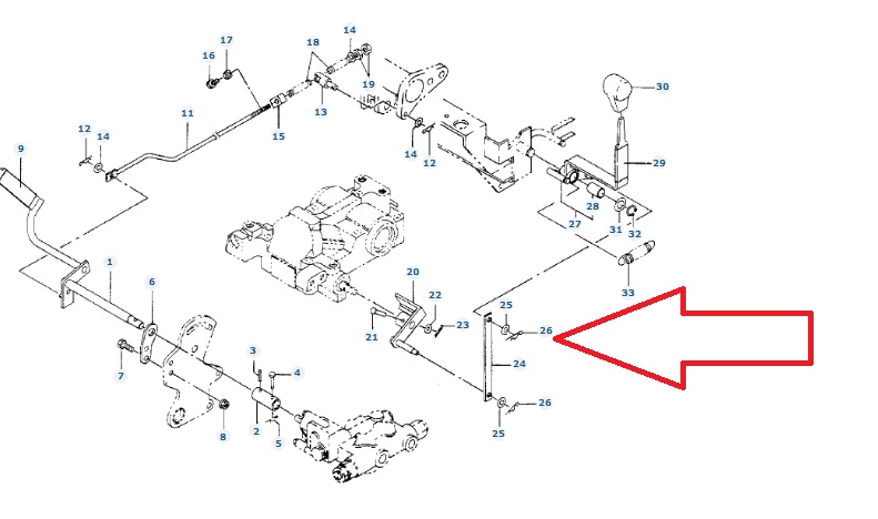

Ok so about year or so ago I replaced the auxillary oil pump and last week the front end loader and the 3 point hitch quit working.:dance1: So I remember the last time the power steering also failed but it is still working so does anyone have any ideas what could be the problem.:confused:

Check the linkage for the 3pt. control lever that it still connected to the valve. GC2300.jpg

no DMW when I lift the 3 pt handle it does nothing to the actuator i will get some pics tomorrow..Thank you for your responses ;;

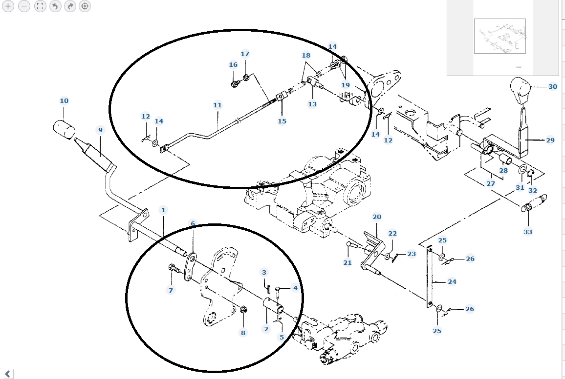

DMW i do not believe we have the same pump here is a diagram of my GC2300 TRACTOR PRIOR S/N JNA25201 Login

It's the [190] TRANSMISSION - POSITION CONTROL . If you still have hydraulics for the transmission and steering, your pump may be ok. The control valve pictured prioritizes flow. I believe transmission first, steering second, FEL/3pt last. If the linkage from the 3pt handle is not shifting the spool in the control valve, it may be stuck open, draining back to tank, so all pressure to the FEL and 3pt is lost. It's an easy visual check, tractor doesn't have to be on. All it takes is 1 cotter pin to fall out.
edit to include correct diagram. Arrow wasn't positioned correctly.

Man, that would be great !! after talking to couple of mechanics they seem to think my pump dumped on me ..I like your analogy though and when I get it jacked up p I will look into that and keep you updated..
