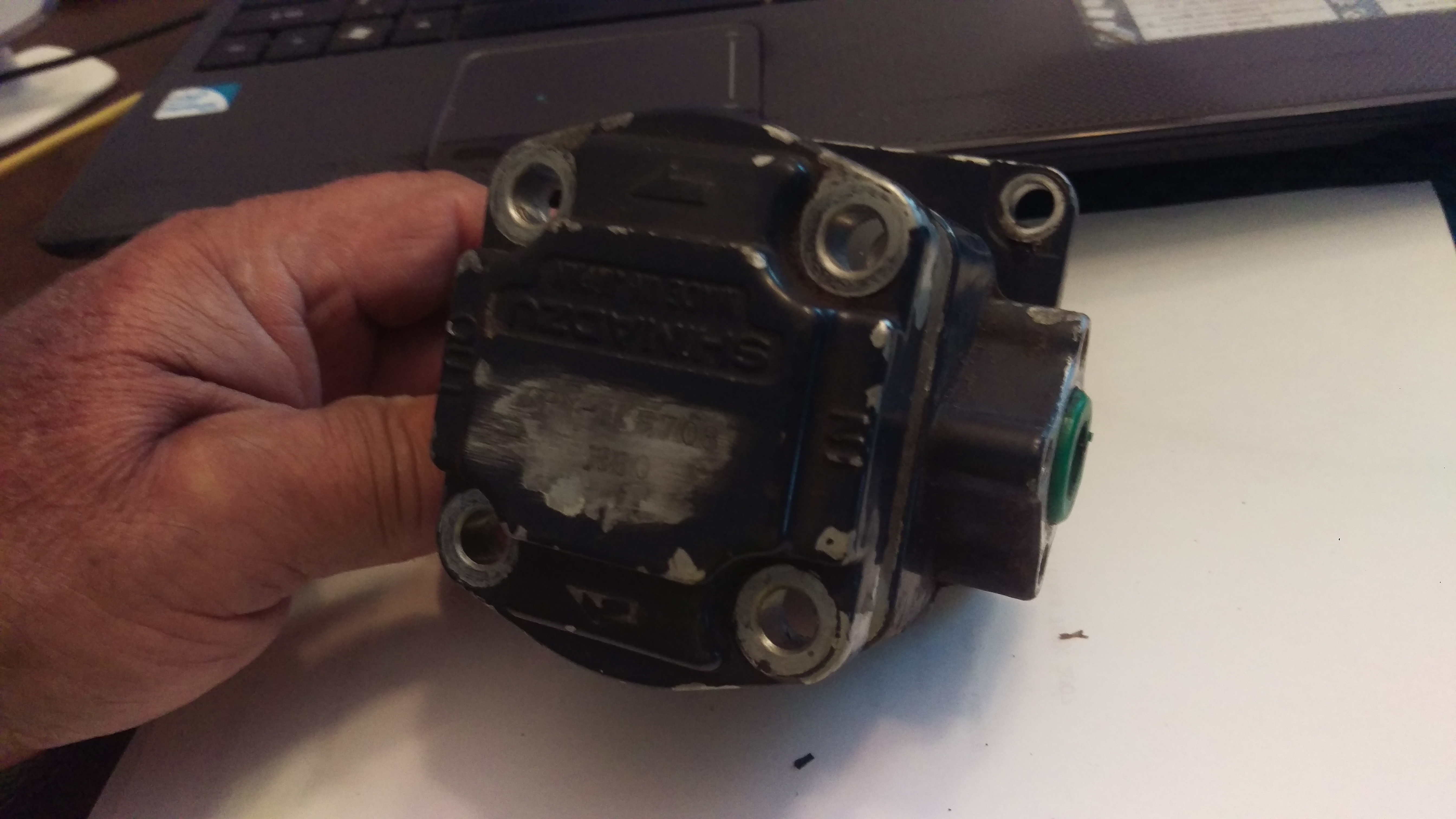

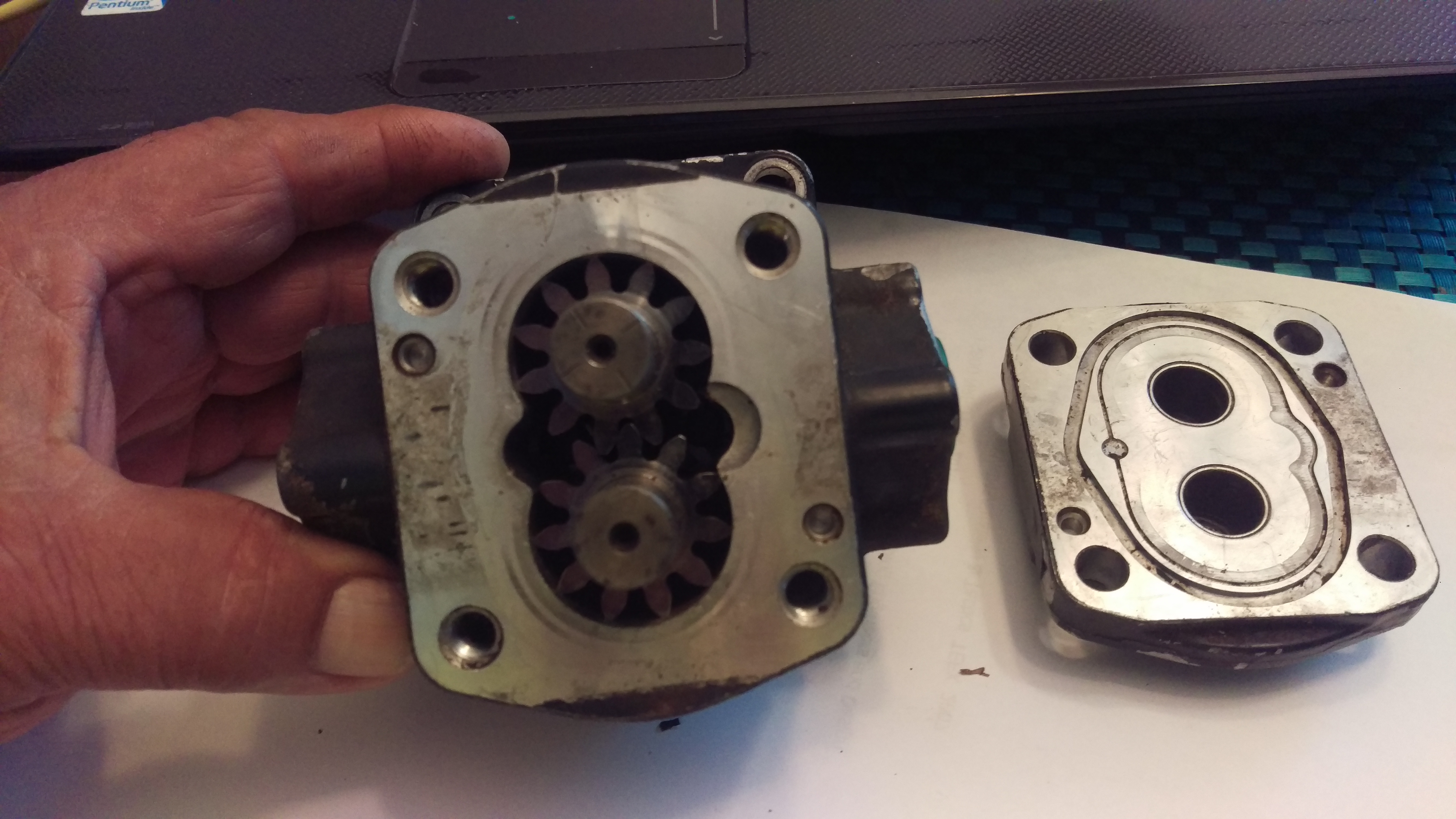

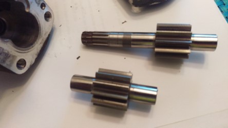

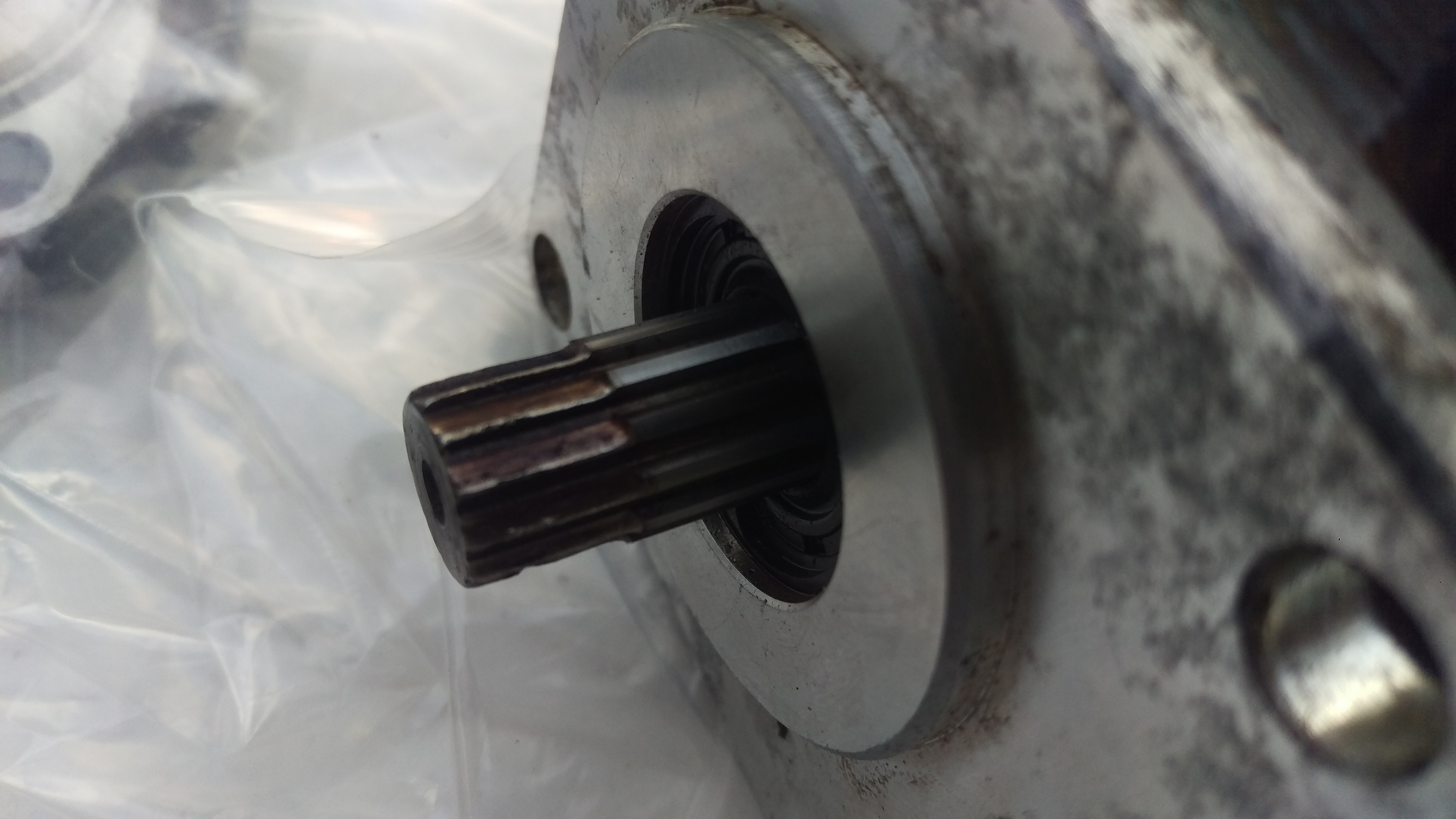

Not sure what you mean by, "pulled the cover off the pump".
You mean disassembled the pump? Or, you pulled it from the housing, and inspected the shaft, and transmission gear?
The photo you posted, is labeled invalid.
Just pulled the 4 bolts what holds the back of the pump and that enabled us to pull both gear s on the pump for inspection
   / GC 2300 hydraulic issues
#23
This are pictures of the old pump identical to the pump in the massey
I looked at the gear in the transmission with my camera and it is fine
Did not get pics of the gear in it now but looked good

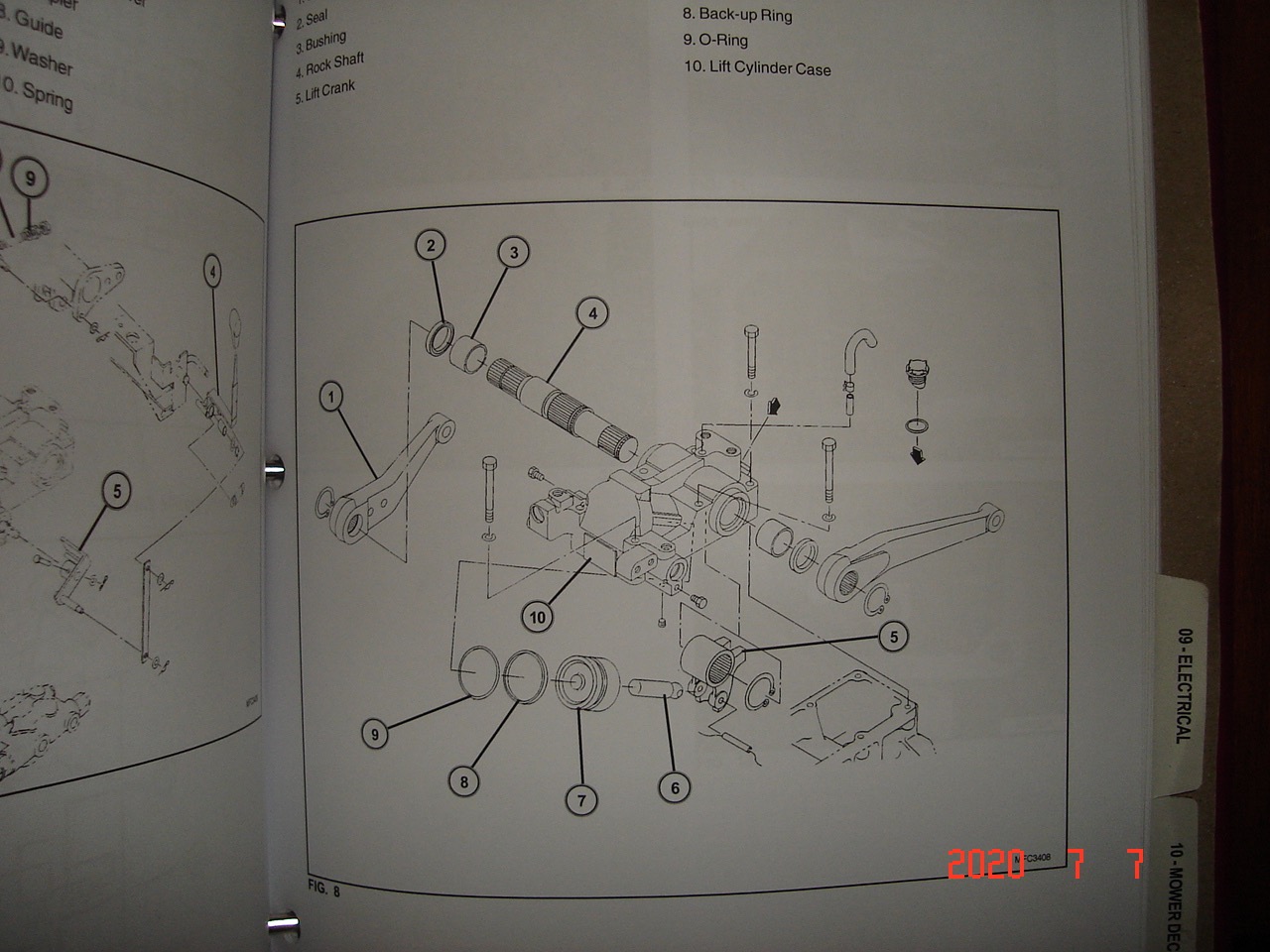

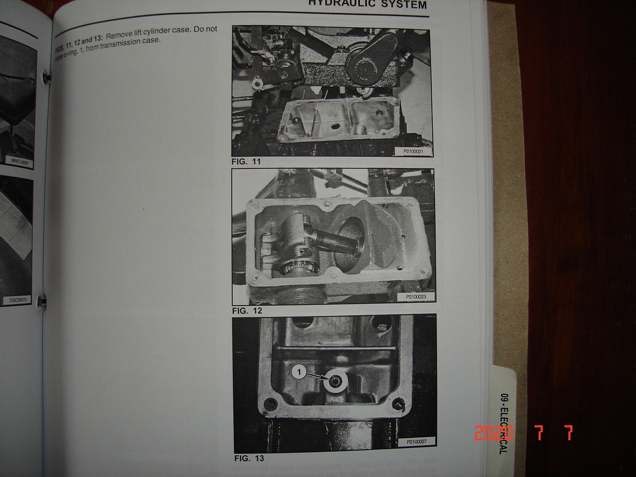

Here's a couple shots of the 3PH lift arm business from the service manual. As usual there aren't a lot of details in the book, but this may help to get you started.
They have you first remove all the sheet metal in the rear, then remove the fuel tank, then remove the "slow return knob" to get at the lift cylinder case, with a caution not to lose the o-ring from the transmission case (#1 in 2nd pic). They also suggest making punch marks on the lift arms to aid in re-assembly (get them in the same position they were in).
Missing in the first pic, #1 is the "Lift Arm," #6 is the "Rod," #7 is the "Piston."
Hope this helps.

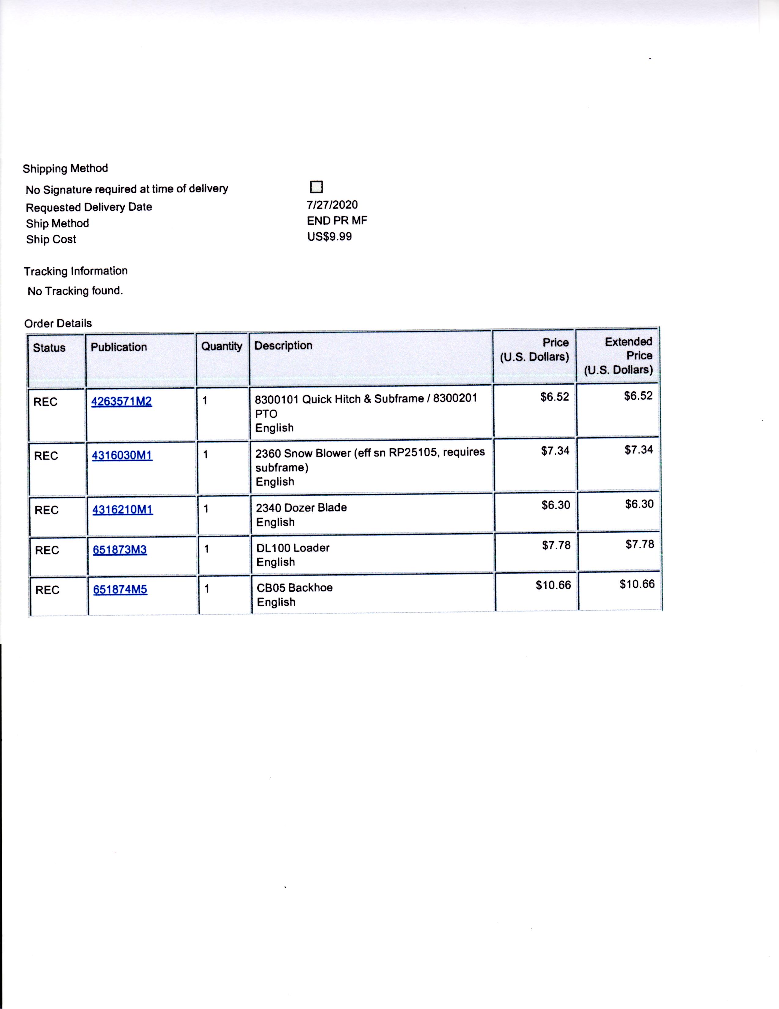

Last week I just ordered paper copies of the "Parts Book" for the QH, 2360 SB, 2340 DB, DL100 FEL, and CB05 BH from AGCO Technical Publications.
They have Electronic copies a little cheaper and you can also just view them on the AGCO Parts Book website (search for: DL100, CB05, 2340, 2350).
Here's the Publication #'s for those that are interested:
