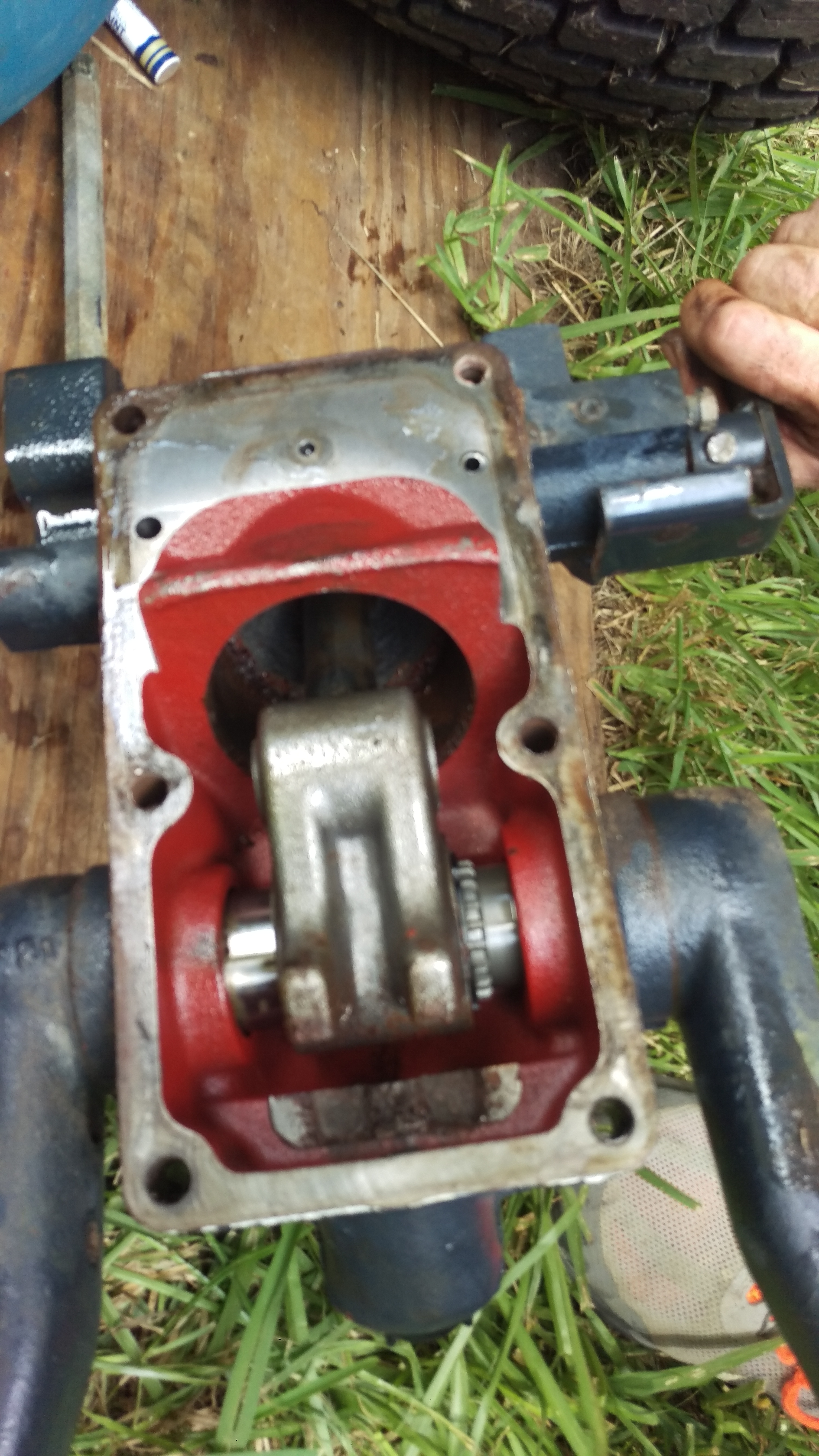

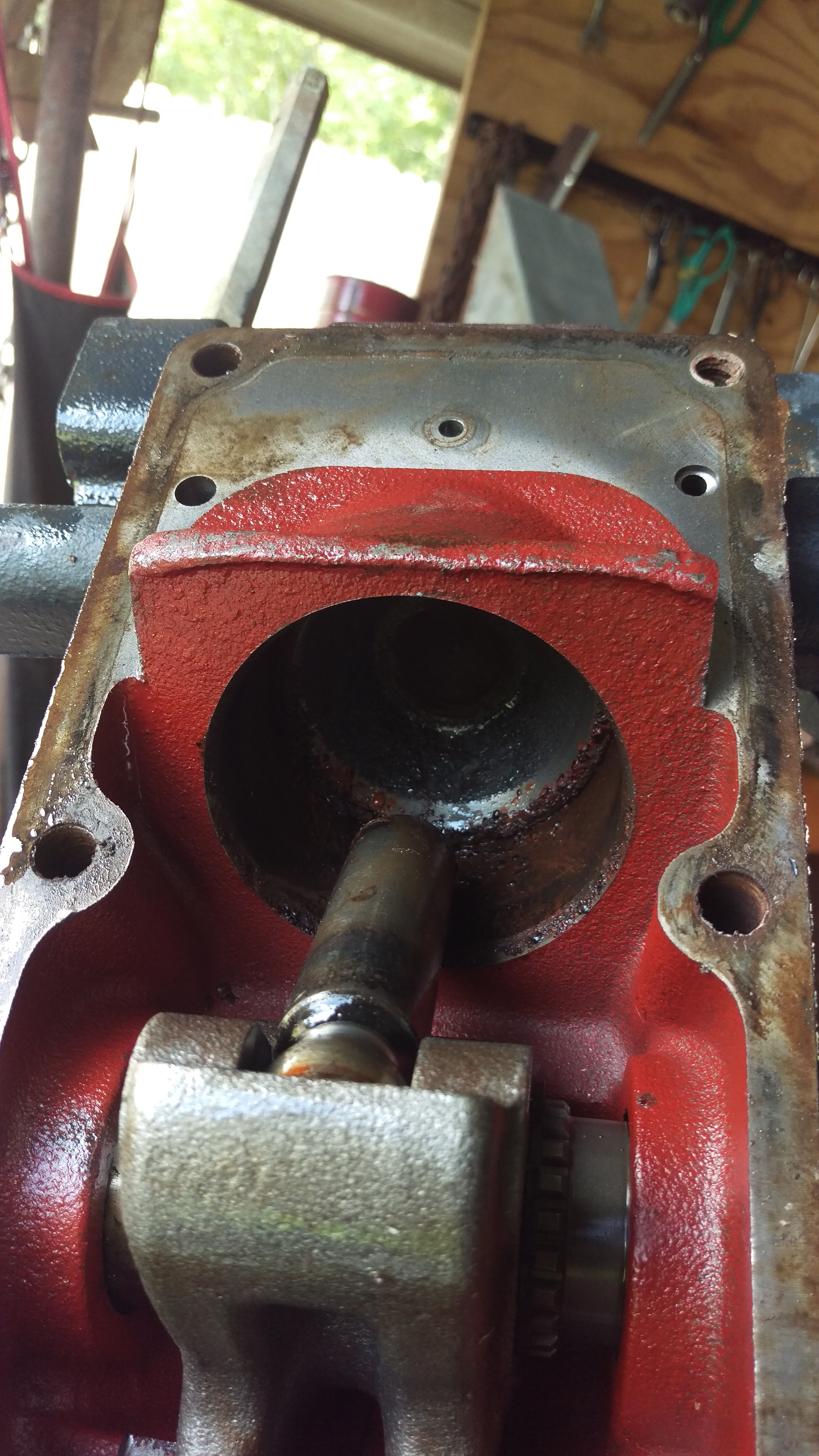

I finlly got it all apart and the piston was stuck on top of the cylinder wall on 3 pt lift ...had recived moisture in oil and rusted pictuers to follow .

The system had somehow gotten some moisture and rust build up in the lift cylinder caused the piston to get stuck at the top ....
We thought we had a broken connecting rod because you could lift the 3 pt without resistance but we were wrong.. IMAG3091_BURST002.jpgIMAG3092_BURST002_COVER.jpg
   / GC 2300 hydraulic issues #34
Wow -- glad you nailed it down, and are now on the way to fixing. Ray's right -- I've never heard of that, except in REALLY old tractors that have sat outside for years, but there sure is a bunch of rust in there; looks worse than some old brake calipers I've seen!
Any idea how water got in there?
