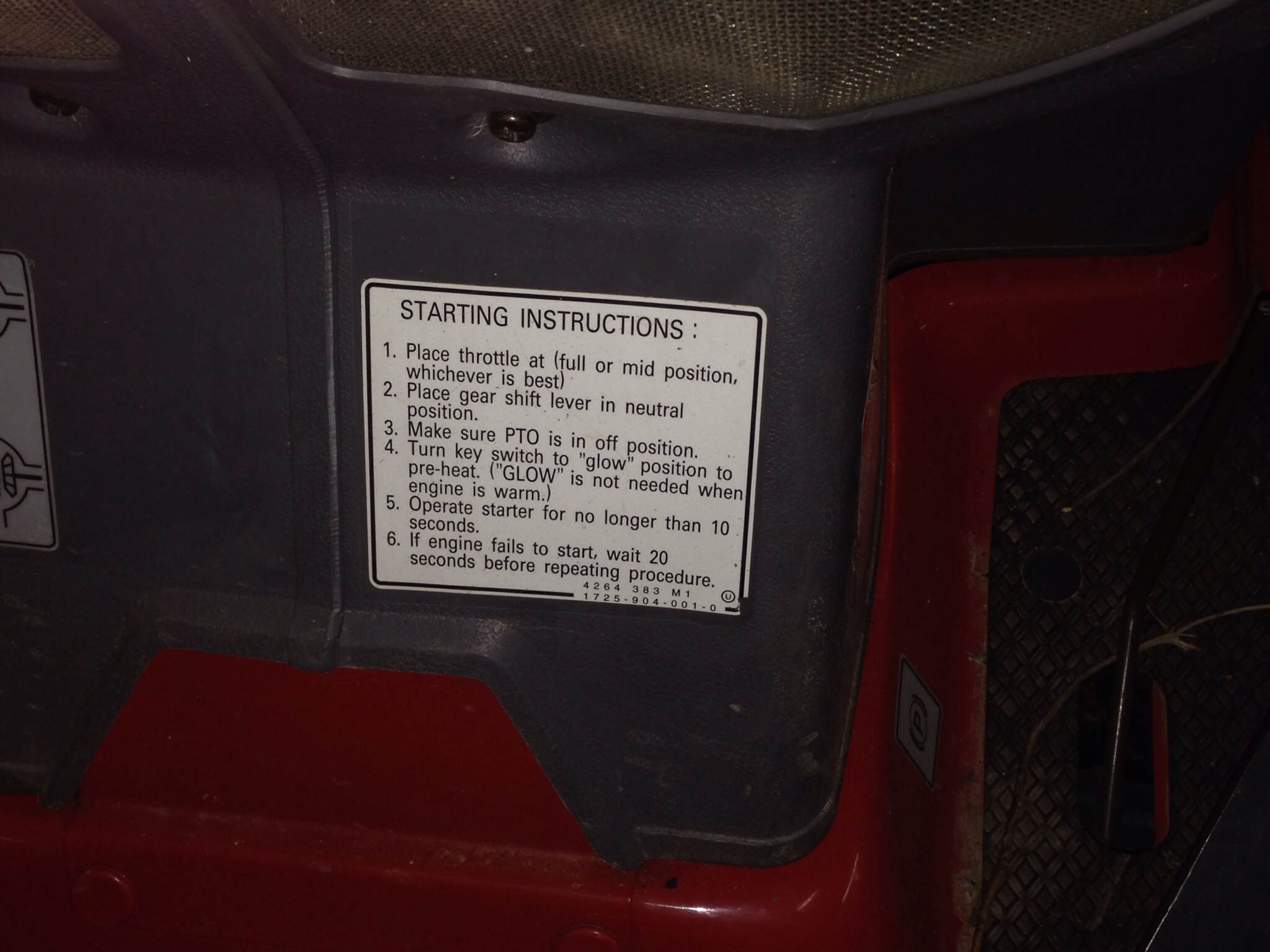

Here is the picture of the starting instructions on my GC2300 to prove you guys that I wasn't lying or crazy :). As you can see it says to Place throttle at (full or mid position, whichever is best).

I would stay with 1/4 inch throttle when cold, and no throttle when warm out. But that's me.

I just tried to start it with just a little throttle and it wouldn't start. I needed more than 1/2 throttle to get it running. If Massey is saying full or a little less to start it, why are you against what they say?

Eric in your defense, I have also seen decals on different tractors that stated you move the throttle to 3/4 advancement to start the motor. I questioned it myself but I have seen many of them. I have not chimed in on your problem as I am not familiar at all with the GC model tractors. I have only seen one or two come through the shop in the last year and I never got the chance to work on them.
Do these models have mechanical lift pumps or electric pumps on them. IF I were to make a guess I would say mechanical only because of the throttle settings required to start the engine.

I don't have a gc model, but the engine on my 1423 is pretty close to yours. And the instructions are the same as yours. Throttle at half to fully open to start. I don't use any throttle in the summer, an when the garage is hot in the summer, i don't have to warm up the glow plugs either.

Thanks Massey, It seems that when it is warm, I can start it with zero throttle and don't have to use the glow plugs. I suspect that as it gets warmer I will have to use less throttle too. I'm not sure if it has a mechanical lift pump or not.
