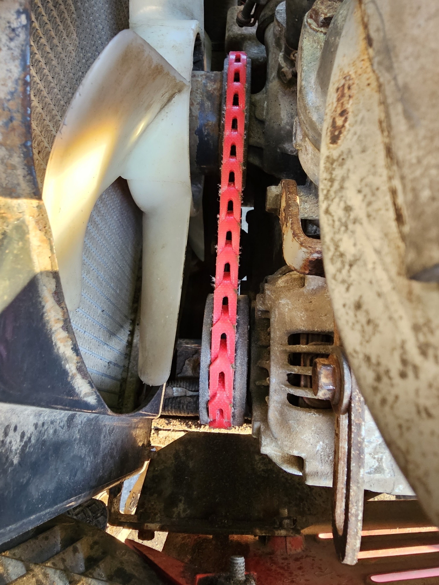

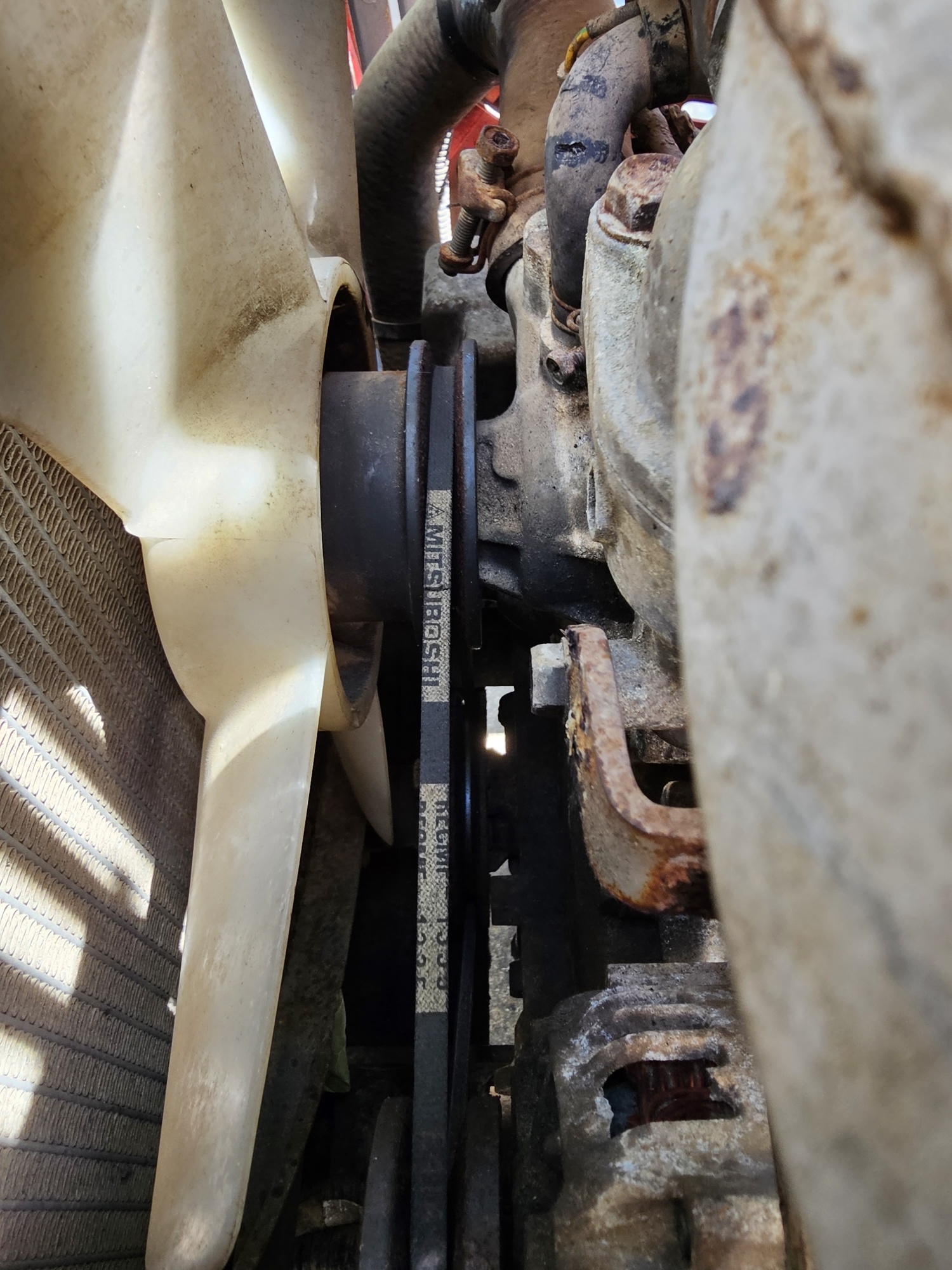

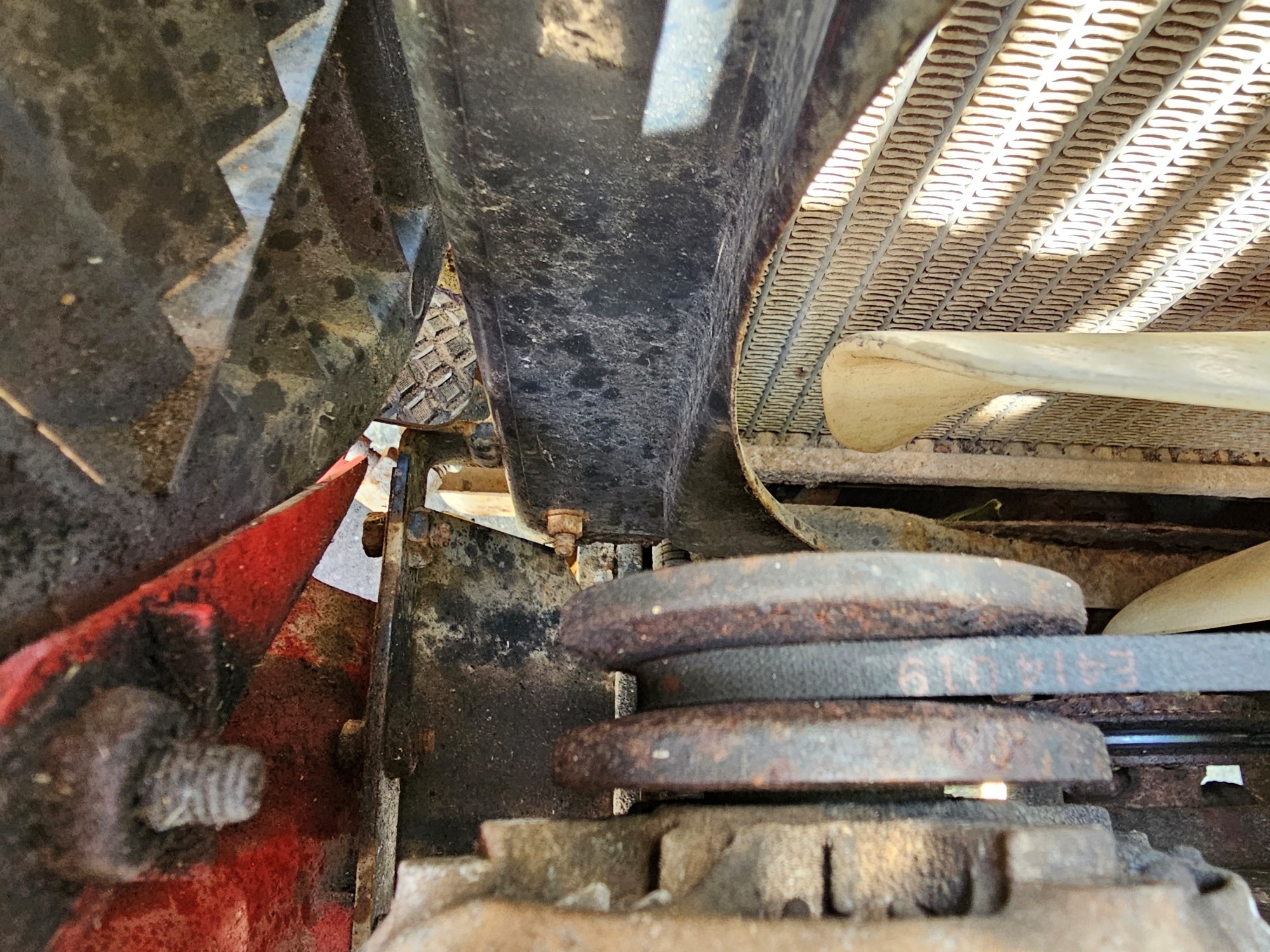

Dave, you are correct, there was a post but I withdrew it for a rewrite after finally getting the belt properly adjusted and running the engine for a while. The belt didn't come with any instructions so my first experience with it was a little uneducated and discouraging. However, after watching a few videos from Fenner Drives (Power Twist) and Megadyne - Jason Industrial (Accu-Link) on how to properly adjust their belts, and after about five hours of use, I am satisfied that it will perform as well, if not better, than a traditional V Belt. I am still running the Chinese-made belt I bought on Amazon for $30. I have plenty of links left over should I ever have to make a repair. I also bought an Accu-Link. It cost $46.99 from a seller on Amazon. I compared the two belts and to me, they look the same. As far as quality, only time will tell. In any case, it’s still less expensive than taking it to a dealer to replace it with the traditional V Belt and certainly less time-consuming if you replaced it yourself.
The original post.
On Saturday, July 1st, I tackled installing the link belt. From start to finish it took about 4 hours. So, it wasn't as simple as I thought it would be. Of course, each time I removed and replaced it, it became easier and faster. If you decide to purchase one of these, after measuring the length, you will want to heat the belt, making it a little more manageable. After heating the material you will want to tie a string to the second or third link and slide the other end down from the left side so you can work it around the crank pulley. You will also want to remove the right-side cover so you can grasp the belt and interlock the ends. I pushed the alternator as far inward as it would go to give me plenty of room for adjustment as needed. I think the adjustment distance is probably 3 to 4 inches. Since a traditional replacement belt is 34 inches, I measured the link belt at 32 inches because I knew it would have slack after being run for a few minutes. After running the engine for a couple of minutes, the belt became like a rubber band and stretched about 2 inches. After readjusting again to remove the bouncing I was seeing with the engine running, I ran out of adjustment and had to remove the belt so I could remove more links. Then, after repeating the procedure, I had to remove the belt so I could remove more links. Completely removing the belt is easier and faster to remove the links than it is trying to do so while in the engine compartment. After running the engine for a few minutes I readjusted the belt about an inch and thought surely by now the slack had been removed and the belt was seated properly in the pullies. Well, this belt just keeps stretching. My initial measurement was 32 inches. After running the engine several times, I removed a total of 4 inches of links from the original measurement. I let the engine run for about 30 minutes and had to readjust it again. Now, I am halfway through the adjustment arm for the alternator and if continued, I will have to remove more links from the belt. I don't know when it will stop stretching, but I know that I am through adjusting. I don't know if I just received an inferior product, or if all of the reviews about this particular belt weren't real. Maybe I should have bought the green belt instead of the red belt. Better yet, I am going with the traditional belt. The original belt lasted 18 years. Maybe the next one will too.
