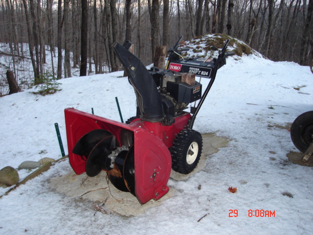

Incidentally, the same thing used to happen wth my walk-behind blower. It was 24" Toro with a weight-shift mechanism (rocked the drive wheels to the rear about 6"); I had to use that wheels-shifted-to-the-rear position every time I went uphill, to keep the blower scraper from lifting up. (After 18 years of that, I got my 2310!)

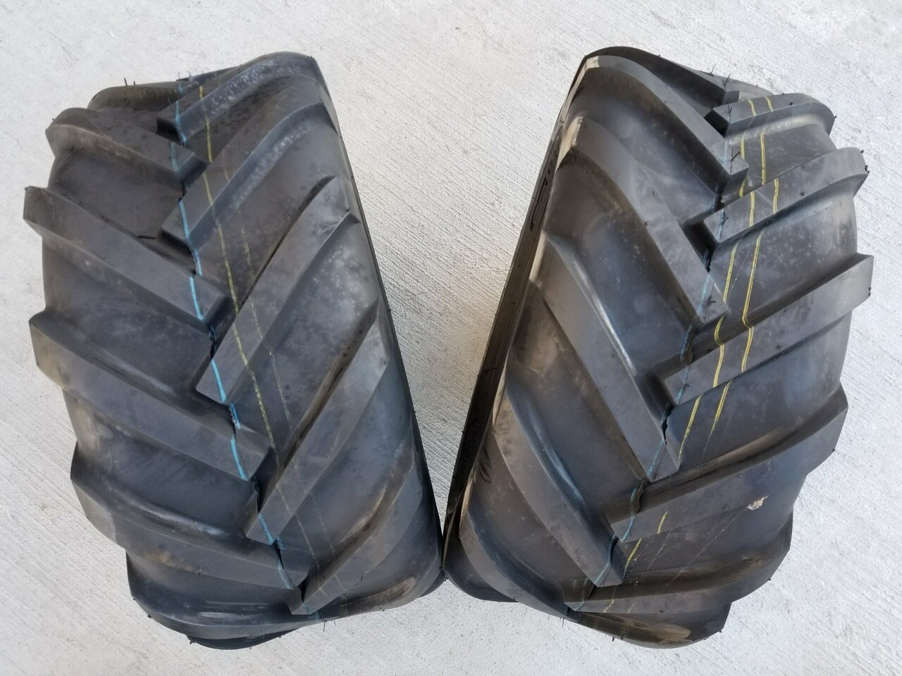

I had deestone superlugs on fronts and rears of that so I had rotation just when really pushing the fronts could lift up 4+ inches.
