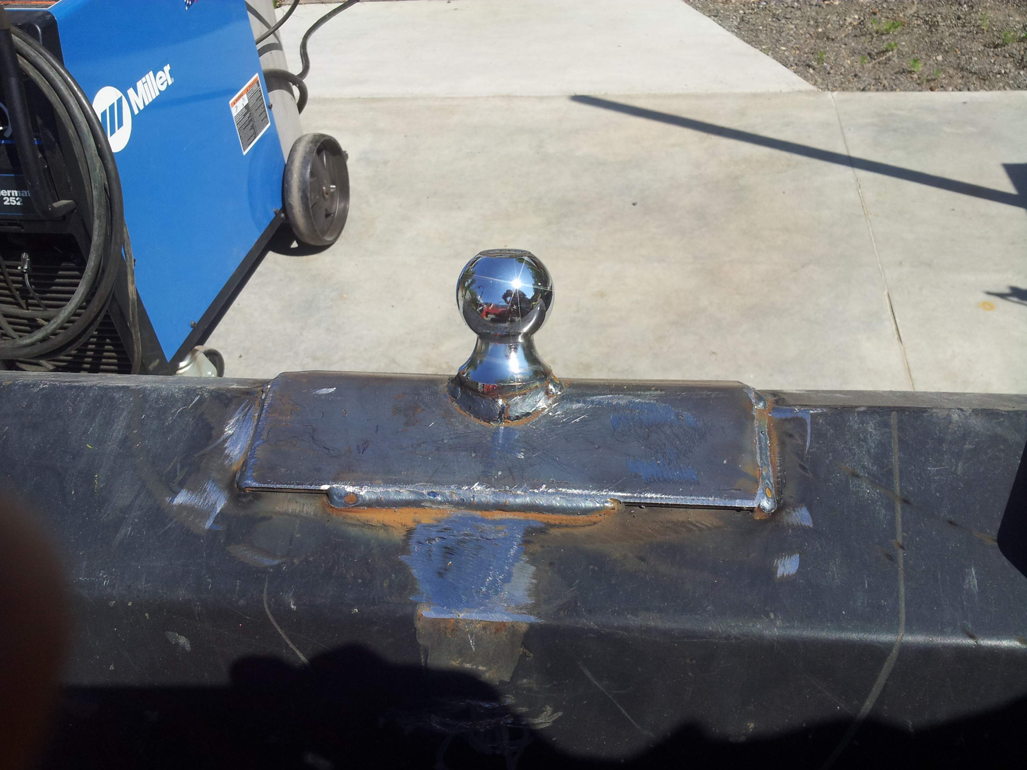

Here are a few things I built for mine.
http://www.tractorbynet.com/forums/build-yourself/175890-just-another-thumb-project.html
http://www.tractorbynet.com/forums/build-yourself/193825-easy-forks.html
Massey Ferguson GC2410 backhoe dolly - YouTube
Btw, I really like the look of that cab... will probably build one like it :thumbsup:
