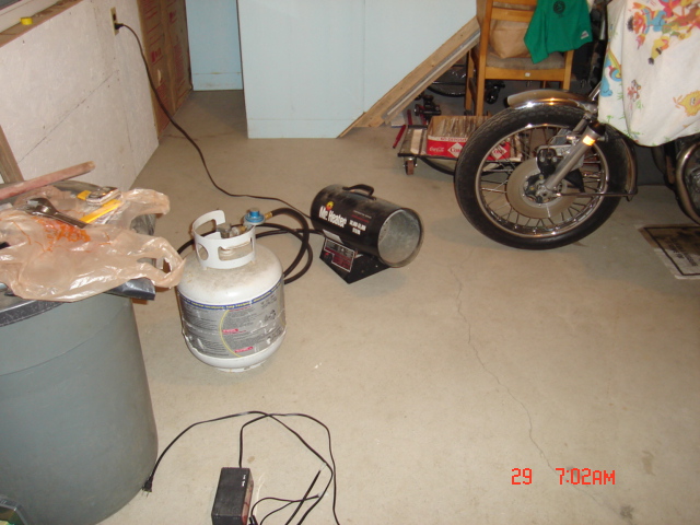

Interesting, Ray... does that mean it could warm up my O-320? All the engine heaters I've been perusing so far are mucho --scary-- bucks. If something like Northern's stick-on could work that would save a ton of money!

The issue with an O-320, is the significant amount of oil that is in the oil cooler would not get warmed. I prefer to preheat with a torpedo heater into a manifold, made from furnace pipe. Then, everything gets warmed.

When you mentioned a "torpedo heater" with stovepipe duct... you mean one like this? I had it for temporary heat in my garage, but now it just sits around --stored-- now that I finally have a more permanent solution to garage heat. I hadn't thought of using it for O-320 heat. It would be great to find a use for it! I suppose it would be safe as long as it was several feet away from the engine? Walt

I will send you a PM.
