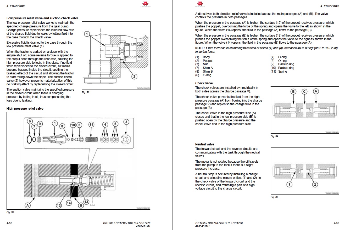

Oct 10, 2019 / GC1700 hydro trans groaning when pushing the forward pedal, is this normal? #21 N Nacademus Gold Member Joined Sep 10, 2018 Messages 255 Location Rural, Ohio Tractor Massey Ferguson GC1720 Mine will barely roll on its own when on a hill, in gear, and no pedal pressed.
Oct 10, 2019 / GC1700 hydro trans groaning when pushing the forward pedal, is this normal? Thread Starter #22 OP GeneV Elite Member Joined Aug 19, 2019 Messages 3,202 Location Lake County, IL Tractor Bradley 48" stander MF GC1710 Nacademus said: Mine will barely roll on its own when on a hill, in gear, and no pedal pressed. View attachment 624348 Click to expand... Well maybe "rolling" is the wrong term to use, but mine definitely moves. But I don't think it's a problem there.
