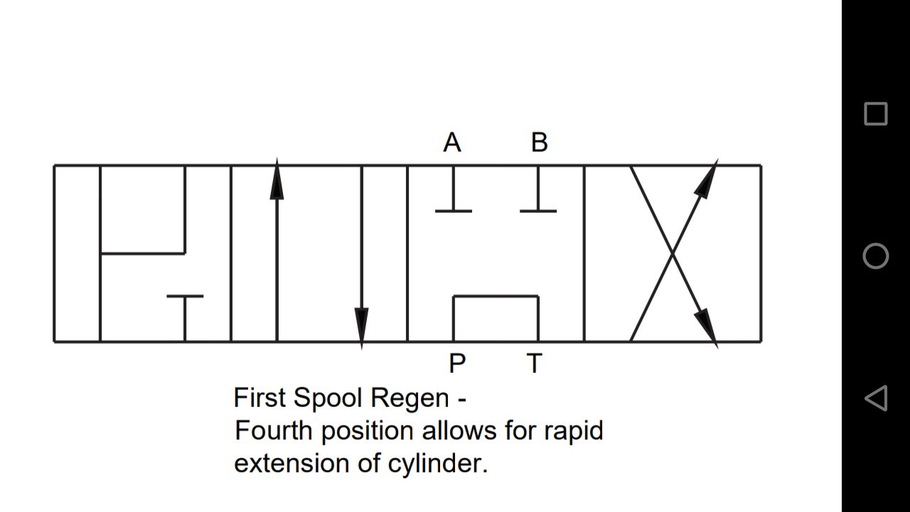

Here is the flow diagram for the bucket circuit of the Surplus Center regen valve that I linked to before:
Each box is a different position for the bucket circuit in the valve, the top two connections are the lines to the bucket (A and B) The bottom two are the pressure inlet (P, on the left and T, on the right).
Note that in the far left box (regen dump), the P, A and B lines are connected.

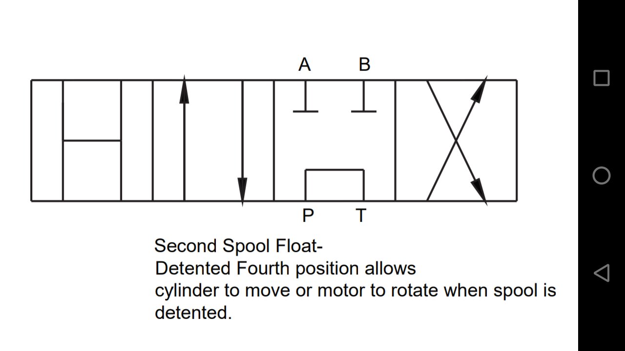

Here is the flow diagram for the loader arm circuit of the Surplus Center regen valve that I linked to before:
Each box is a different position for the bucket circuit in the valve, the top two connections are the lines to the loader lift cylinders (A and B) The bottom two are the pressure inlet (P, on the left and T, on the right).
Note that in the far left box (float), the P, T, A and B lines are connected, this is different from the regen circuit and is why the loader will lower in float vs raising.
In theory, if you swapped the lines for the loader lift and bucket dump circuits, it would lift with regen dump position if the pressure difference was enough.

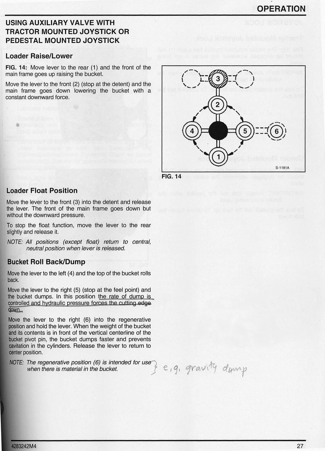

Yes, I do have regen dump on my tractor. I don't understand your test. If the loader lift (e.g. frame control) is in float it just lowers to the ground until the bucket stops it and sits there. One does not move the loader to put the bucket into regen dump position but rather you move the joystick to the far right (position 6 in the diagram below) beyond the normal "force downward" position. The bucket stops of course when it lies flat on the ground. It got there by gravity. It won't lift the tractor front up at all since the loader valve (in regen dump) is allowing rapid flow back to the reservoir and not affecting the movement of the curl/dump cylinders. The bucket will not force the tip downward in regen position. It could not lift the front end anyway in the test you suggested because the loader frame was to be in float mode so the loader frame would just rise, not the tractor, if additional dumping motion happened in the regen mode.
I SAY all that as if I'm on the thing, but my tractor is 300 miles away and I can't just go get on it. I travel to the farm once a month. I just know that is how it acts from having used it for the past 8 years. [I'll certainly do due diligence and run your test next time I am back there.] I hesitate to have all these folks bored with details of my situation but ...I'll try to be concise and tell it:
The original loader valve (NIMCO CV152) brand new, 2011, was defective such that one could not force the bucket tip downward regardless of control position. At least 2 other loader valves on MF 2650/60 series tractors new on the lot at a dealer had the same issue (he had sold a 3rd and it reportedly had the same issue.) On top of that, the AGCO depot level parts people sent the dealer a new CV152 which was put on my tractor replacing the original. It was bad with the exact same disease. AGCO gave the dealer little/no help, the dealer was baffled, and with me only there once a month it was ... a mess. Finally I contacted NIMCO myself, their engr told me "they had let a few bad ones out the door" and he sent me a kit to replace the spool control assembly out on the end of the loader valve. I fixed the thing myself that way. Had to do with cumulative tolerances out along the length of the spools. After that I can lift the front end off the ground using dump position but not regen dump of course.
Here is the applicable page from the operator's manual:
Notice that in position 5 the bucket dumps and...hydraulic pressure forces the cutting edge down. In position 6 (the regenerative position) the weight of the bucket and contents dumps potentially faster than it would under normal hydraulic pressure and (since the hyd fluid is bypassing everything and going straight back to the reservoir, cavitation is prevented.) If you had a very heavy bucket load and went into dump as hard as you could go WITH hydraulic pressure, the load would in effect be sucking fluid too fast through the cylinder leaving air space behind (hydraulic flow not keeping up with the drop rate) and making for potential cavitation damage over time. So if you want to do a lot of heavy loader work dumping as quickly as you can -- go to the regen position and let gravity do the faster dumping. That's the way I read the manual and that is my understanding.
I hasten to say this situation with an 81 horse 2660 and a DL250 loader is probably different from the behavior of a DL95 or whatever the OP is using on his GC1700. Intuitively I would think that the GC1700 series is much less likely to have this more complicated type loader valve.

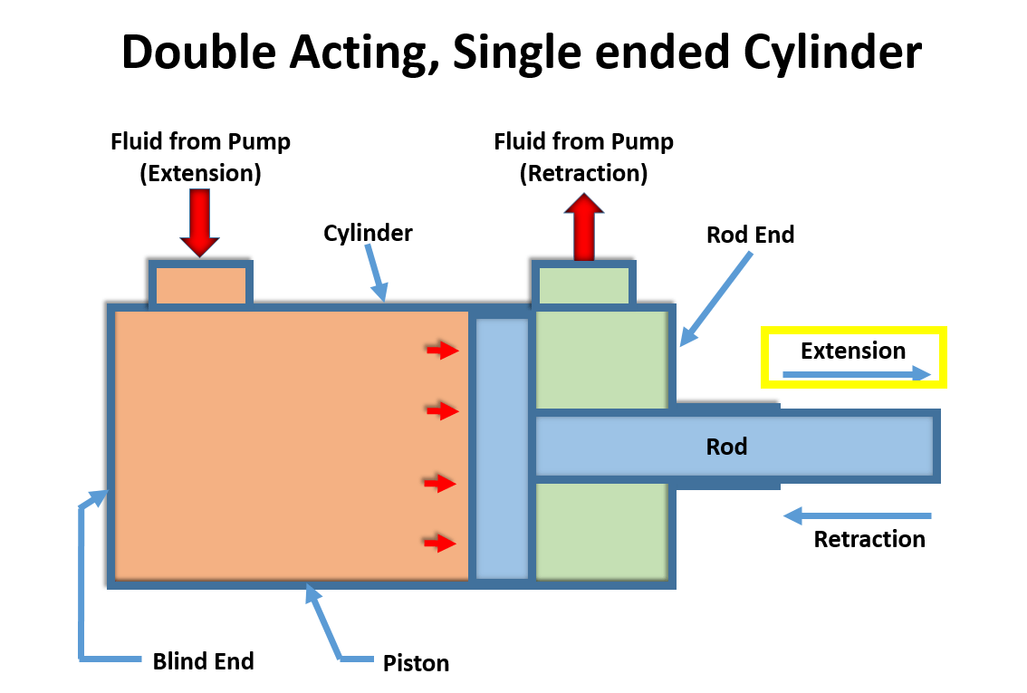

Let's start here, since the difference is what makes regen dump work.
Here is a generic hydraulic cylinder:
attachment.php
If the bore (the diameter of the inside of the cylinder housing) is 2" and the diameter of the rod is 1", there is enough surface area that if you put fluid into the blind or base end at 2000PSI (with no pressure on the rod end) it will try to extend with 6283# of force.
If you put the same 2000PSI into the rod end, the surface area of the disc on the end of the rod is smaller due to the diameter of the rod, so it will only retract with 4712# of force.
If you put 2000PSI into both sides with them tied together (like regen dump does), it will extend with 1571# of force due to the difference in surface area on the disc that is mounted on the end of the rod for the hydraulic fluid to push on.
Does that make sense? Do you follow me so far?
