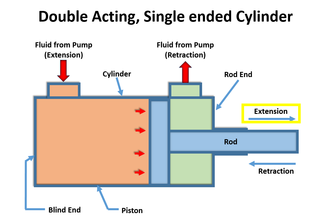

Here is a generic hydraulic cylinder:
attachment.php
If the bore (the diameter of the inside of the cylinder housing) is 2" and the diameter of the rod is 1", there is enough surface area that if you put fluid into the blind or base end at 2000PSI (with no pressure on the rod end) it will try to extend with 6283# of force.
If you put the same 2000PSI into the rod end, the surface area of the disc on the end of the rod is smaller due to the diameter of the rod, so it will only retract with 4712# of force.
If you put 2000PSI into both sides with them tied together (like regen dump does), it will extend with 1571# of force due to the difference in surface area on the disc that is mounted on the end of the rod for the hydraulic fluid to push on.
Does that make sense? Do you follow me so far?

KennyD explained it well:
https://www.hoyetractor.com/support/knowledgebase.php?article=96 said:
Regen is a "feature" of most modern FEL (Front End Loader) valves, it's on the Dump (joystick far right) circuit, and is also referred to as "Fast Dump". The reason it is nice to have is that without it, the weight of a filled bucket can actually "pull" the bucket down faster than the fluid can enter the other side of the cylinder, this will create a air pocket and give the bucket a "floppy" feeling until the joystick is held in the dump mode a few seconds to refill the cylinder pushing the air past the seals. So we add "regen" or "regenerative" function to the valve.
Regen solves this problem by actually filling both sides of the cylinder at the same time with hydraulic fluid. But how will that work you might ask? Well, because there is more volume on the side of the cylinder that extends it since the rod is taking up space in the other side, it "overpowers" the rod side and lets the cylinder extend-thereby dumping the bucket. So since now both sides of the cylinder are "pressurized", the air pocket can not develop, eliminating the "floppy" bucket syndrome. One other added bonus is that the bucket actually dumps faster due to the higher flow rate required to do all this, that's why it's referred to as "fast dump" sometimes.
