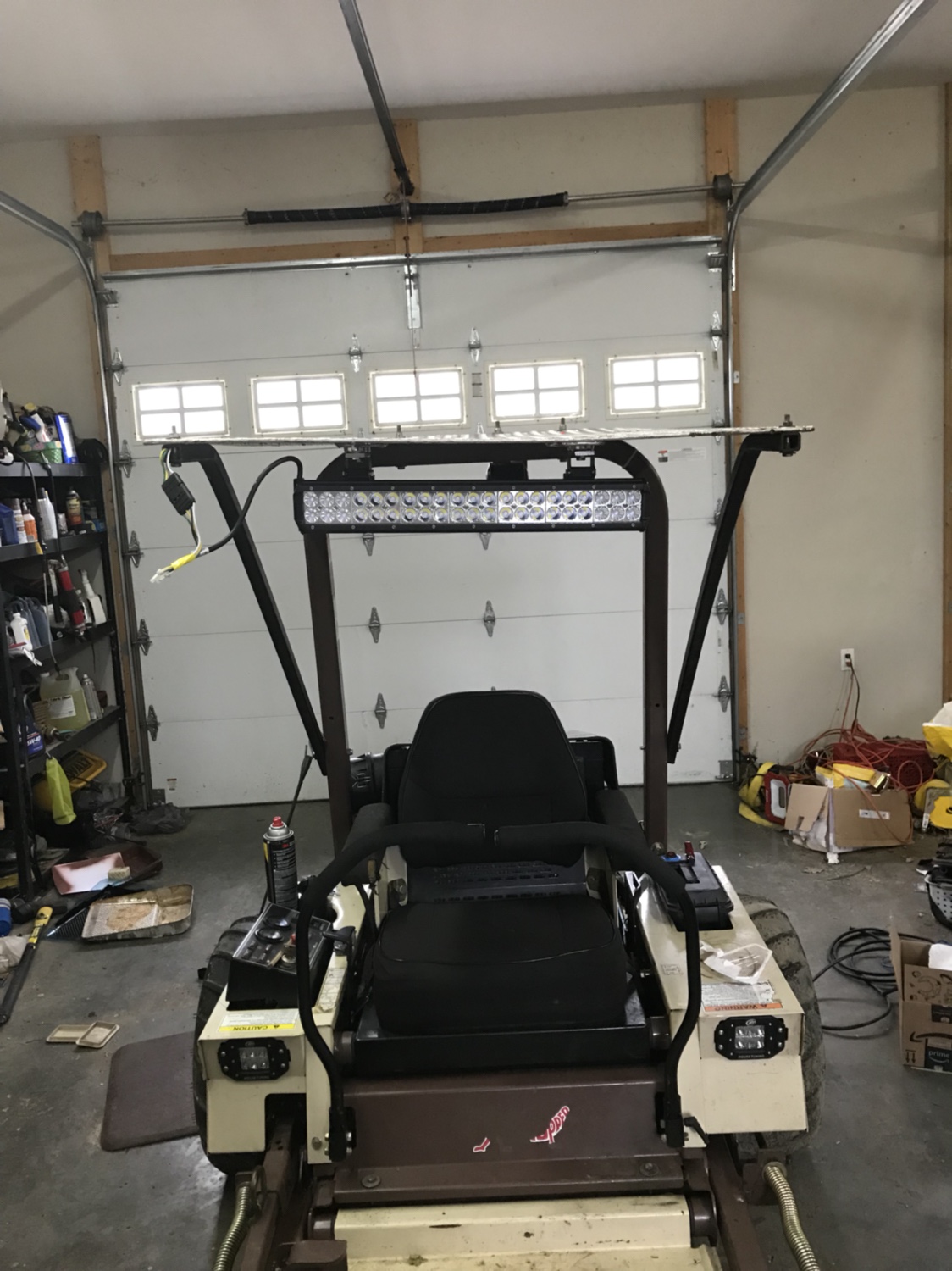

I have a pair of 18 watt lights on the back of my truck. They’re nice backup lights but they’re not enough light from working on the tractor by my taste. I have a 120 watt bar on the tractor. I recently added nearly 200 watts of lights on my Grasshopper. It has a real alternator unlike most lawnmowers so I’m hoping it’ll be able to support that load. IMG_1625.JPG

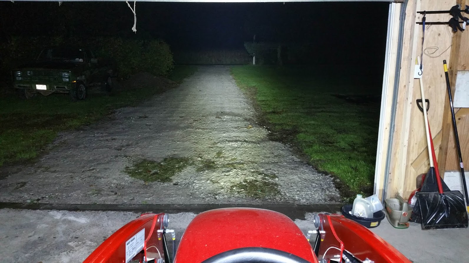

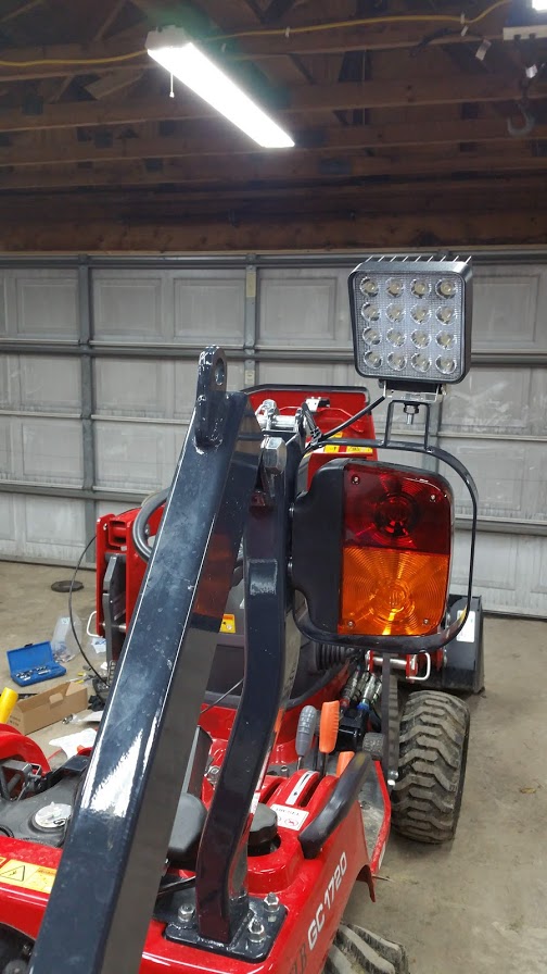

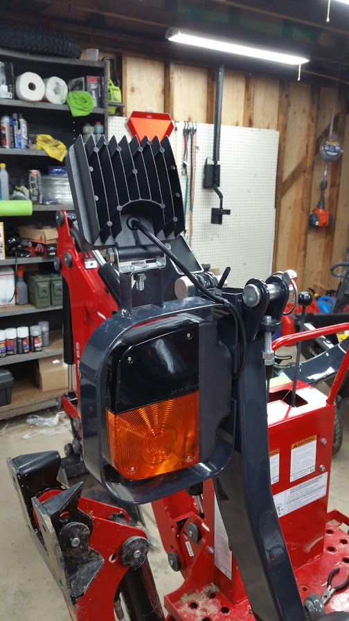

I powered them from the rops lights off the switch because I like to leave the lights on after I shut the tractor to close up the barn and then hit the headlight switch and all the lights shut off..
   / GC1705 Adding LED Lights #16

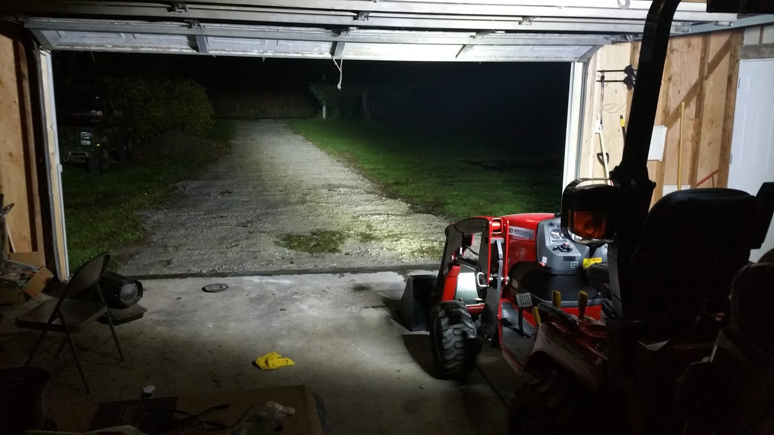

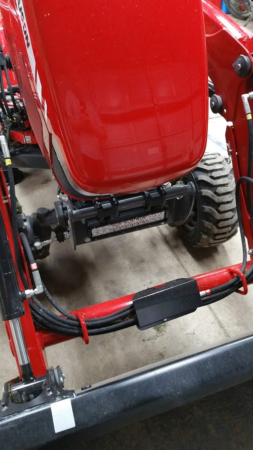

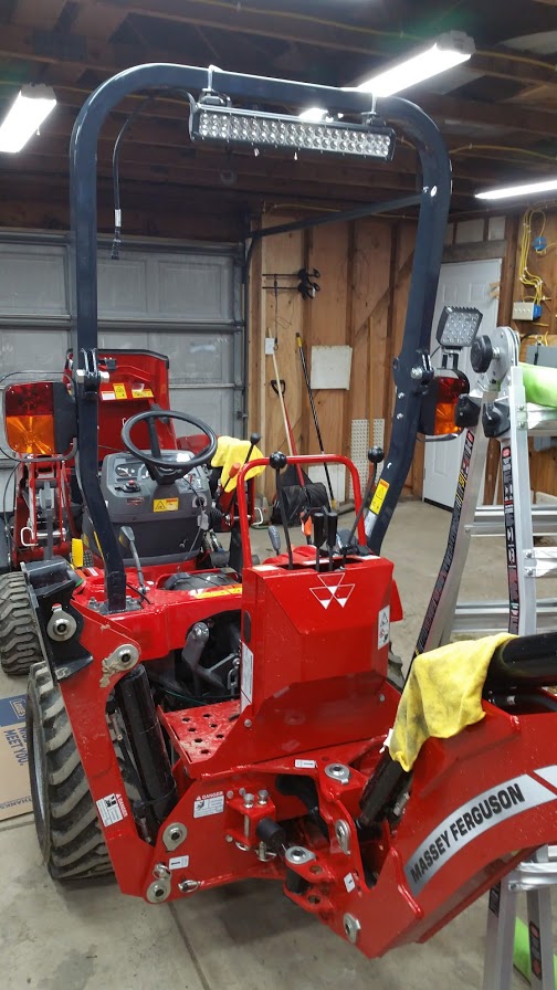

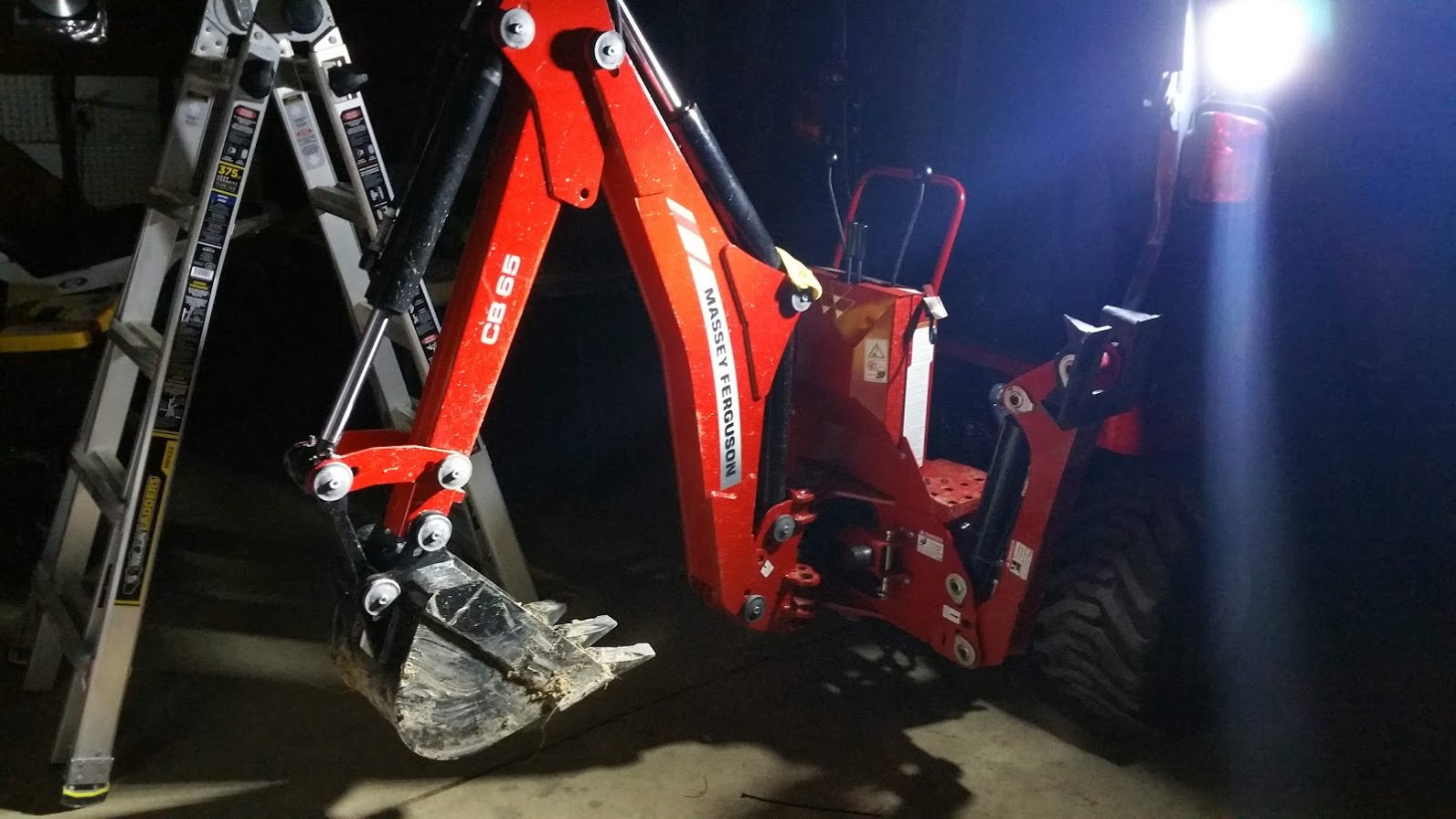

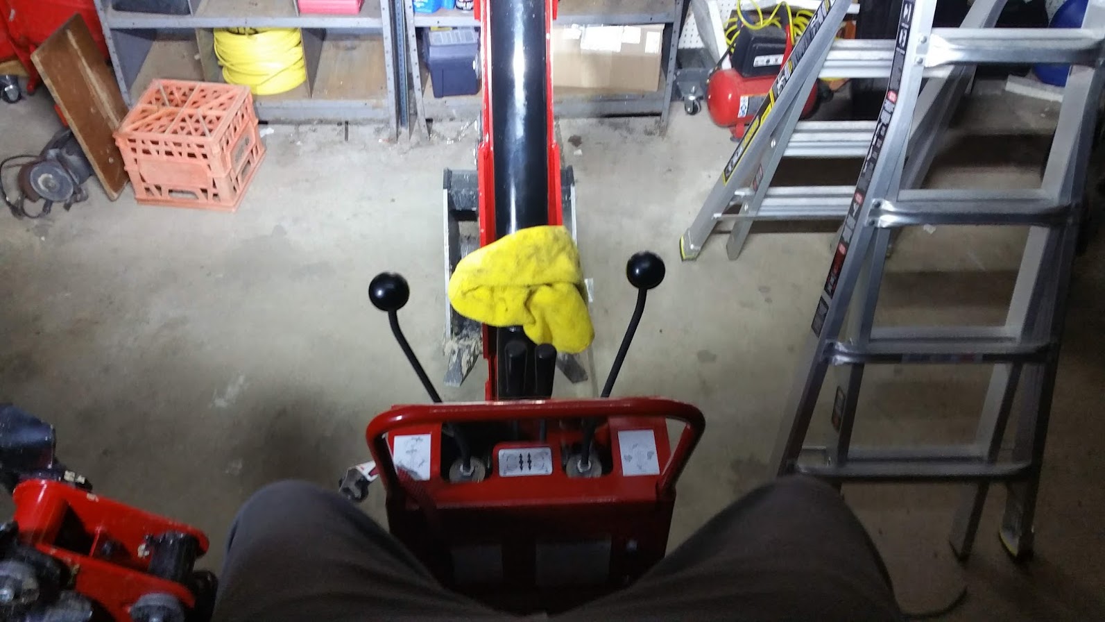

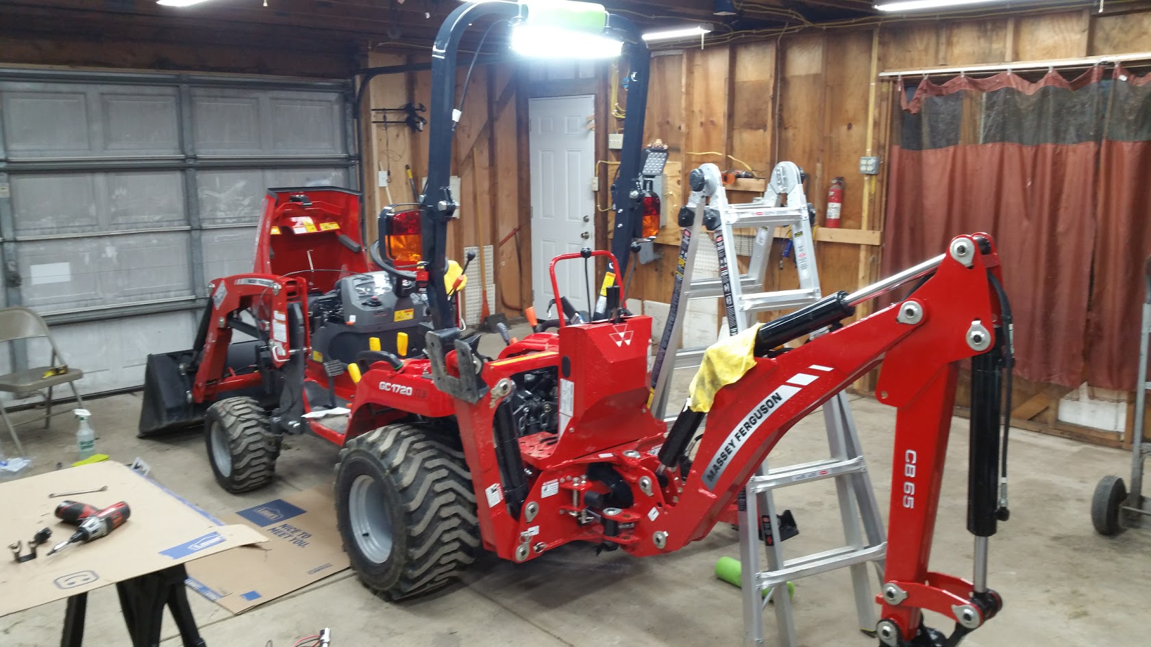

This is how I ran my lighting on my GC1720. I ran the wiring along all the factory pathways. I disconnected the stock backhoe lighting circuit and capped/abandoned it for a custom ran one. All connections are weather-pack connectors and double heat-shrink wrapped. The wiring itself is thick insulated 2 wire sleeved.
I have a circuit controller with 4 relay circuits that operate off a soft switch to control all the lights. These photos are from the work being done. Any wiring you see hanging at the ROPS was loomed and ziptied tight and out of the way. The only visible wire is the one from the overhead lights until it goes down the ROPS and disappears into the pre-existing hole. All lights have a connector near where they terminate for easy replacement. If you have any questions, let me know.
