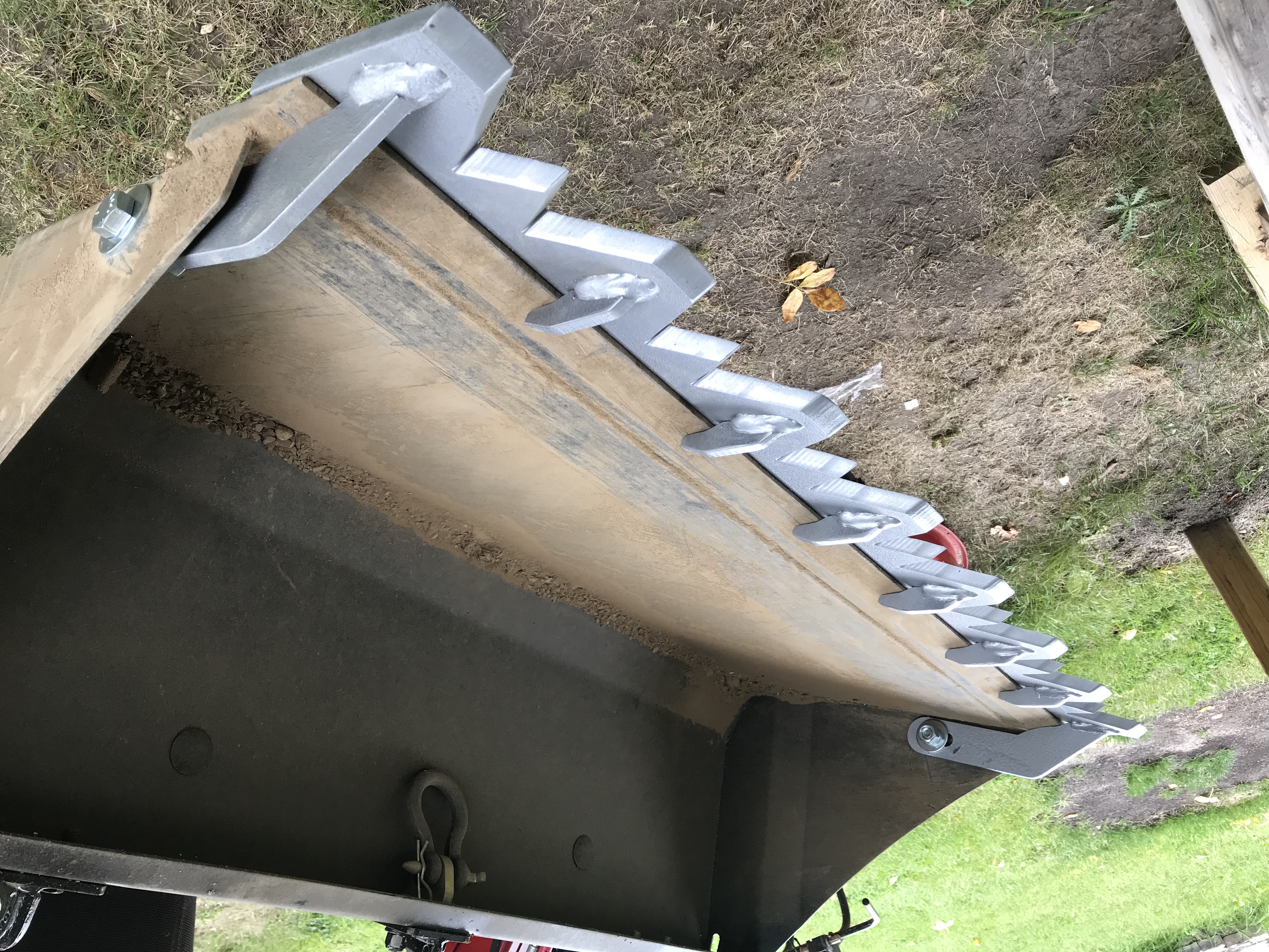

I recived the Piranha bar and installed it this afternoon, took about 5 minutes from start to finish and it fits perfectly I also put the Edge Tamers on and they fit without any modifications to the bar, just wanted to show some pics, I have a big area of brush I will try it on tomorrow.
Bar installed.

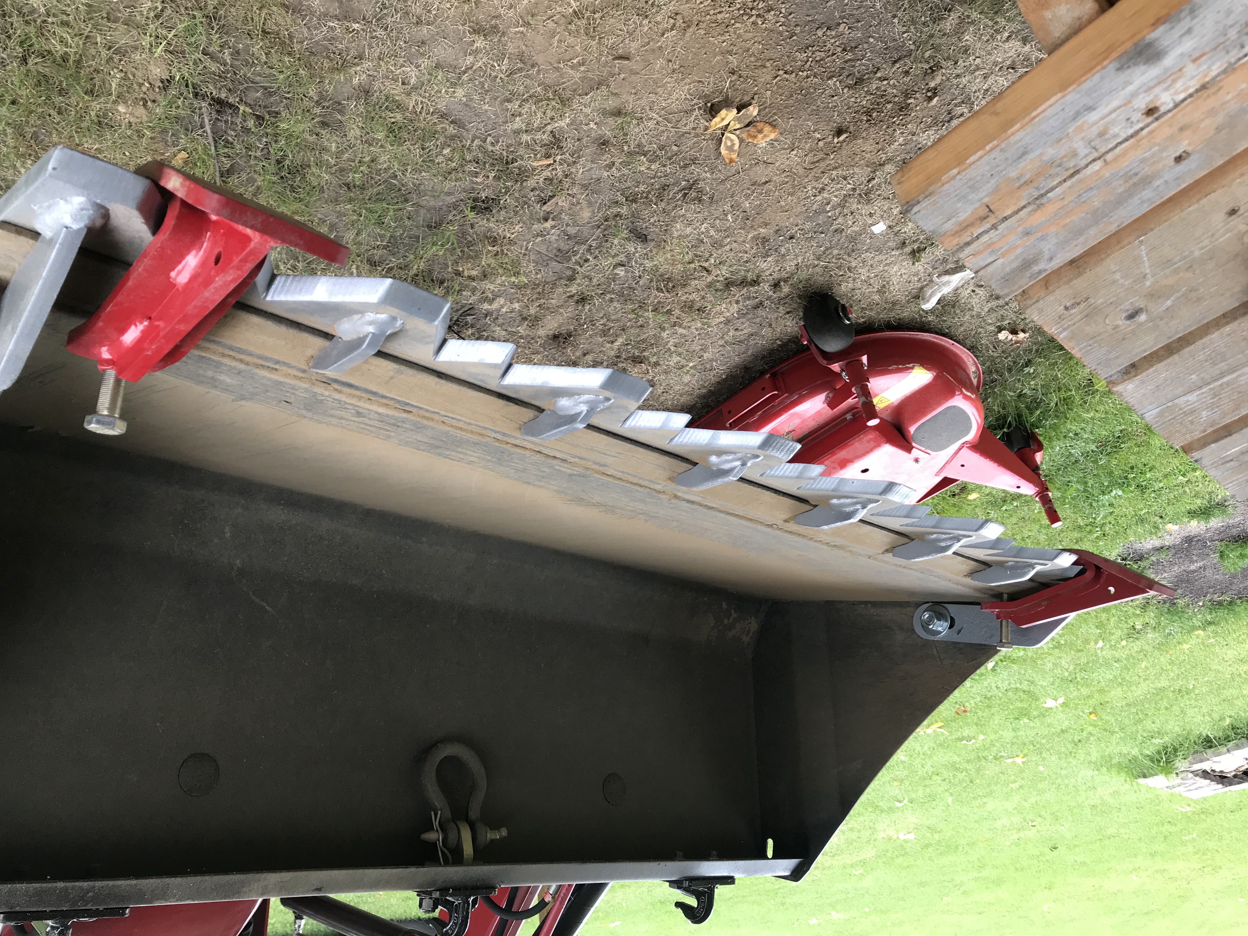

Bar with Edge Tamers on it.

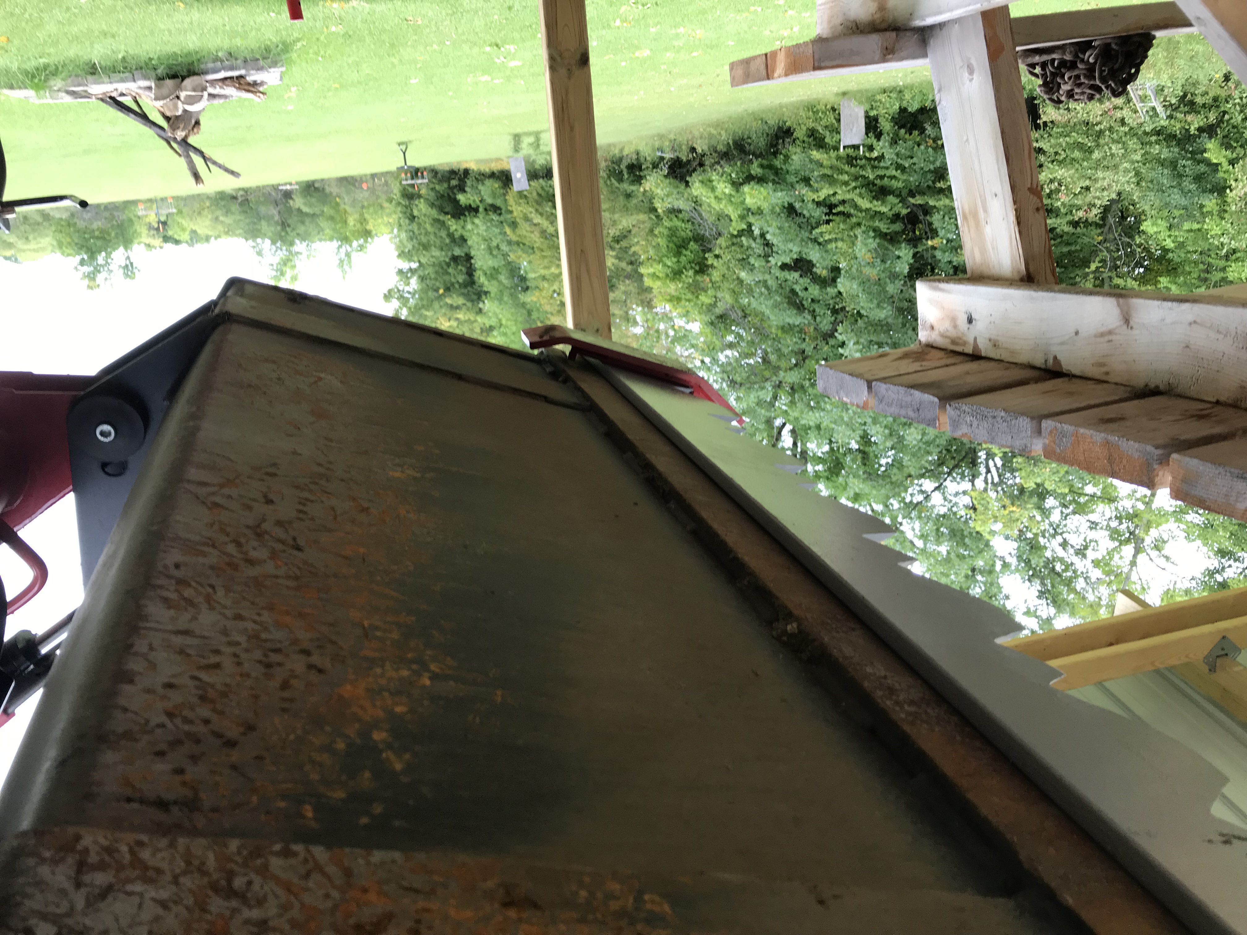

A look under bucket.

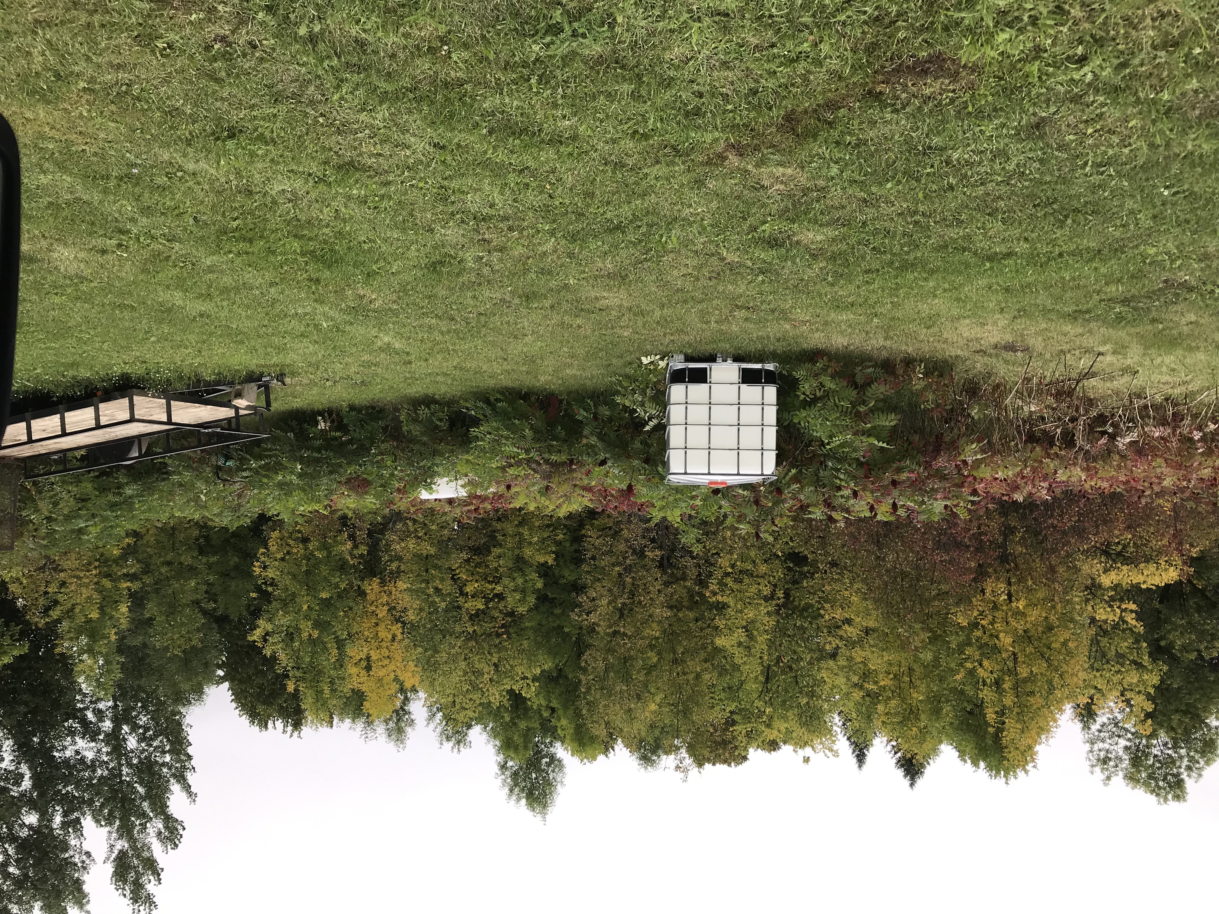

The patch of brush I want to knock down, you can see the left where I tried it with bucket only last week.

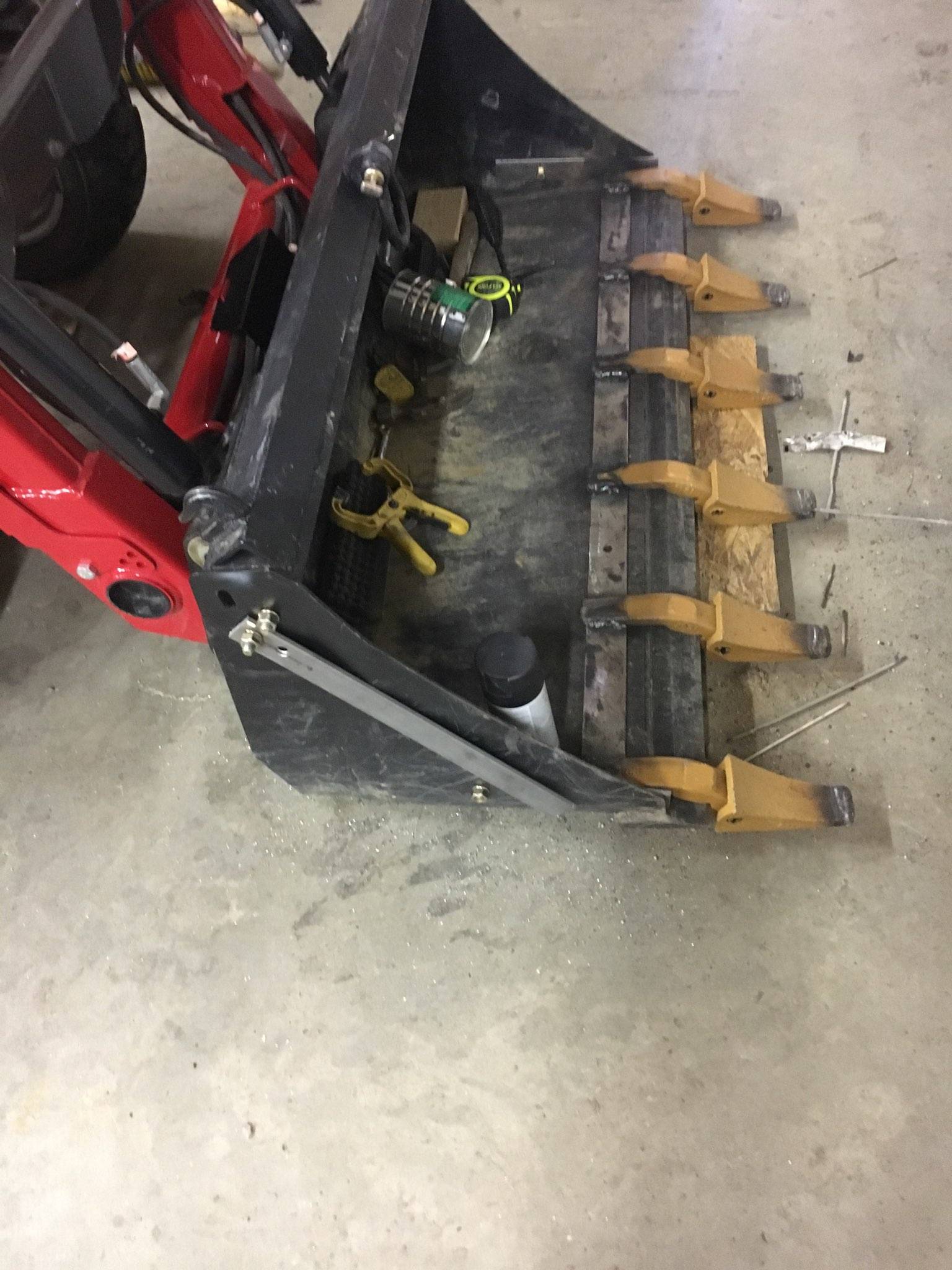

I was about to order a PTB, but I have a lot of rocks. I ended up using real bucket teeth that I made for the tractor. They do make a world of difference.

Why would you install a piranha bar just to throw edge tamers on top of it? I'm confused.
A tooth bar of any variety is an awesome upgrade, though.
   / GC1705 with Piranha bar.
I got the Tamers to keep the teeth/bucket from digging into the ground, I will use the float on the FEL and drive into that heavy thatch and the Tamers will keep the teeth from digging into the ground if there are any dips or high spots plus I can tilt the bucket down to give those Piranha teeth a bit more of a angle to rip into the heavier stems, I will also put the Tamers on when I do snow removal on my gravel driveway if I don’t get my other snow blade set up this year, it’s all trial and error, I used the Tamers when I cleared the weed growth off the crown of my driveway and they worked perfectly when I had the FEL in float, I have very little standing water on my 300 foot gravel driveway after heavy rains.

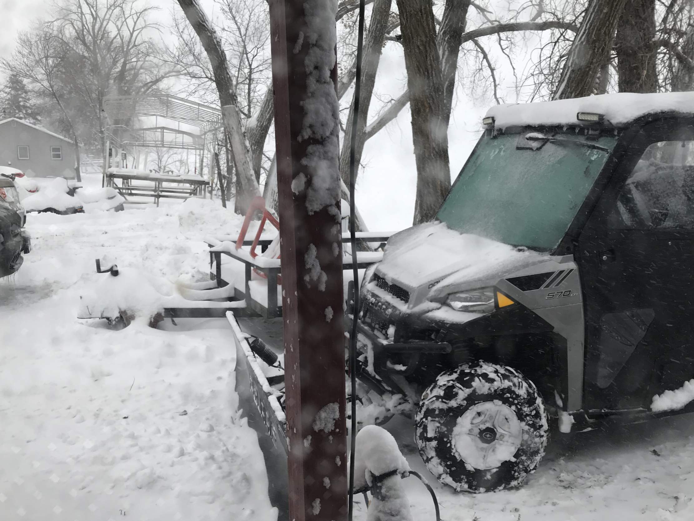

Those Tamers have a place but I just need to find out where they work and do not work, when I moved my 12 yards of class 5 gravel I did not have the Tamers on because I did some back dragging with the bucket in float and the Tamers would of got in the way, I feel they will work best for me in the winter when moving snow so I don’t dig up gravel or tear out chunks of grass, I have a paved driveway at my home and my Ranger UTV with a 60 inch snow blade works great there.

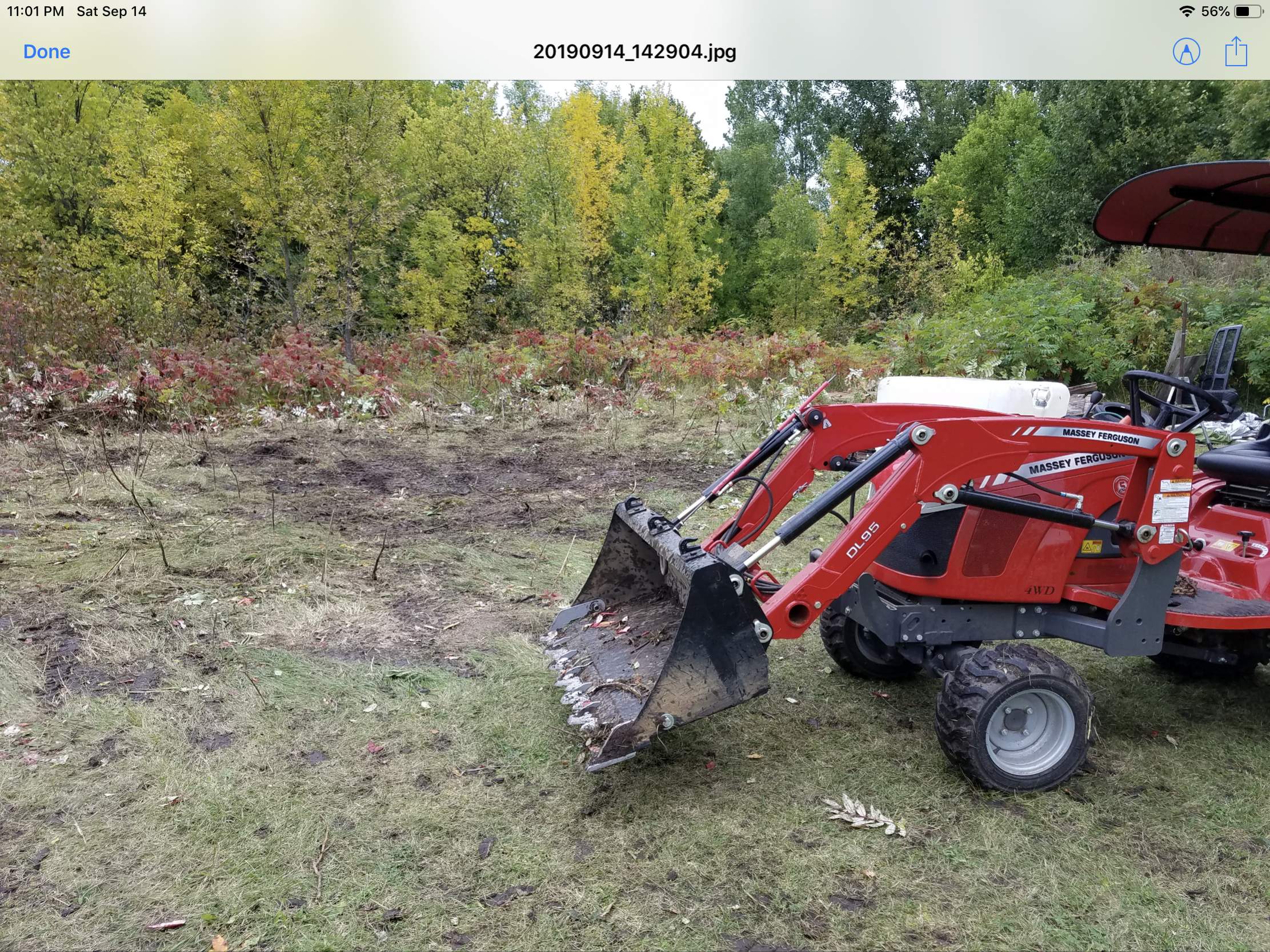

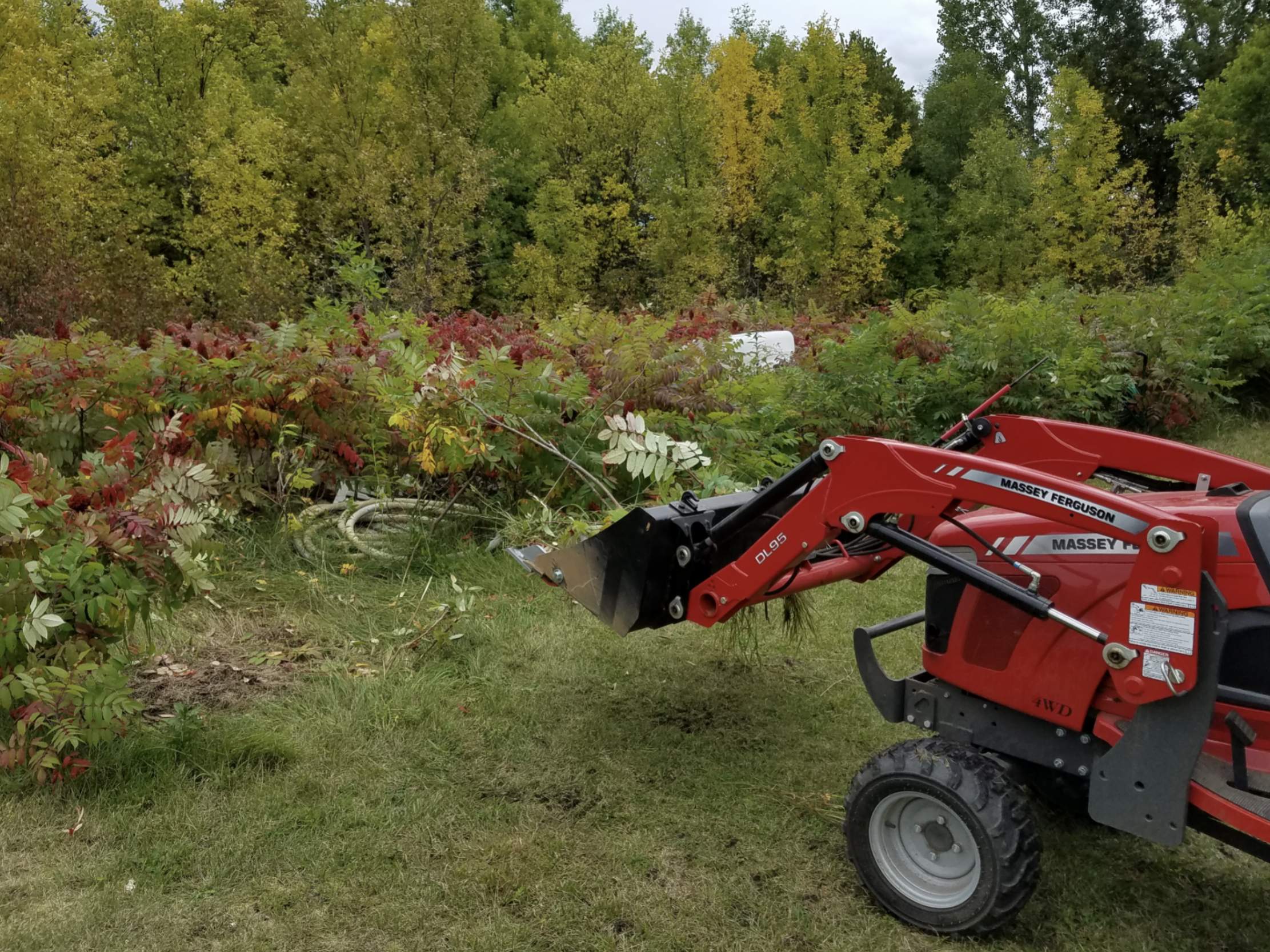

Put the Piranha bar to work. Started to rain again so I stopped for the day, I have about a 40x30 foot area to go.

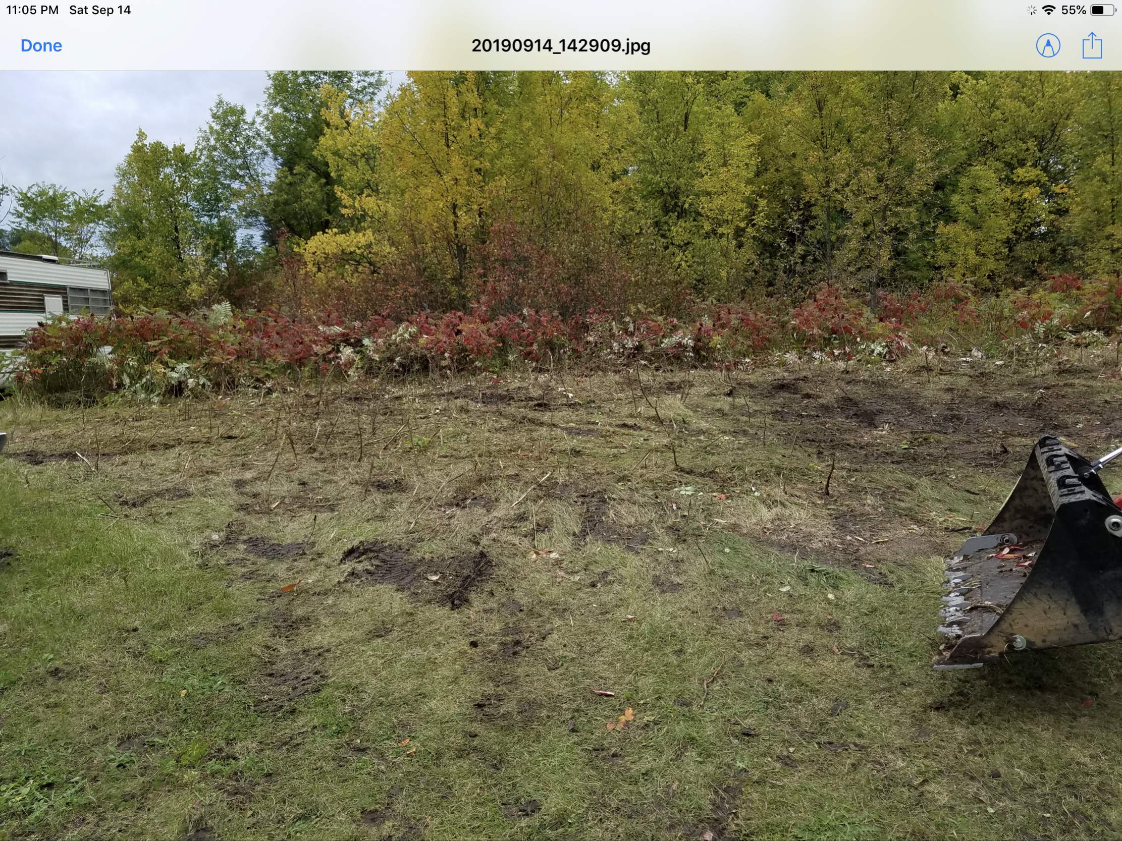

Well i opened up another 30x30 foot area so now I have a basic area for my 30x45 shop when I build it, still need to do a lot of dirt work and get that Sumac cleared out better, the ground is really uneven so it is hard to scrape the top even, what I will need to do is use the box blade and drop the scarifiers down so I can rip the ground up so I can get I level, it will be a lot of work with the scut but I have nothing but time so that’s ok, a CUT would be a lot better for what i am doing but this was not in my plans when I bought my tractor.
