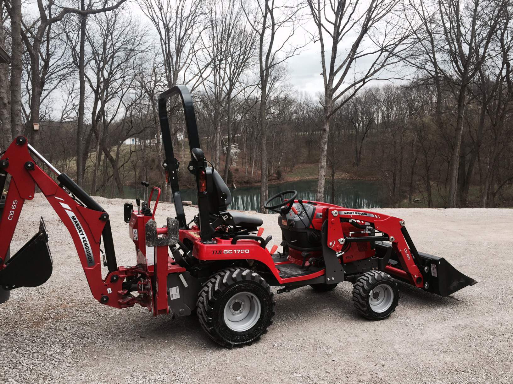

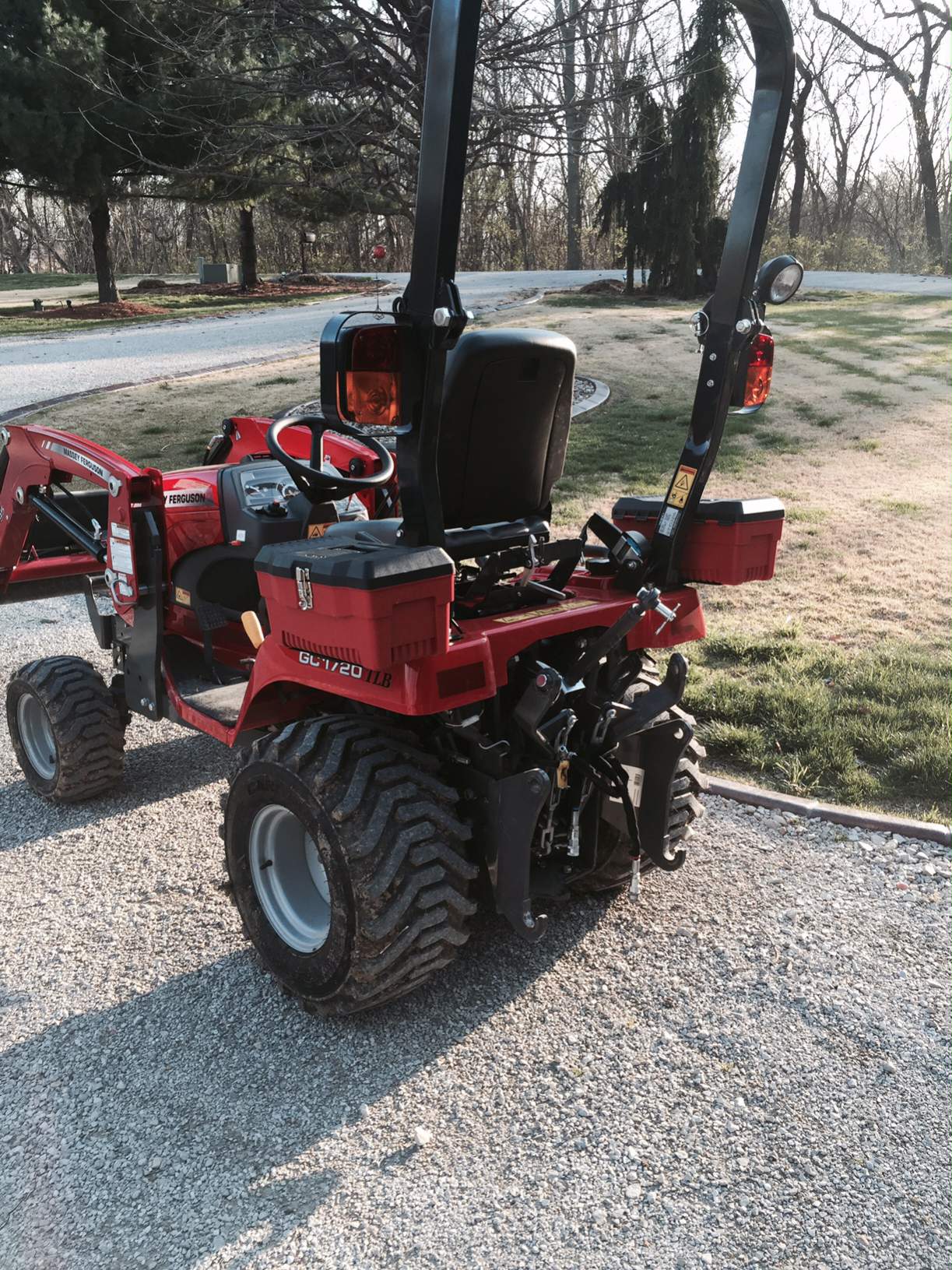

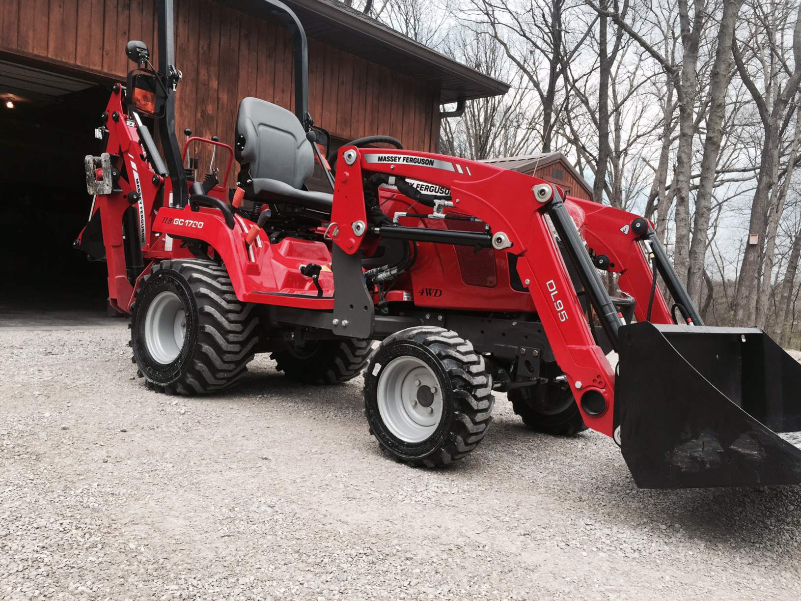

I just got up my new 2015 GC1720 last week, I got the unit with the DL95 loader and CB65 backhoe. It been raining here since I've got it but I did get to play some with it. I made some brackets that bolt on to the ROPS mounting plate for a tool box on each side.....the boxes stay in place with heavy duty Velcro, works great. I also installed a piranha tooth bar and I just found out they offer a factory mech.thumb for the hoe ($400.00) I paid 18,000 delivered with the back tires liquid filled...I also got a 10" and 12" bucket for the hoe (the 10" was free since it came with unit) as I ordered it with a 12" but they let me keep the 10:) so far the unit seems very well made, I like how easy the engine compartment is accessed and the all the filters seem easy to get to. I will say it feels like I sit up higher (as compared to JD 1 series) and the unit does seem iffy on a any side hill but, this is my first tractor so maybe I just need some time in the seat......I'm use to my S185 bobcat skidsteer, and this is nothing like that...LOL I opted for the 1720 vs 1710 as there was only about 1200.00 difference in price, from what I know you get, more power+2.5hp, a little more flow 4.6 vs 4.3gpm, a rear work light, metal light guards on the ROPS, nicer curved hydro pedals....that's about it. I am going to add some bro-tek rear wheel spacers, I just haven't decided if I want the 2" or 3" as I do have some hilly areas.
