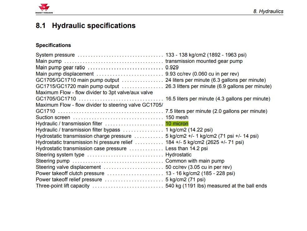

   / GC1715 Blowing hydraulic fluid #75
For what its worth there is one mention of a 10 micron filter in maintance manual.... Anything with a larger micron size would not cause a restriction issue.... Funny thing is I can get a WIX 11 micron filter for a kabota the will fit my GC1700 series a lot cheaper then the MF filter...
And for what it worth ... Had to order a bit to top up system after hydraulic hose failure...
(sorry about picture quality)

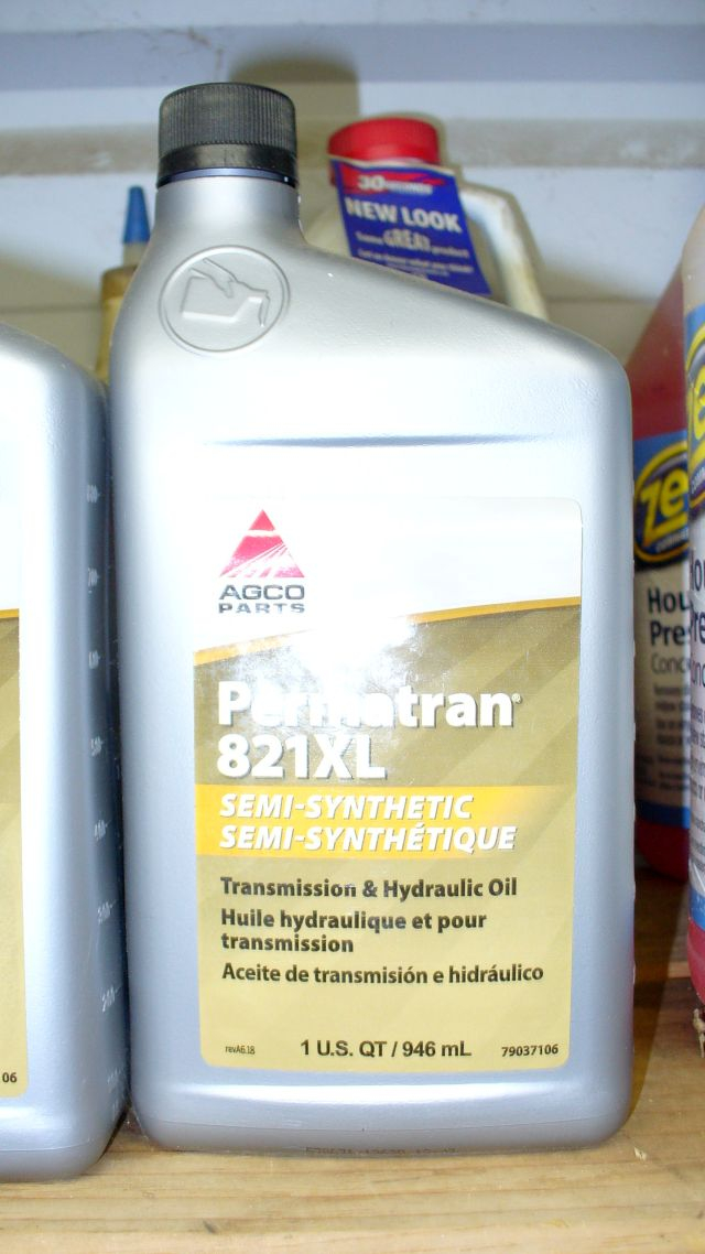

#76
Well it did it again today so back to the drawing board its not the fluid. I put Permatran 821xl fluid in it good for transmission and hydraulic
