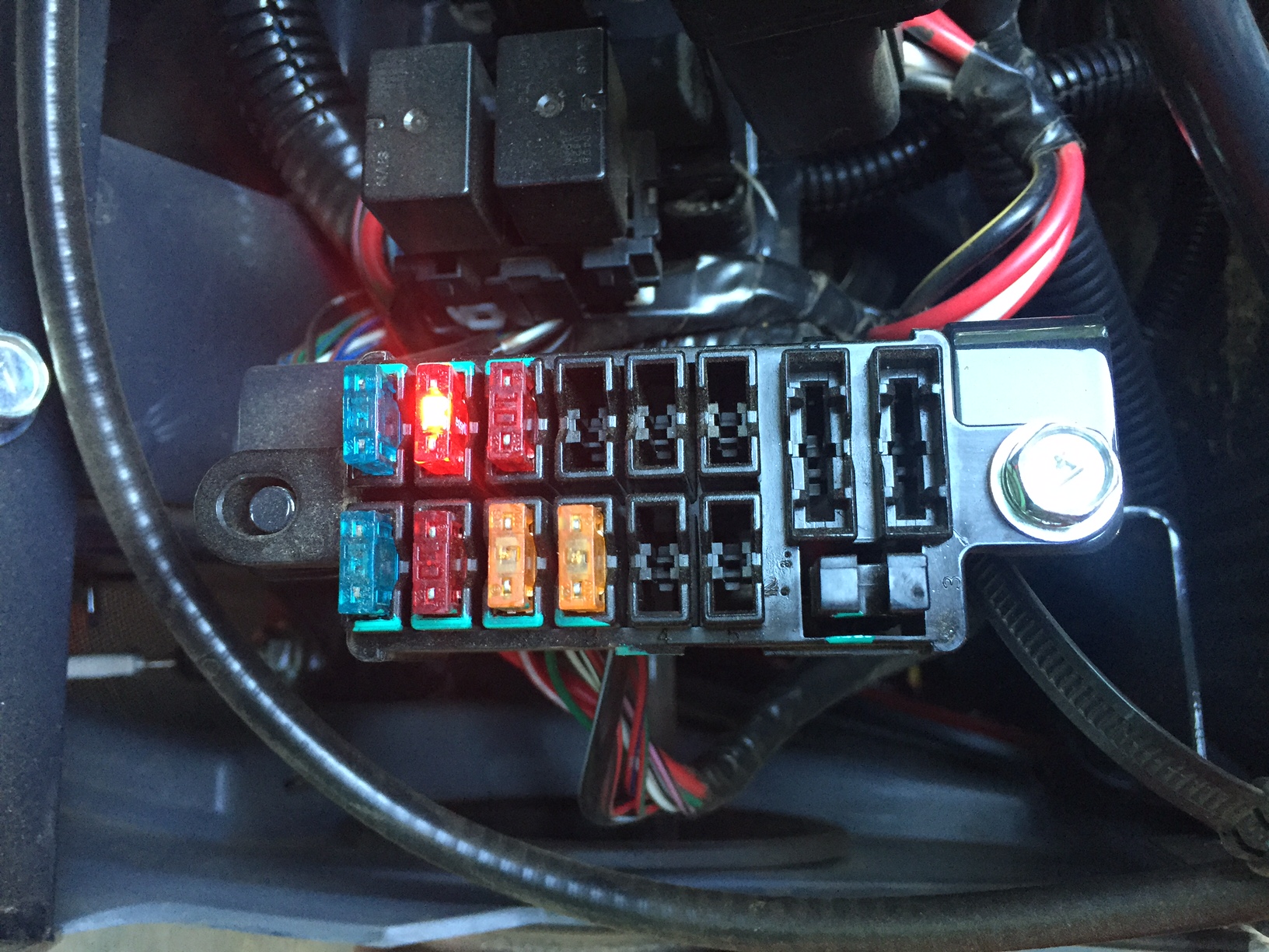

Correct, no starter movement, no gauge movement, glow plug light comes on, lights/flashers work and are bright. Can't for the life of me find my volt meter...have to listen tot he wife tell me how I don't put things back where they belong....

To me, its gotta be electrical, some sort of safety switch or other electrical connection. Have followed all sort of wire all over the place, I don't see anything loose or broken....fuses look good, though it possible I don't know where they all are....

You have to check all the fuses, on a 2300 series there are 6. Two are in line. All are inside the dash. You may have more on yours.
There have been a few GC's who have had a wire break off the back of the ignition switch. It's extremely difficult to look in there. But, look for a wire that is unattached.
The next thing you can do, is unplug your safety switches, (they are on the seat, and control levers). Check them, one at a time. Try cranking, with them unplugged, and jumpered. That way, if they are normally open, or normally closed, you are covered.

I found it... It was a fuse. Made a nice clean break, hard to notice, I obviously missed it during the first inspection. Replaced it and she fired right up.

Well now starts the interesting part. You've found the "result" and cleared it. But now the question is . . what is "the cause" ? Obviously fuses don't blow for no reason.
What circuit was the fuse for that it would stop the unit dead while running ?
Had there been any exceptional jarring of the machine that could have triggered a flex in the fuse box area or some loose wire coming in contact with a ground or another wire?
Had any thing recently been added or adjusted that was electrically oriented?
Obviously replacing a fuse is simple and inexpensive . . but you don't want your tractor killing at an inopportune time . . Like on a slope/steep hill or full bucket in the air etc..

The one that was blown was a 10amp. I think your 1715 has the same fuse block with 7 fuses it in. It was the middle one on the side with 3 fuses. Not sure what it powers. I've done no modifications or adjustments. Just enjoying the seat time, filling up the fuel, and lubing zerks, etc....Nothing that I would consider especially harsh either.
I'll mention it to the dealer when I am up there to get part for my service, but otherwise will just monitor the situation.....

Glad to see you found the found the problem. Although fuses are supposed to "pop" to protect circuits, I have seen fuses die (at the assembly point at one end or the other) from what I expect are due to being jarred like they get on these tractors. This is especially true of low current fuses. Of course I wouldn't just assume they "wore out" but a fuse that died doing it's job might show some melting.

Popped the fuse again...
After I replaced the fuse, I really just dove around the yard and put the tractor to bed. Decided to mow today. Usually takes about an hour, maybe a little less. Got about 30 minutes into it and she died, same fuse. I replaced it, started the tractor back up, and it didn't even last a minute. I'm gonna wait about a half hour and make this post, let everything cool off, then try it again an see if I can at least finish the lawn.
Anyone know what this fuse powers?
