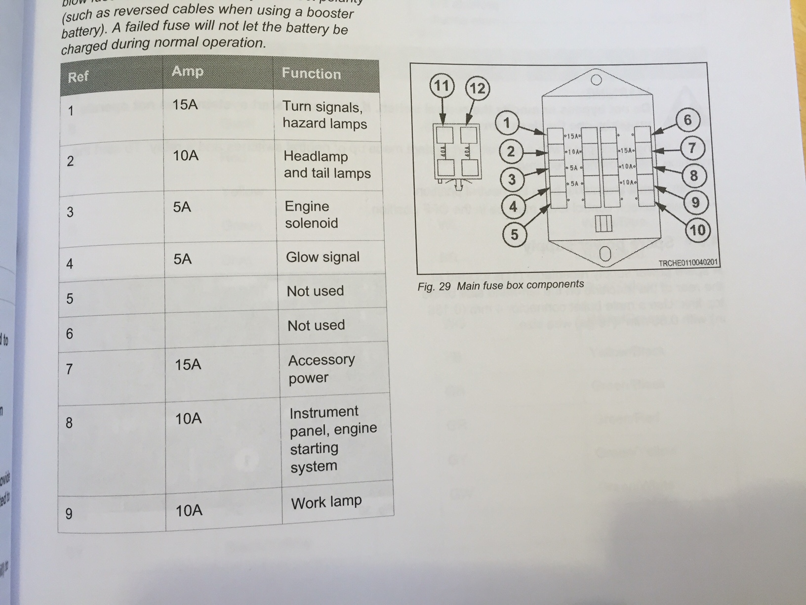

Looks like fuse#8, Instrument panel, engine starting system.

If that is the case . . Could there be a loose key switch or small short in the key switch so that arbitrarily the starter is trigger while its running and that triggers a very sudden resistance and fuse blow.

You'd have to isolate everything on the schematic for that fuse, and test it, cold, and hot.

Because it is erratic . . It could be a cracked fuse block too. But at this point there is no reason to believe it isn't an easy fix either. It came quickly . . And it could be working by Saturday. If that fuse is for the starter circuit . . What's on that circuit . . Glow plugs ? Dash panel ? Starter ? All tied together by the key switch.
Question: the 1st fuse blown you said was a very fine clean break . . No blow indications. So what about fuse 2 an fuse 3 . . same type of appearance ? Or was it indications of flash blow ?
My point is . . Evaluating details is a key to troubleshooting problems and to often people want to "guess". My career has been about following the clues. So if you tell the dealer the exact clues . . then their service tech can be far better focused and much more likely to find quick success :)
1. Erratic pattern when unit is effected.
2. Always the same fuse.
3. Kills while running
4. Physical Condition of each blown fuse
5. Specific circuit that blows is the circuit controlled by ignition key.
Is there a 6. and a 7. ???

Talked with the dealer. They asked a bunch of information about the operating conditions when the fuse blew. Asked what type of fuel I was running. Said they had a guy running a bio diesel that lead to some sort of problem with the fuel pump, which they said is on the same fuse. Other than that, look for lose wires, chewed or frayed wires, etc. Nothing jumped out at them as a known problem.

If you know what is connected...rather than ripping up the hardness...maybe start at each unit attached. Starter terminals and wires, fuel pump terminals and wires, etc and work back from there. Fuel pump is immediately under your seat on top of the tank I believe so maybe make sure nothing is jumping around on top there crossing a circuit
