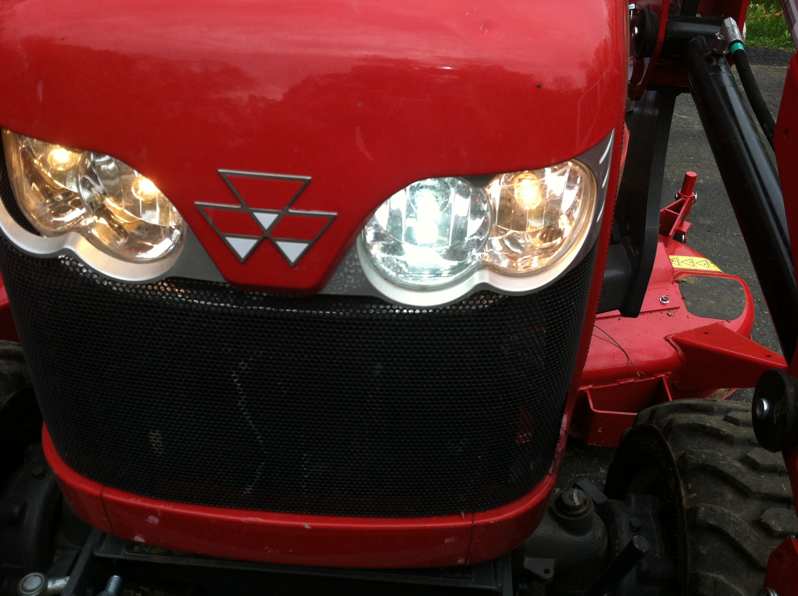

the picture of the headlights
Four of these make up the extent of my stock forward lighting. The LED mounted on my ROPS far, far, outshines these little candle sticks. Hope your LED replacements work out, I'll be interested in getting some too.

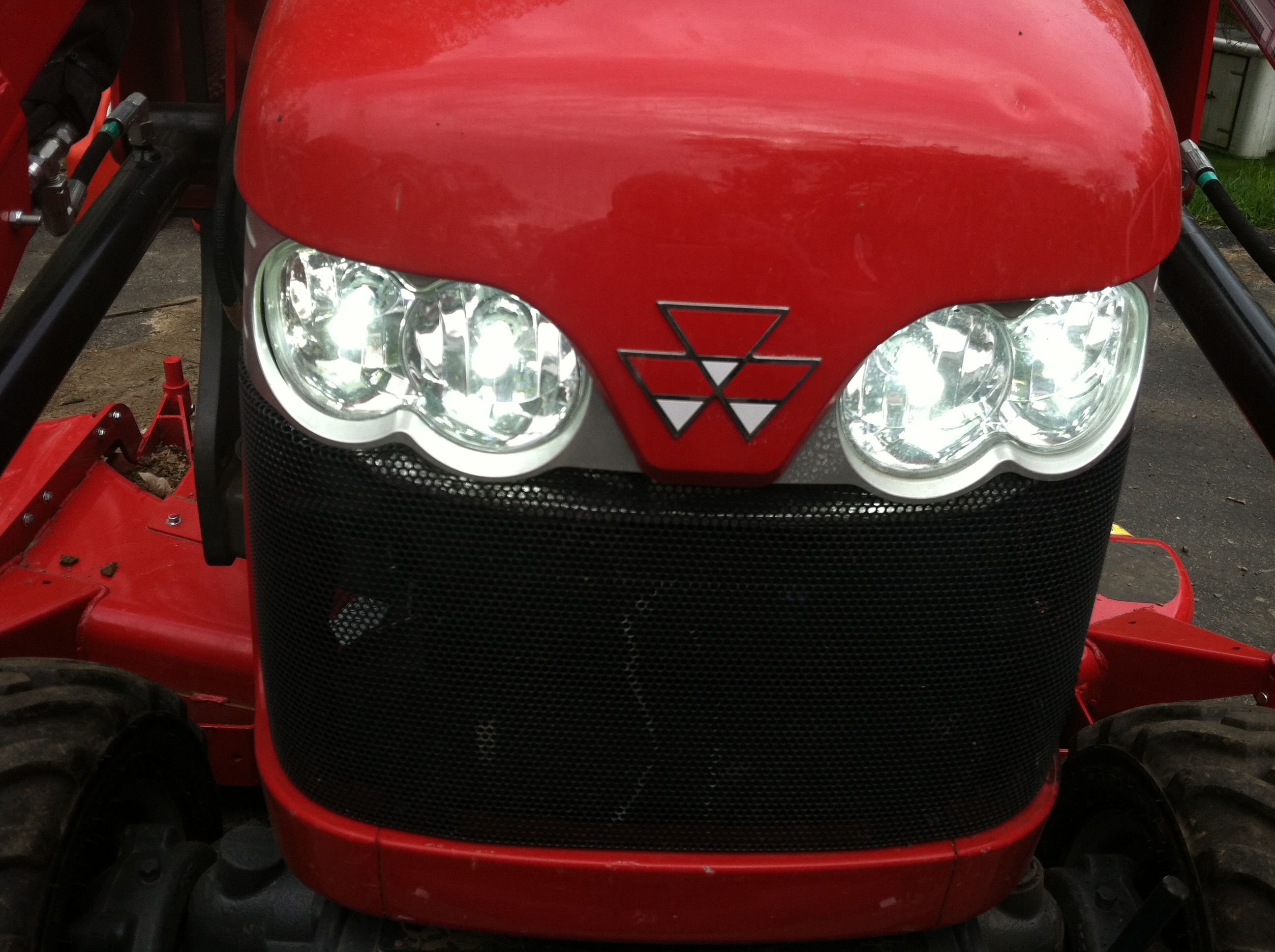

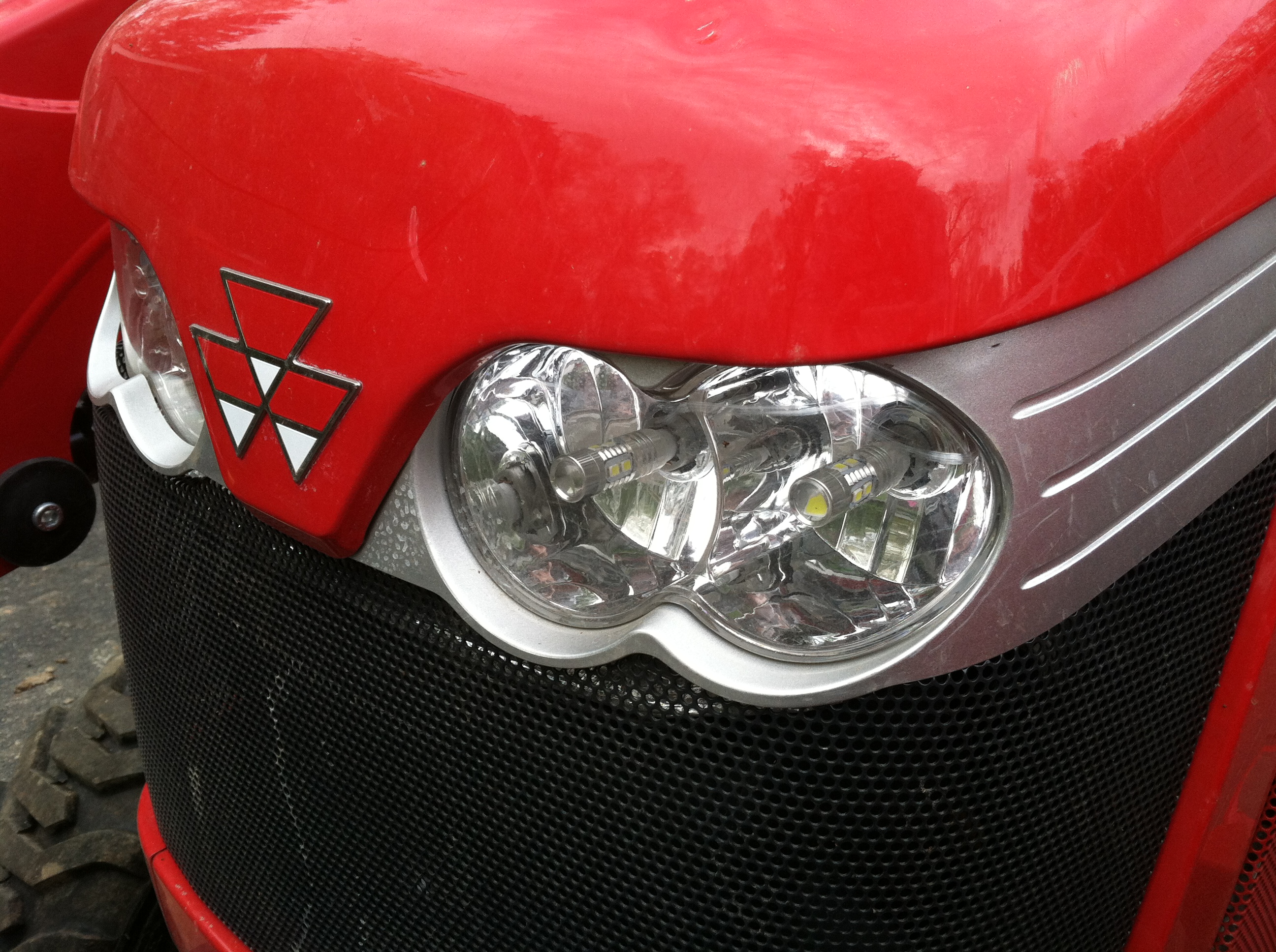

Well got my led light bulns tody and they fit perfect. Wasnt dark out but took some pictures. Ill take some pixtures of them at night also.
4 bulbs 30 bucks. If they are 2-3 times brighter then stock im happy. Will do some night testing and let you guys know.
