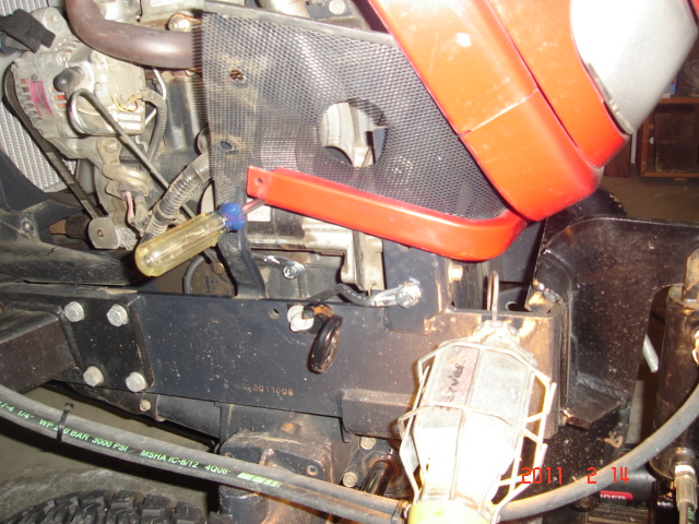

Hi everyone. I'm new here and have seen a lot of good advice already. I'm looking to see if anyone would know what the starter draw should be for my GC2300. It's pulling about 270amps right now. Crnks slow and won't start without a jump. New battery already installed.
Brian

Hi Fred, the ground strap is on the left side right behind the radiator. It bolts upto the engine block below the freeze plugs, and then to the frame behind the body pannel. It's about 17mm wide and 2mm thick. Held on with 10mm bolts with 14mm hex heads on them. Hope this helps you out.
Brian

Here's the ground strap, just beneath the grille-type material on the front right side.
I can attest to the fact that even a partially broken strap --several of the strands-- will slow down the starter noticeably. After I replaced mine (which finally did break), the tractor started like it did when it was new; it had been a bit slow. There were a few model years where that strap was just a bit too short on the 2300/2310s, and the normal vibration would eventually take it out.

Oops...:ashamed: that picture is of the extra ground strap I added! The original is on the left side, as was noted above.
I put the extra one on just for insurance; the day mine finally broke and the tractor wouldn't start was (of course!) in the middle of a heavy snowstorm when I really needed it- don't want to go through that again!

Thank you irvingj, I'm going to add the second strap to mine as you did. I have the starter out at a rebuild shop and the bench tested it. It was pulling 25amps with no load on it which they said was too high. I'll pick it back up today and reinstall it and post the results.
