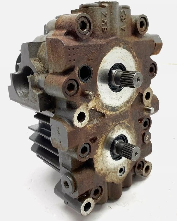

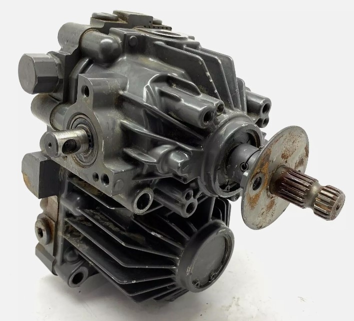

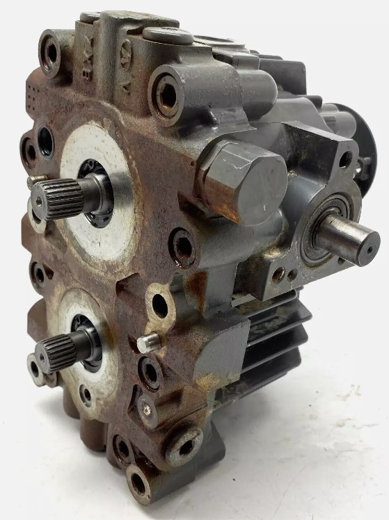

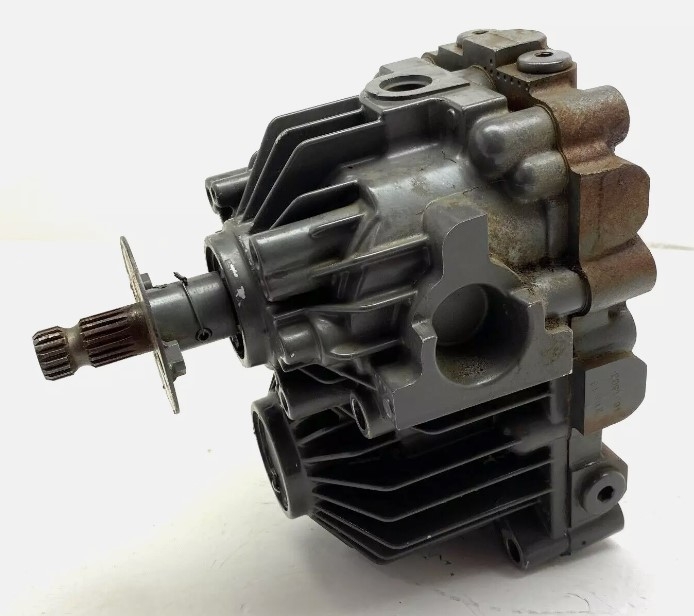

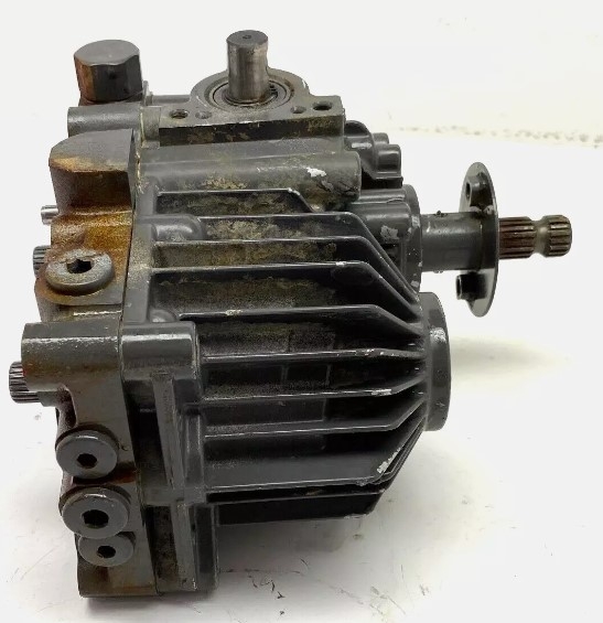

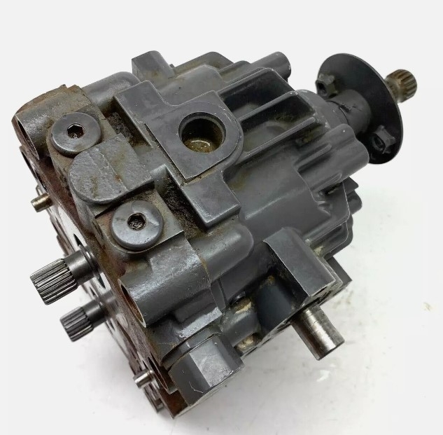

Here's some photos from an eBay listing:
Screenshot 2024-11-21 223313.jpgScreenshot 2024-11-21 223332.jpgScreenshot 2024-11-21 223351.jpgScreenshot 2024-11-21 223409.jpgScreenshot 2024-11-21 223427.jpgScreenshot 2024-11-21 223452.jpg

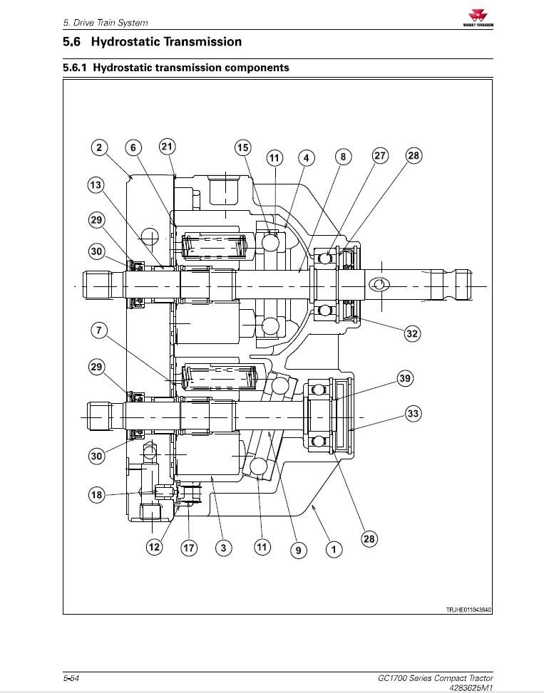

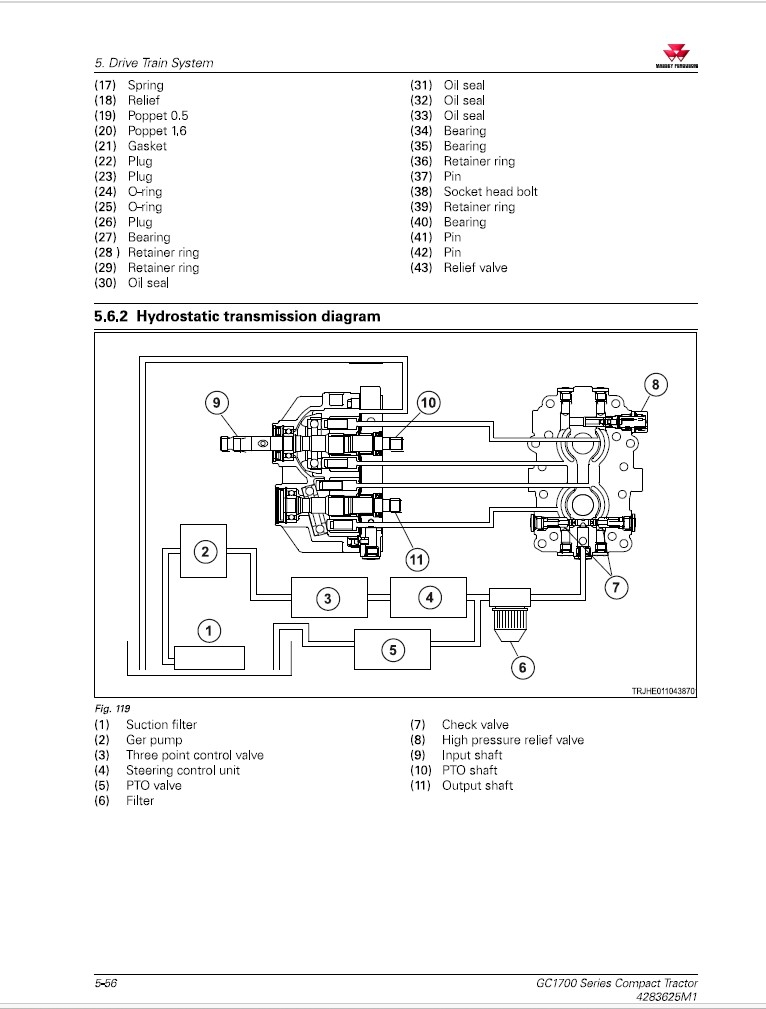

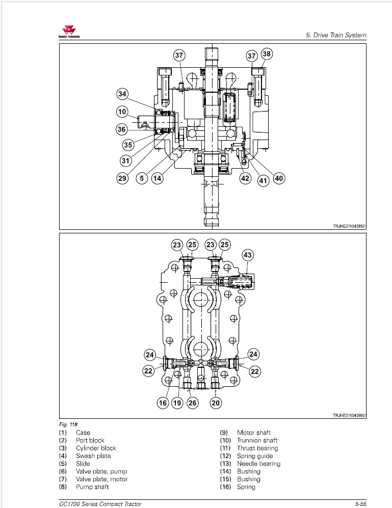

Here's some pages from the service manual:
Screenshot 2026-04-01 141458.jpgScreenshot 2026-04-01 141531.jpgScreenshot 2026-04-01 141608.jpg
Good luck. My guess is that it is some of those ports at the bottom. Be careful: there are balls and springs in some!

No! There is the hydrostatic transmission (HST) itself and then a plate between it and the main transmission that is perhaps 1-1/4" thick; the plate is shown in the photos. It is all the ports/plugs in this plate that are suspect, especially those at/near the bottom. The plugs might be something like a BSPP thread, but the hex sockets in them are likely metric. And I think you might be able to get to those plugs without removing the HST.
If you did have to take the HST apart, yes, it might not be unlike heart surgery, and probably something a dealer should do. : (

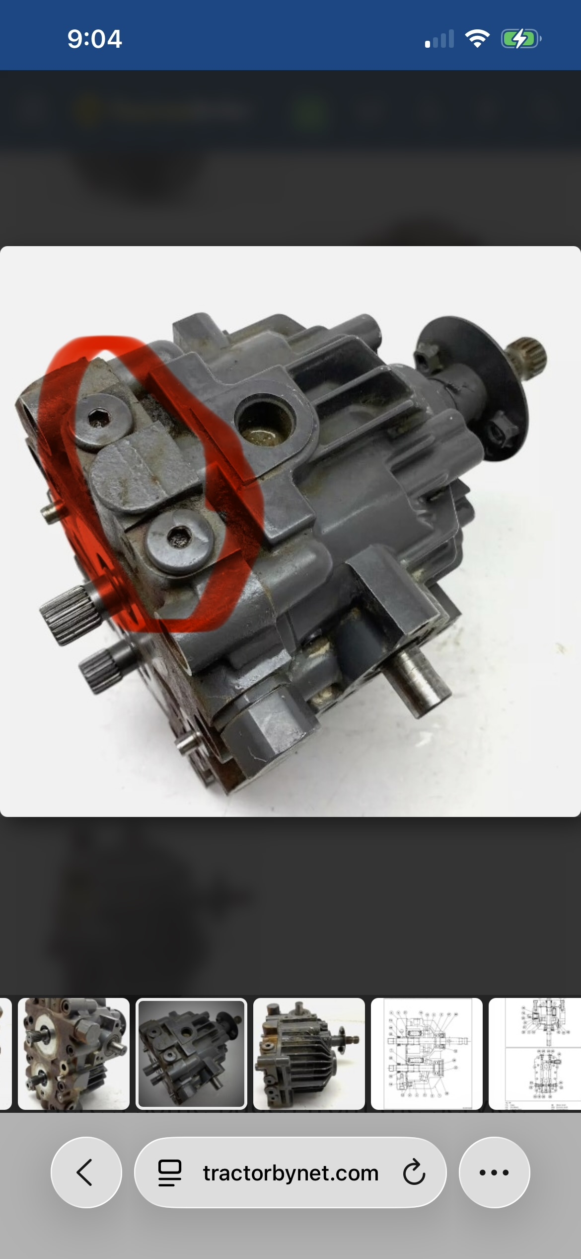

These would be the plugs we are talking about?
/ GC2300 hydrostatic issue #30

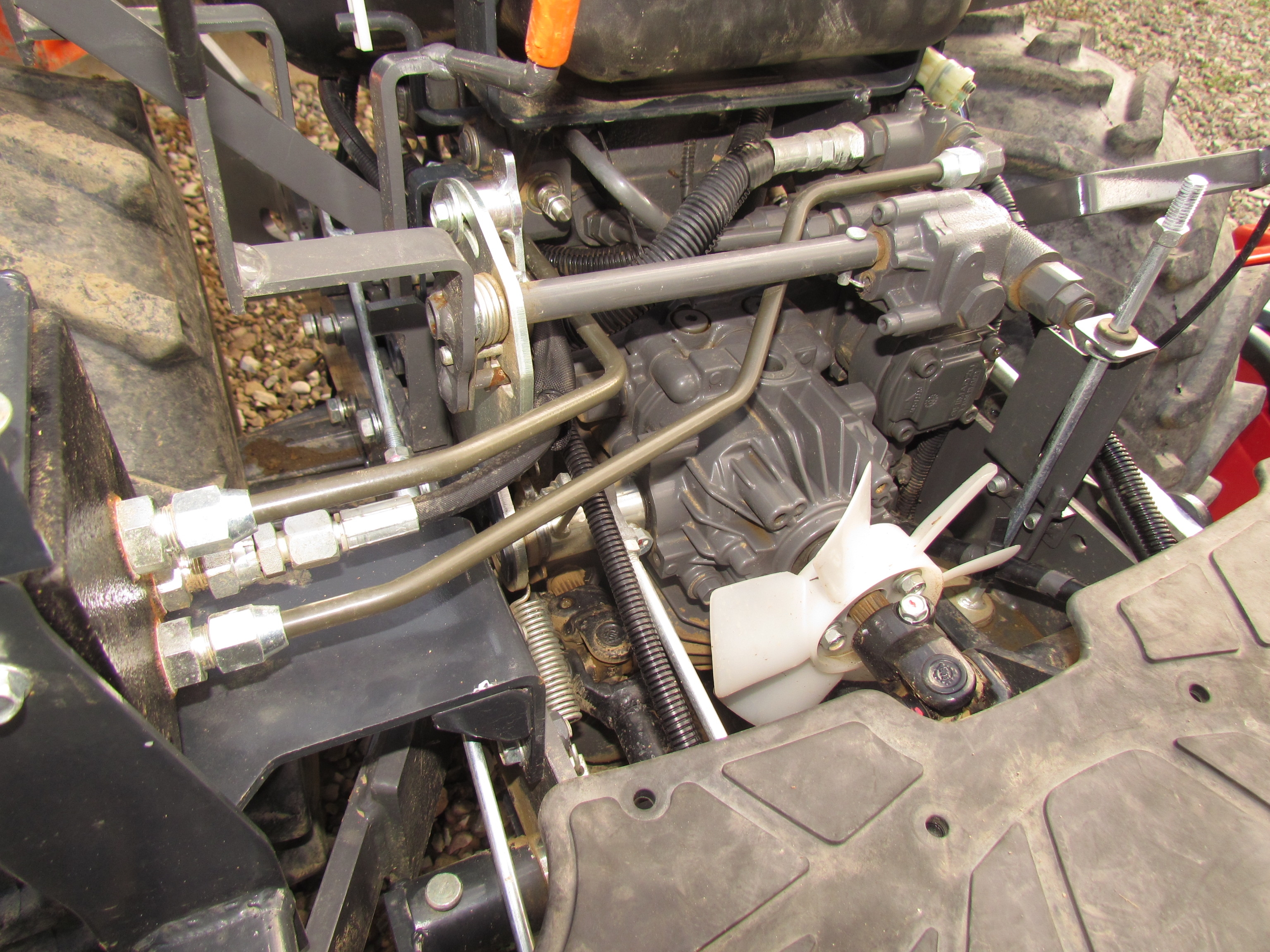

No, I think those are the #23 plugs on the top as shown on the 2nd service manual page. You need to get to the #22 plugs on the sides near the bottom, and the plugs by the numbers 20 & 26, and possibly the #43 relief valve on the upper right side. Most of these are shown on the last photo.
Edit: Just had a peek under mine and it isn't going to be easy. Hard to tell on mine because I have some skid shields under the area, but it looks like the oil filter for one thing is in the way.
I don't think the service manual discusses this, but if you can't take the plugs out in-situ, I think that you could pull the HST without pulling the entire transmission/transaxle out. See photo:

So, you found that you could remove the HST alone? Many photos would be appreciated!

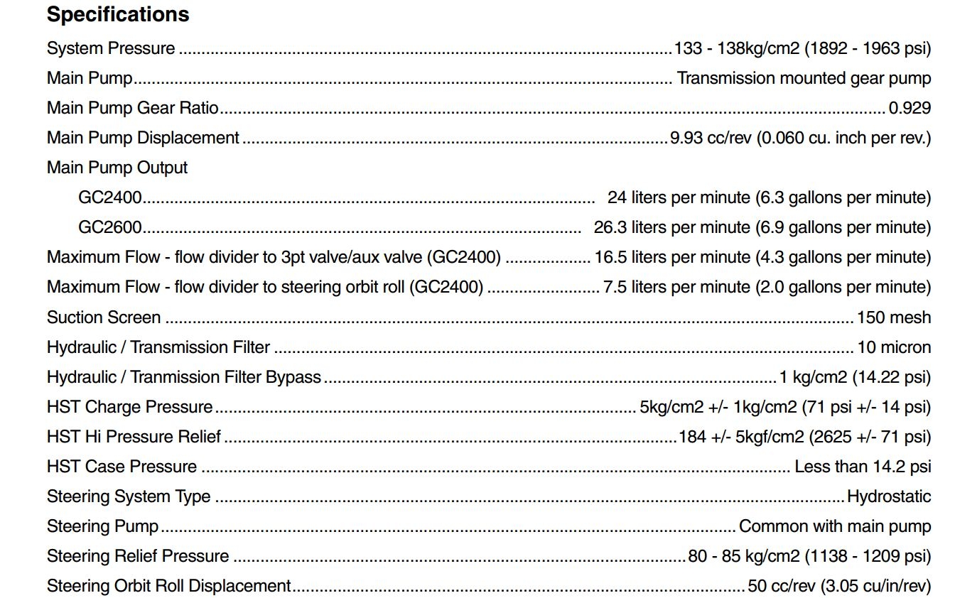

Let's go back to basics: what works (power steering, loader, 3-point, backhoe) and what doesn't? When does this happen (hot or cold)? What noises does it make? Real basics: does it have enough hydraulic fluid? Is the intake suction filter clean? Are there any leaks on the suction hose/pipe?
If you are having trouble with multiple functions, it could be the main pressure relief valve located on what Massey Ferguson calls the "control valve" (which consists of a "flow divider and relief section" and a "3-point valve section" - my terms). The control valve is located in the upper right of the photo I attached in post #30.
Have you looked at my long (boring?) post on the hydraulic system: https://www.tractorbynet.com/forums...-gc-1723-1725-hydraulics-are-plumbed.476917/?
Edit: what hydraulic fluid are you using, factory OEM or ???
