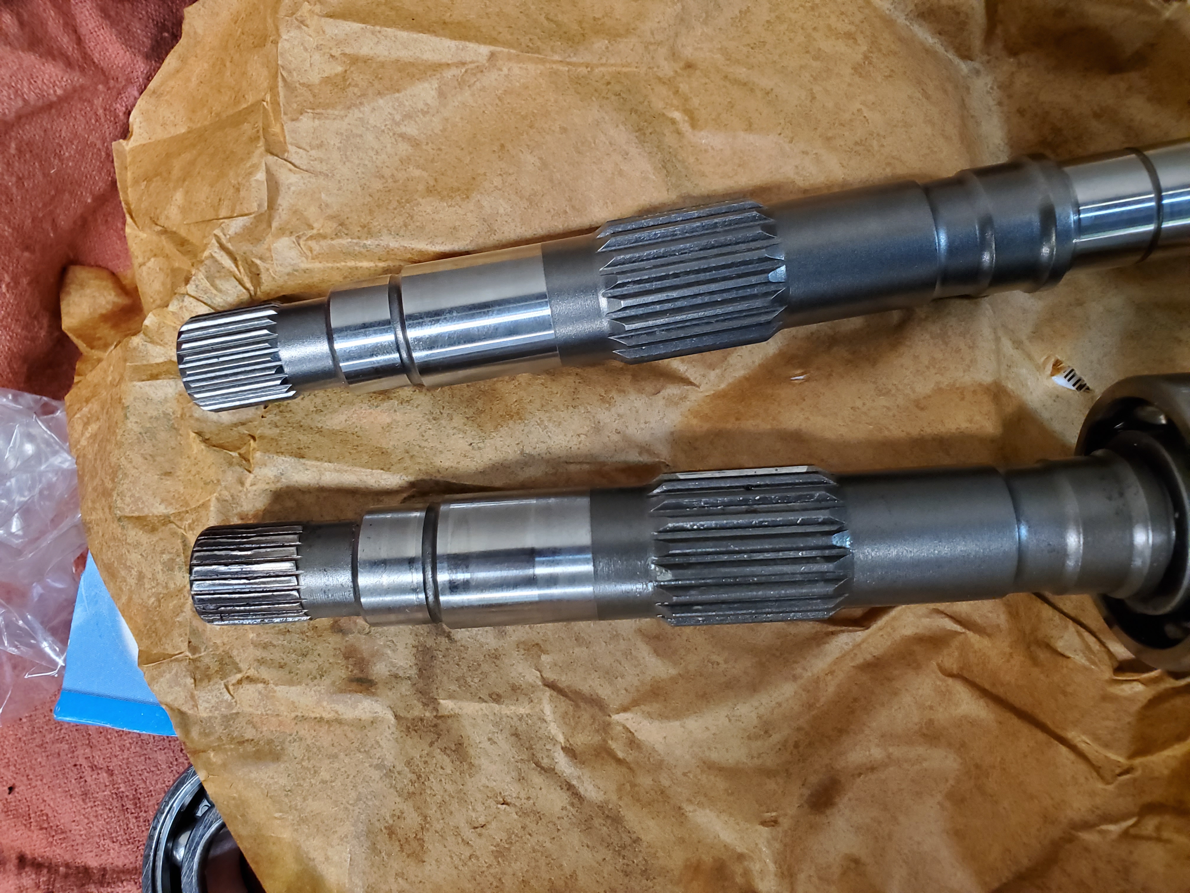

Sep 29, 2019 / gc2300 no hydraulics.. ball bearing Thread Starter #12 OP E earndale Member Joined Oct 21, 2012 Messages 35 Location oswego new york Tractor mf gc2300 new shaft against old going to try get together in next week will give update
Sep 29, 2019 / gc2300 no hydraulics.. ball bearing Thread Starter #13 OP E earndale Member Joined Oct 21, 2012 Messages 35 Location oswego new york Tractor mf gc2300 old against new
Sep 29, 2019 / gc2300 no hydraulics.. ball bearing Thread Starter #14 OP E earndale Member Joined Oct 21, 2012 Messages 35 Location oswego new york Tractor mf gc2300 old against new look at slines
Sep 29, 2019 / gc2300 no hydraulics.. ball bearing #15 K KWentling Veteran Member Joined Jun 22, 2002 Messages 1,182 Location Rozet, Wyoming Tractor Kubota BX22, Kubota ZD21, Kubota M7060 The new shaft is different than the old. The center splines are located a little different and the bearing shoulder is also in a different location.
Sep 30, 2019 / gc2300 no hydraulics.. ball bearing #16 irvingj Elite Member Joined Feb 3, 2008 Messages 3,574 Location Etna, NH Tractor 2007 MF GC2310 TLB earndale-- are the shafts really different, or is it just camera distortion? How do they compare when placed precisely side by side?
Sep 30, 2019 / gc2300 no hydraulics.. ball bearing Thread Starter #17 OP E earndale Member Joined Oct 21, 2012 Messages 35 Location oswego new york Tractor mf gc2300 they are the same just wanted you to see the wear on old shaft end to new one the bearing still on old shaft i replaced it
Sep 30, 2019 / gc2300 no hydraulics.. ball bearing #18 DMW Platinum Member Joined Apr 22, 2006 Messages 718 Location Southern Ontario Tractor MF GC2300 Thank you for posting the pictures. How many hours are on the GC? and what type of hydro oil were you using?
Sep 30, 2019 / gc2300 no hydraulics.. ball bearing Thread Starter #19 OP E earndale Member Joined Oct 21, 2012 Messages 35 Location oswego new york Tractor mf gc2300 permatran oil but looking for a compatible oil now.. got a few days before all goes together..hours I will let you know I think 1066hrs
