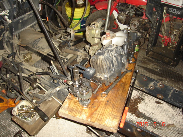

they are the same just wanted you to see the wear on old shaft end to new one
the bearing still on old shaft i replaced it
I guess it scales differently because the bearing on the old shaft holds it up closer to the camera? Sure fooled me.

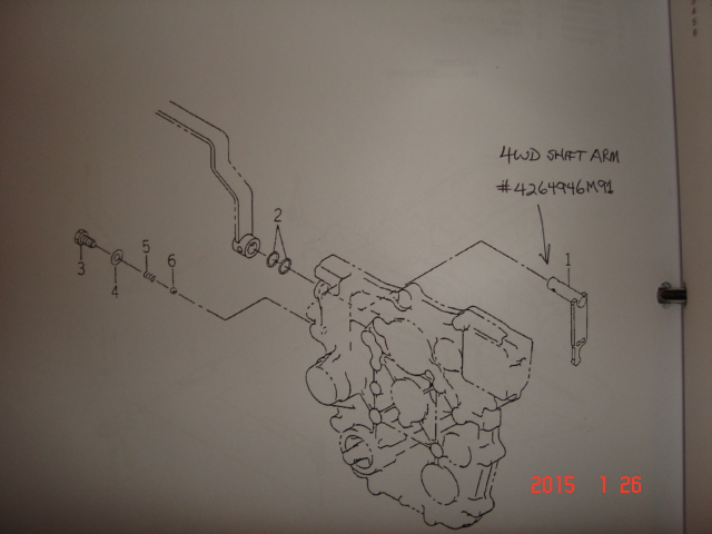

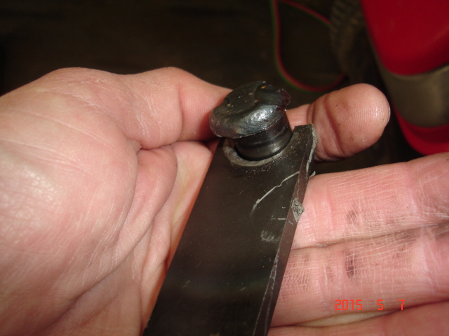

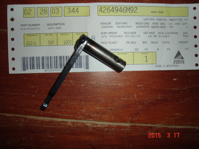

earndale, I feel your pain... and you're braver than I! I had a bad weld on my 4WD shift fork, which broke off with only about 500 hrs on my GC2310. There was an obvious lack of heat penetration on it. (GRRRR!!)
I didn't dare tear the whole thing apart, even though the shift fork was in the tranny cover; the whole tractor had to be torn down and the tranny removed & rotated before removing the cover, to keep all the shafts & bearings in place -- which I'm sure you've discovered.
So it cost me about $1200 to replace a $35 part... Seems I saw that ball & spring in there, too -- it's used for detents on the 4WD shift lever, IIRC.
Good luck with your "minor" repair! (Hope my shaft holds up....)

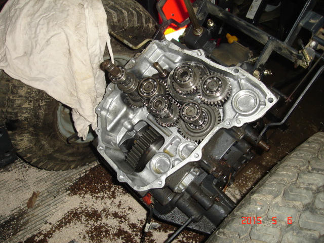

ok good news..all together all hyd. works good yes!!!! sad that one spline shaft runs all gears in trans housing.. poor design... but what can you do spend $15k 10 plus years ago..
but all works good for now lol ….any details you might ask I think I can help....2 times taking apart

I'm in the same boat as you, as far as experience; went through the service manual umpteen times, visualizing the process in my sleep.... but in the end I chickened out and had a local guy who works on tractors for a living do the job. He went through a fair bit of headaches, too, but he got it done.
Still aggravates me that it was a poor weld from the factory to begin with and cost that much to replace such a small part. I'm sure some of these pics will look familiar to earndale. Oh, yeah -- there's his ball bearing, #6 in the 3rd pic.
