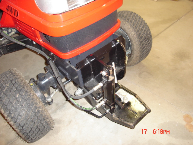

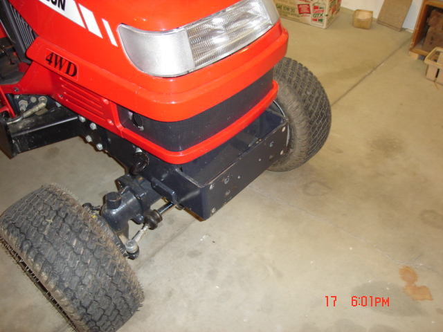

Gave the mower to a freind that needed one. When it comes time - will be asking how to attach front quick hitch to tractor. Thanks.
That's the easy part actually. Just hang it on the front part of the frame and tighten the "T" bolt.
   / GC2300 Snow-blower
#22
I guess i'll have to remove the FEL and grille guard first ....... ?
   / GC2300 Snow-blower #23
Yes. they need removed to hook up the blower.
   / GC2300 Snow-blower #24
Piece o' cake-- four bolts to remove grille guard. As Don said, quick-hitch just hangs on the frame there. The "T" bolt pulls a slab of steel up against the back/underside of the frame to secure it.

HubGC-- The blowers themselves are identical, but the way they attach to their respective Kubota & M-F tractors are quite different.
Other folks have talked about that on this forum (you might try a search), but as I recall, there are big enough differences in the quick-hitch parts (see pics in my post above) that it would be difficult to accomplish. irvingj
