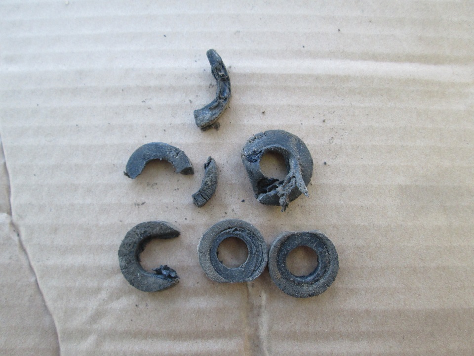

Your approach is what I did. The "motor" moves around a bit but isn't hard to get positioned correctly. Those rubber bushings degraded, almost melted turning into gooey messes.

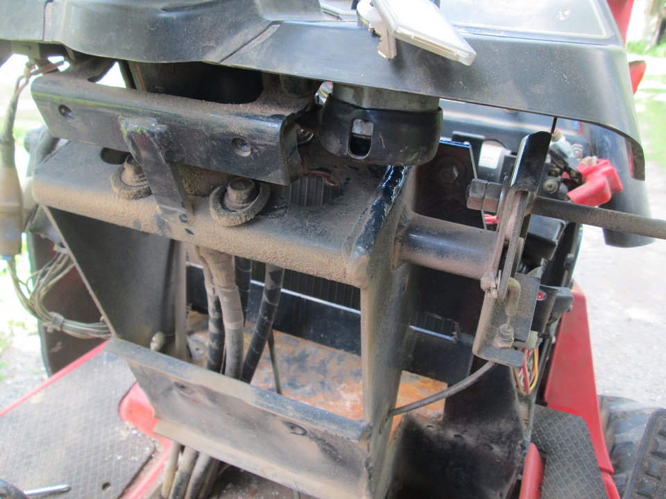

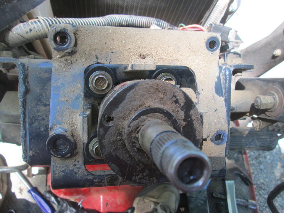

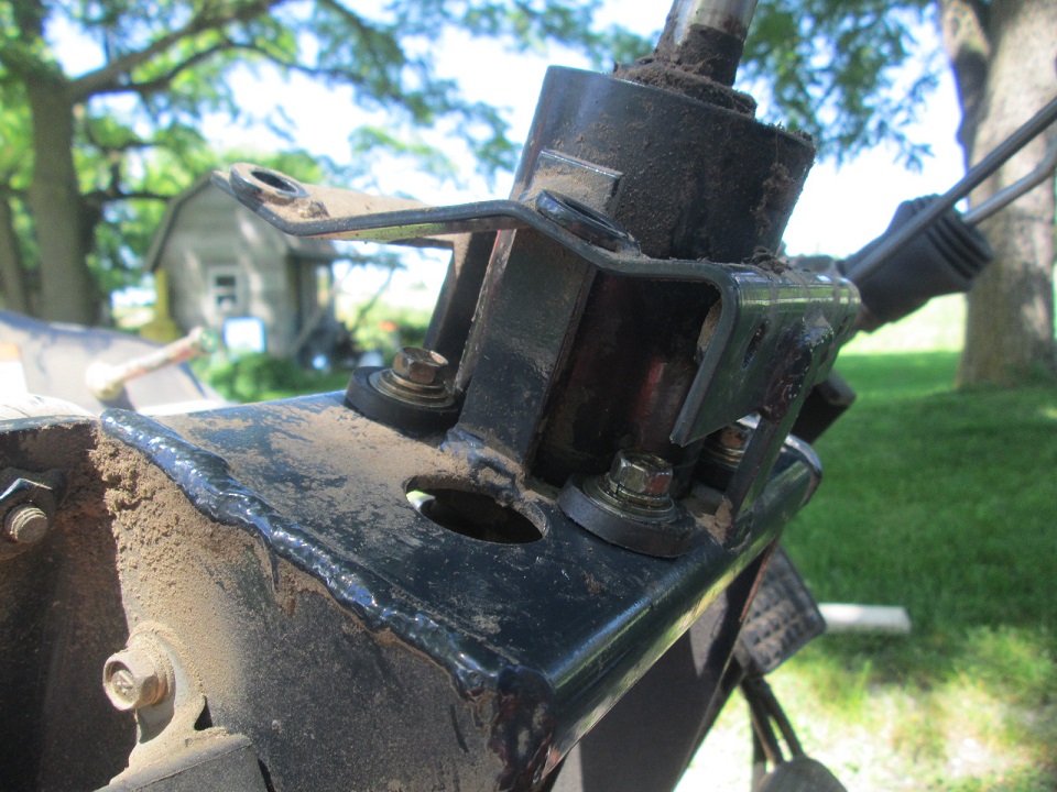

Changed out the steering bushings today. Not a lot left of the old ones. Had to scrape off chunks that had glued themselves on. For me, it was definitely easier to do with the steering wheel removed, and instrument panel swung to the side. Tried w/o removing the steering wheel. Fiddled blindly for a 1/2 hour trying to replace a bushing. Opened things up and 20 minutes later all were done. A second set of hands helps to align the pump when bolting it back in. Easier to insert the guide in the lower bushing before placing it in position. The bushing distorts, making it difficult to insert afterwards. Steering wheel removal was simple, remove the bolts on the steering valve, let it drop. I evened the steering wheel nut with the threaded shaft, and struck with a socket & hammer, letting the wheel rest on the panel. The valve gets pushed down, but doesn't fall out of place. Bunch of other maintenance done while everything was opened. Lots of battery corrosion, debris at the base of the rad.

Nice pics. Guess we have chickens, huh?

Nice pictures, and yes it looks easier removing the wheel. I completed my own job a few days ago. Your tractor has more debris and exposure than mine, I believe. The heads of my mounting screws for the valve looked shiny, very small amount of corrosion on the washers against the bushings. My battery terminals are like new, battery shelf is clean. I did have debris against the radiator that I removed a few months ago during battery replacement.
I did not have trouble removing the old bushings - the bottom ones almost were in pieces. It is a little tricky knowing the bottom ones are where they belong during install, because the fit is so loose to the bolt. Having a second set of hands would have been nice. The hardest ones to do were the lower two bolts, since the steering wheel had to be pulled up and clockwise, looking from tractor right, while getting the bolts started. The upper two went right in. It really wasn't a bad job - I like mechanical challenges. I do see the wisdom in removing the wheel if things are not as clean in there.

DMW, My steering just came loose last week. 2006 model, about 1027 hours. Do you, by chance, know the bushing part numbers?
Looking in my parts manual shows item #4 in the diagram page 212, but they show as two per bolt, one above the mount and one below the mount, 8 total. They're called "Washer, 12x6x06" part 4260080M1, so that doesn't seem right.
Your pics are great - thank you very much. I can see the washers, and the rubber bushings, in your picture, but I don't see any rubber bushings in the parts diagrams.
