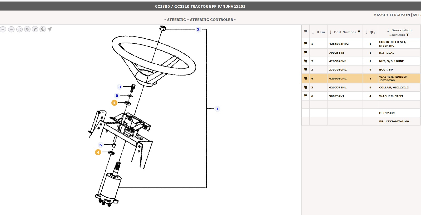

Part number is correct. While you have things exposed, check the key switch for corrosion on the bottom, and clean up the connectors in the fuse box.
   / GC2310 steering wheel loose - rubber bushing replacement #12
There are also metal bushings that go inside the rubber washers.
The new ones were a little shorter than the original ones.
If you get some sheet rubber the right thickness, you can make your own washers for a fraction of the the ridiculous price from MF.
Use a hole saw, to cut them out of the sheet.
And yes, you can replace them without taking the wheel off. It is tricky, but possible.
One helpful hint is to use something sticky to attach the washers, and the bushings to the rubbers. I used a very small piece of butyl tape. Then, you fish the washers into place with anything that gets it done. Once in place, use an awl, or thin metal punch, or rod to align everything with the hole.

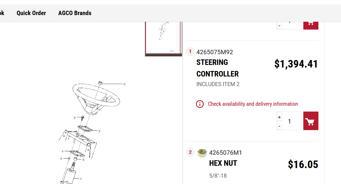

orbital valve for a 2010 GC2400 runs 1400$.
   / GC2310 steering wheel loose - rubber bushing replacement #20
Thanks.
"Check availability and delivery information", is manufacturer speak for, the product you need this part for, is more than 10 years out of production. So, since we are no longer "legally obligated" to provide you with parts, we aren't going to stock it, and you are probably sol.
I hope I am wrong. But, I have seen this far too many times, to be optimistic.
It's also possible it's superseded by the later version. They should put that information on there, if it's the case.
