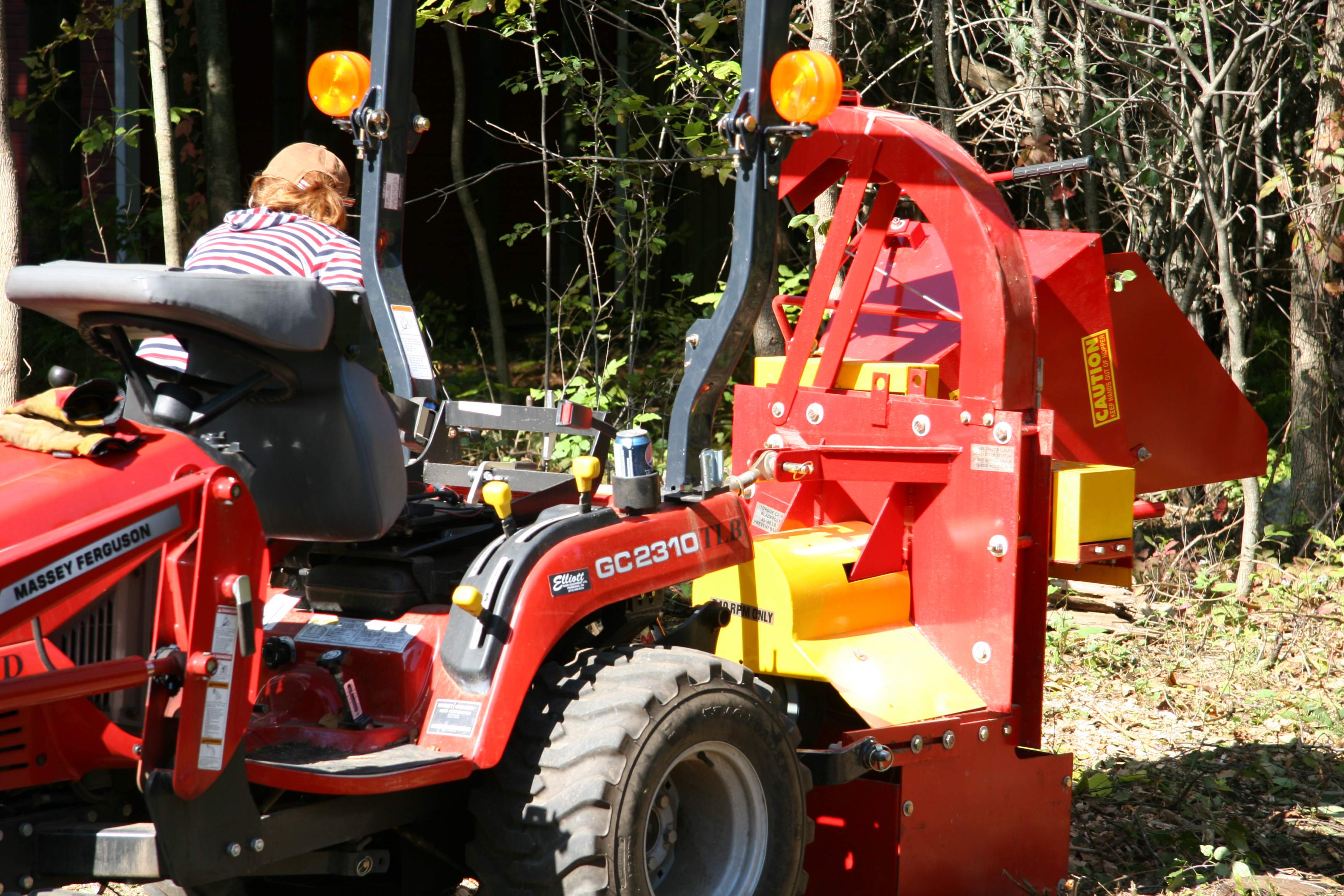

Well I have decided to bite the bullet, Picking up the Jinma 6" chipper Friday.. A days assembly, and will see what happens.. :rolleyes:
I know that North American chippers are more sturdy but can justify over twice the cost, Maybe if I was in the business of cutting trees for others.
Pictures to come..

66chevelle,
Did you get that chipper assembled and working yet? I'm also curious as I have a 2300 and have been eyeballing those jinma's. Most of my brush is sage and scrub oak of 2" and less..
   / GC2310 wood chipper.
#15
Sorry for the delay in responding.. After spending full day un-crating , assembling and adjusting the chipper. All I can say is wow.. I had wished I purchased 2 years ago.. No more shoving 2" branches into a yard machine.
The only thing that makes me nervous it the speed I have to engage the PTO at. (or risk stalling the tractor) IMG_1388.jpg
As far as the snowblower it's a Argo trend C-54. Yes I would purchase again, With just a few more sear pins this time..
