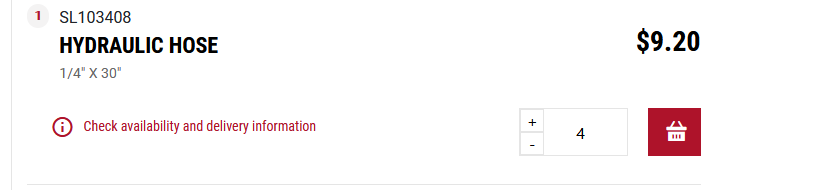

agco parts list for dl100 lists all 4 hoses being same part SL103408 online price if you have edealer I don't) is 10$ so prob local dealer around 18$ or so each.

fwiw manual for gc24xx says 1/4 inch by 30 inch hose. does not specify ends but I had bought some earlier and think I still have packaging for specifics. will look later tonight.
