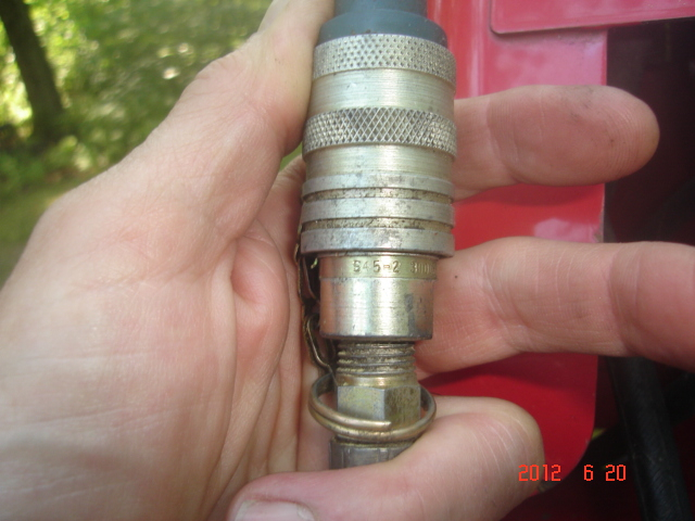

Yes still has a slight leak. Even took it to the dealership and all they did was clean them up a few years back.
Did the clean suggested here and it's still leaking.
The part must be the Safeway S25A-2 (it's the match for the S41-2 which I could order from Graingers for half of the dealer price.)
I called my local industrial supplier and they have a non-Safeway size match set for almost half of Grainger's price. At that price, I might as well give replacing it a go...
My only questions at this point: What to expect when removing either side of the coupler from the tractor/FEL lines? What kind of fluid escape can I expect? Any tips/tricks for working with hydraulic lines/fittings?
It looks like trying this with the FEL attached would be a nightmare... (just thinking out loud..)

All solved. Turns out the local vendor and their "New Line" hydraulic supplier sent me the exact same OEM coupler, Safeway branded and all.
The cluster of couplings for the FEL meant I need to take off one other coupler to get good box wrench access. In doing so, I found what could have been teflon tape or sealant at the bottom of the threads. I replaced both without any sealant and no leaks so far. Cost with shipping was the same as MF dealer cost before shipping. And of course, the ever-present supply chain inventory problems did add a shipping fee to get it to my local shop as the only coupling around was at another shop hours away.
Now: how do I pop the mat up from that side to get all the hydro fluid under it...? Are those buttons the xmas-tree fasteners used in vehicles?
Oh, and just turned 100 hours (new hours) since I bought it two years ago.
   / GC2410 FEL Hydraulic Connector Leaking Fluid #23
Yes, I believe you're correct, those mats "pop" off. Been a while. As far as hoses, I've just gone to a local auto parts shop and they've been able to make up new hoses, connectors & all. Replacement hoses significantly heavier-walled than OEM hoses. And you're right, Safeway S45-2, same as on my 2310.
