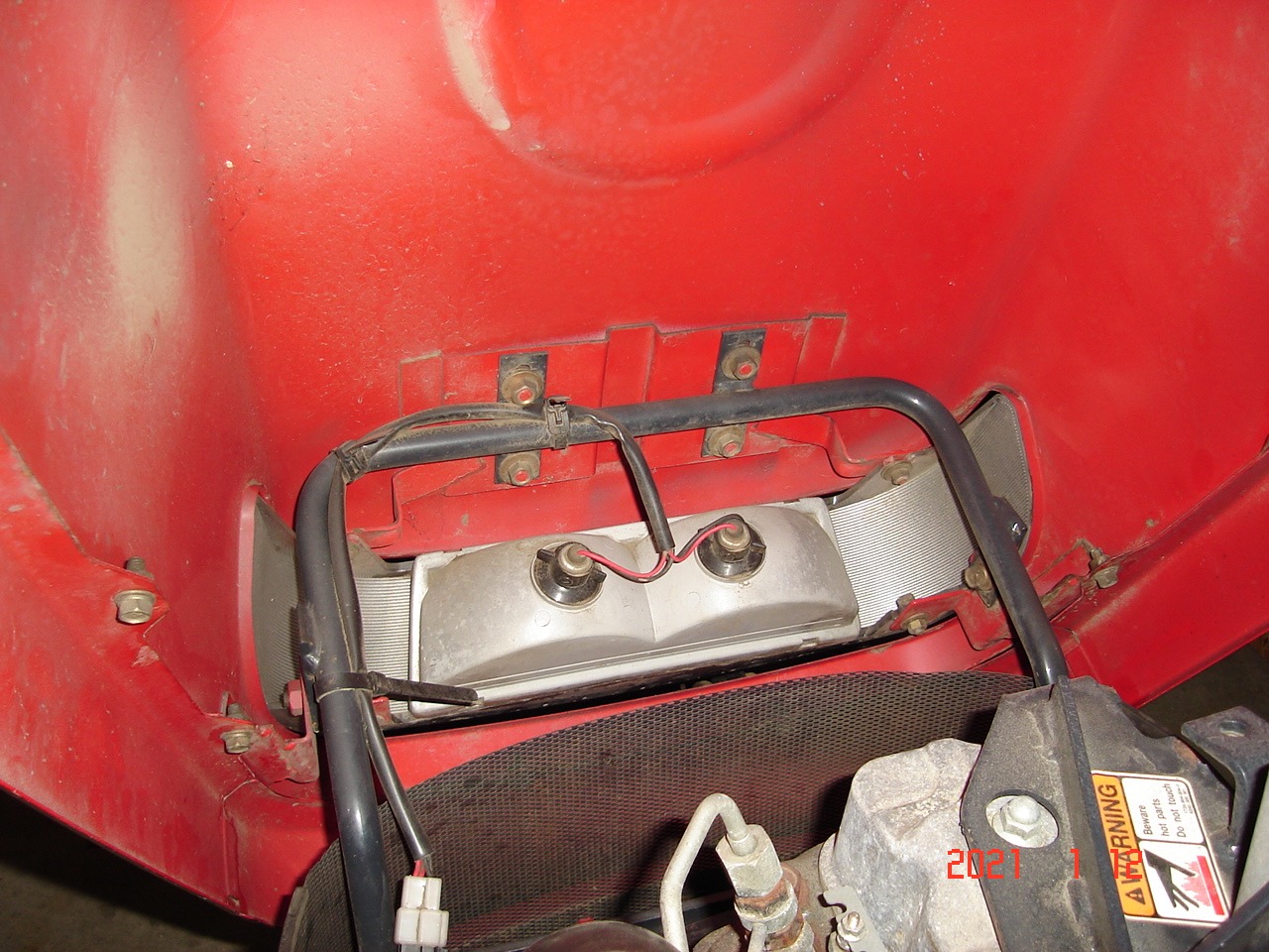

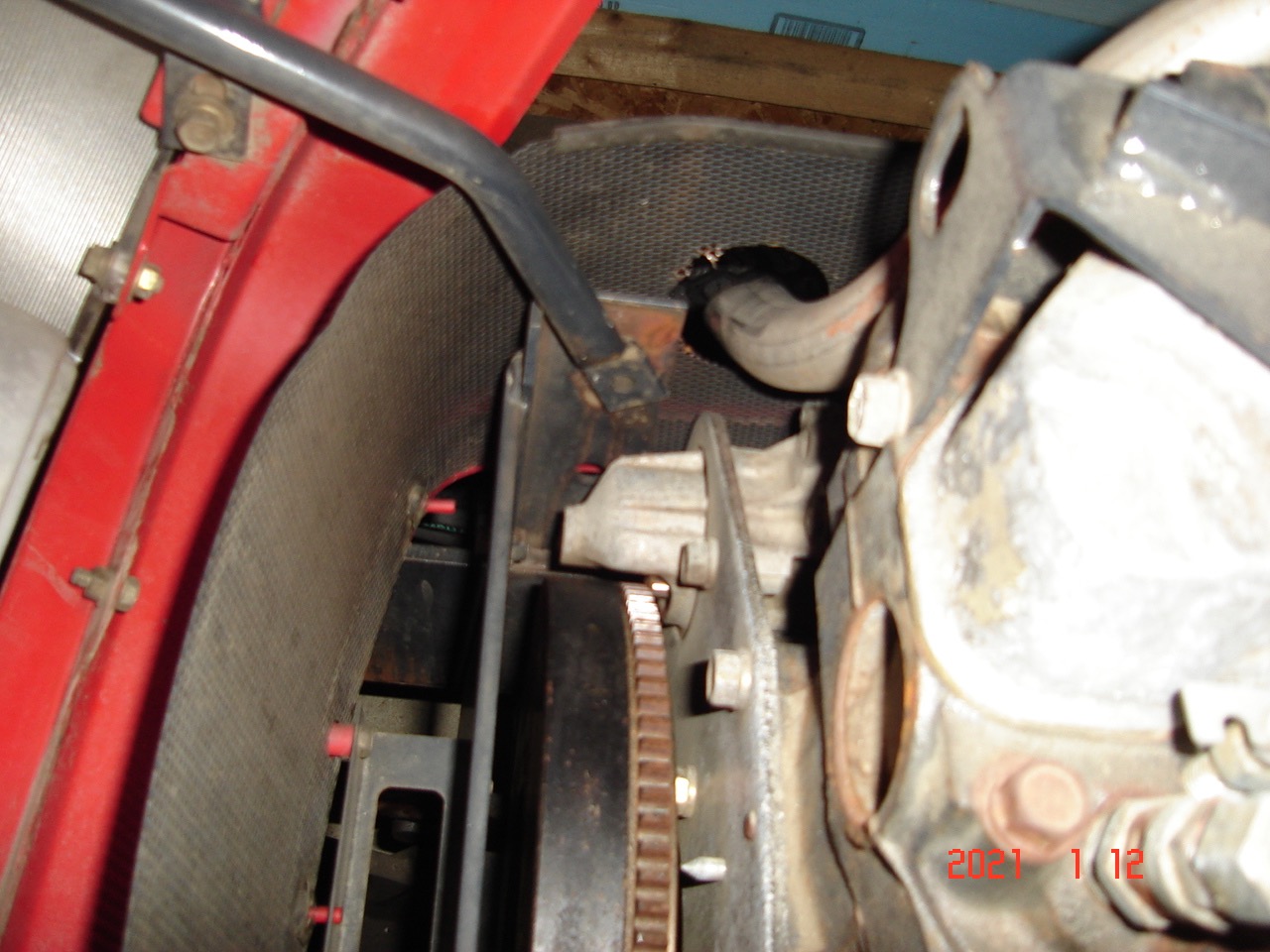

Here's how mine's bolted -- 4 bolts (I should say, nuts -- they're on studs that protrude from the hood) on the under-hood brackets, two hinge bolts down by the black grille. They probably use an elastic stop-nut on those hinges so it can still move but the nuts stay put; sounds like one of yours may have come off.
Where you at in NH?

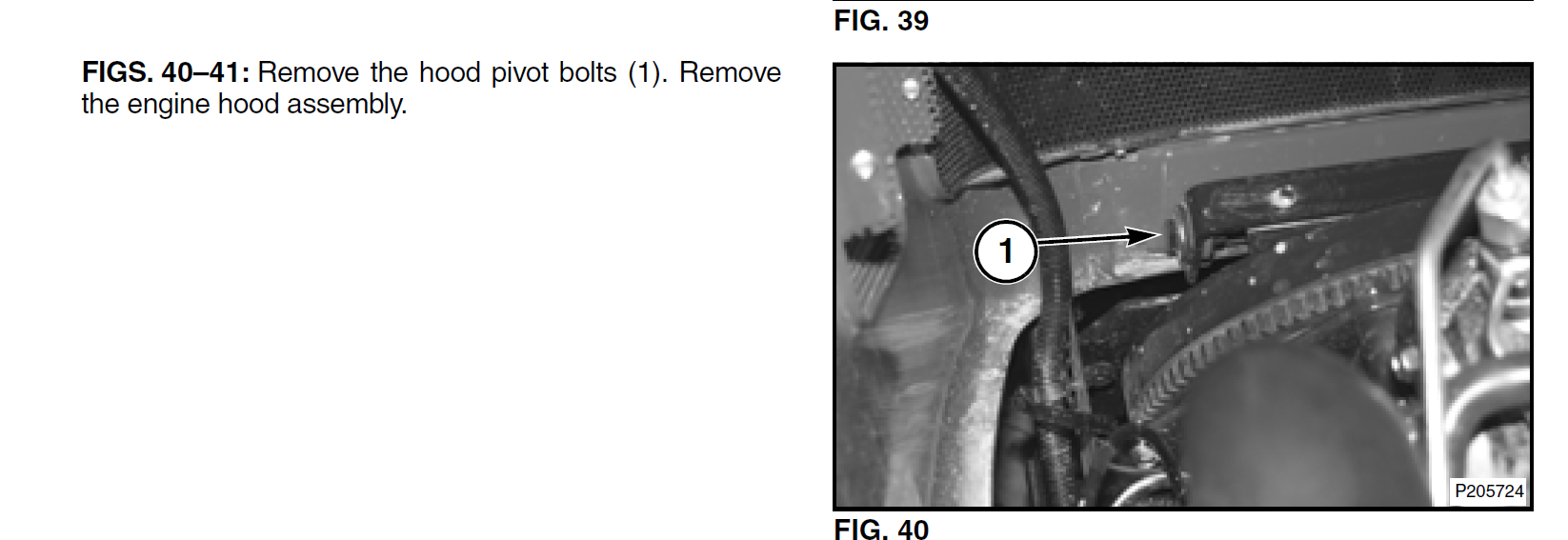

2010 GC2400 hood
2 bolts in from side separate hood from tractor 2 bolts from underside sep hinge.
attached is page 37 of service manual (eng removal section) showing removing 2 bolts for hood.

Thank you, I think this is the set up I have, so I am thinking my bolts came off or snapped, now that I know a little more of what I am dealing with thanks to your great photos I can proceed in repairing it.

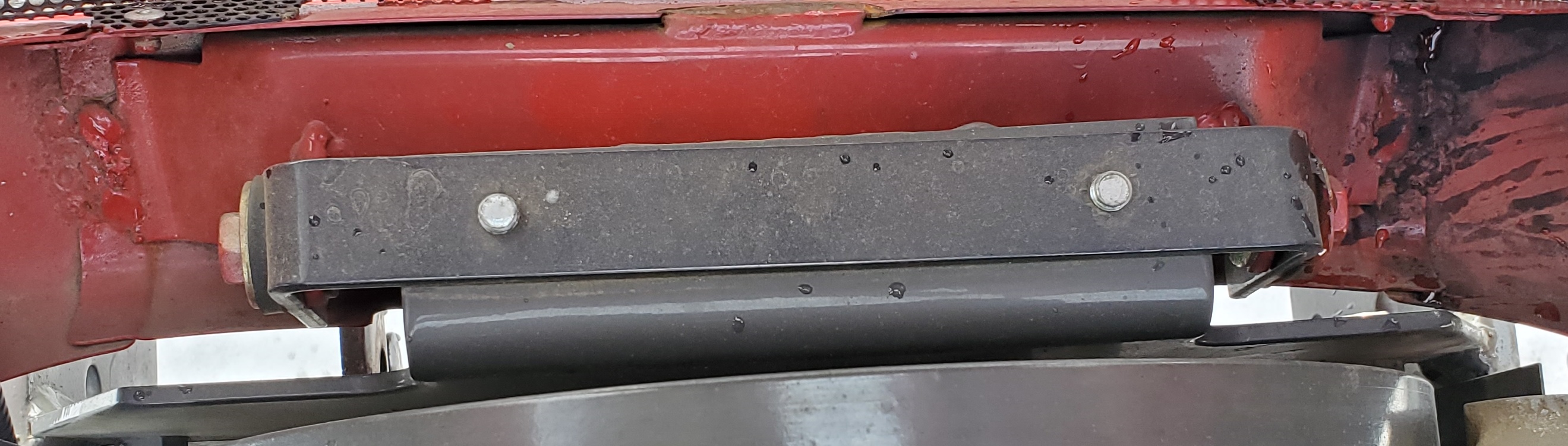

Yours set up is different than mine, the comment below with pictures is what mine looks like. Thank you for taking the time to show me all that
I am in Mason NH, Home of the famous Parkers Maple Barn.

prob the differences between gc2300 and gc2400 series.
don't have a 1700 series in yard right now but think it uses setup similar to the 2400 pics I posted but don't hold me to that.

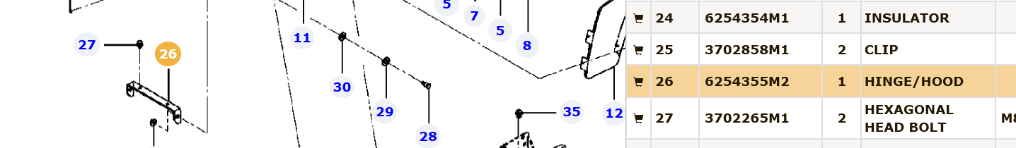

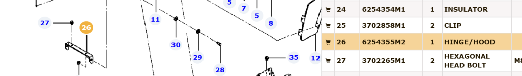

if hinge is broke for gc2400 hinge part number is 6254355M2
