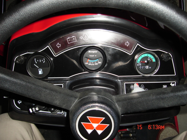

You're right -- I forgot that the 2400-series was the first real change to the GC designs. Mine's one of the last 2300-series tractors. Wish I had your gauge cluster - the one that has a single plastic cover! (Mine's a real PITA to keep clean while blowing snow, with the separate teensy gauges...)
   / GC2410 Hood
#20
This is the first tractor I have owned, I guess I am happy to hear my cluster gauge is not an issue! That would drive me nuts especially with tiny gauges. Maybe you can create a cover to protect it, you know the saying Necessity is the mother of invention, might be some idea that is simple enough to do.
