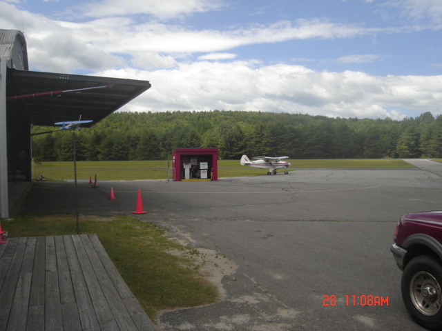

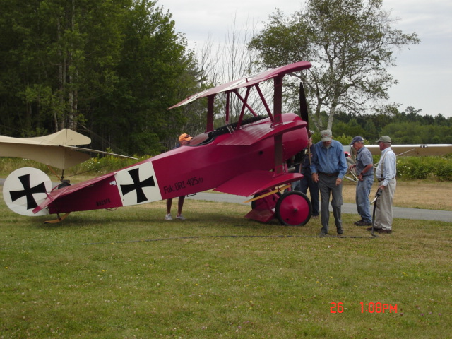

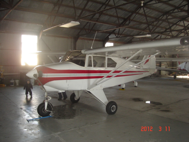

:laughing::laughing: Well, maybe, Ray. Not this summer, however... spent LOTS of hours at the airport trying to bring my PA-22-150 "up to snuff." It had lots of little issues that I discovered as I went over it with a fine-tooth comb after I bought it. Folks didn't see me much at home, for sure. On the bright side, it passed its annual! :cool2:
Oh- third pic is not mine... a replica at Owl's Head Transportation Museum in Maine that we watched take off and fly around. (Did manage to get away a couple of times this summer.)
Walt
