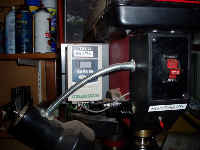

   / Gear motor for drill press #36
The drill press shown on the roguefab website is exactly the same as the one I converted using an inverter drive and a 3 phase motor.
I think the inverter drive is a much cleaner solution and gives me a much wider speed range than the jackshaft setup, plus giving me the ability to reverse the spindle.

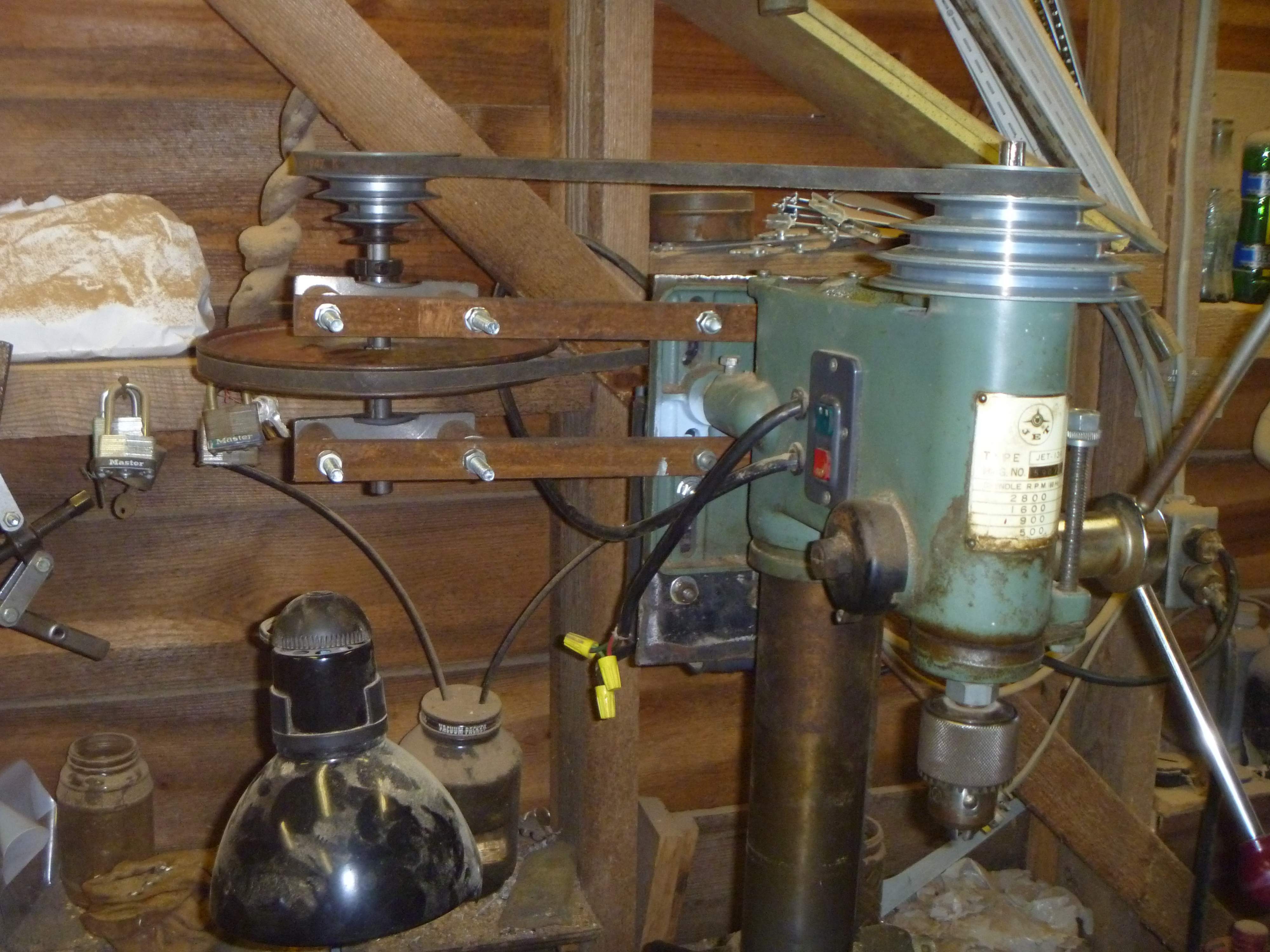

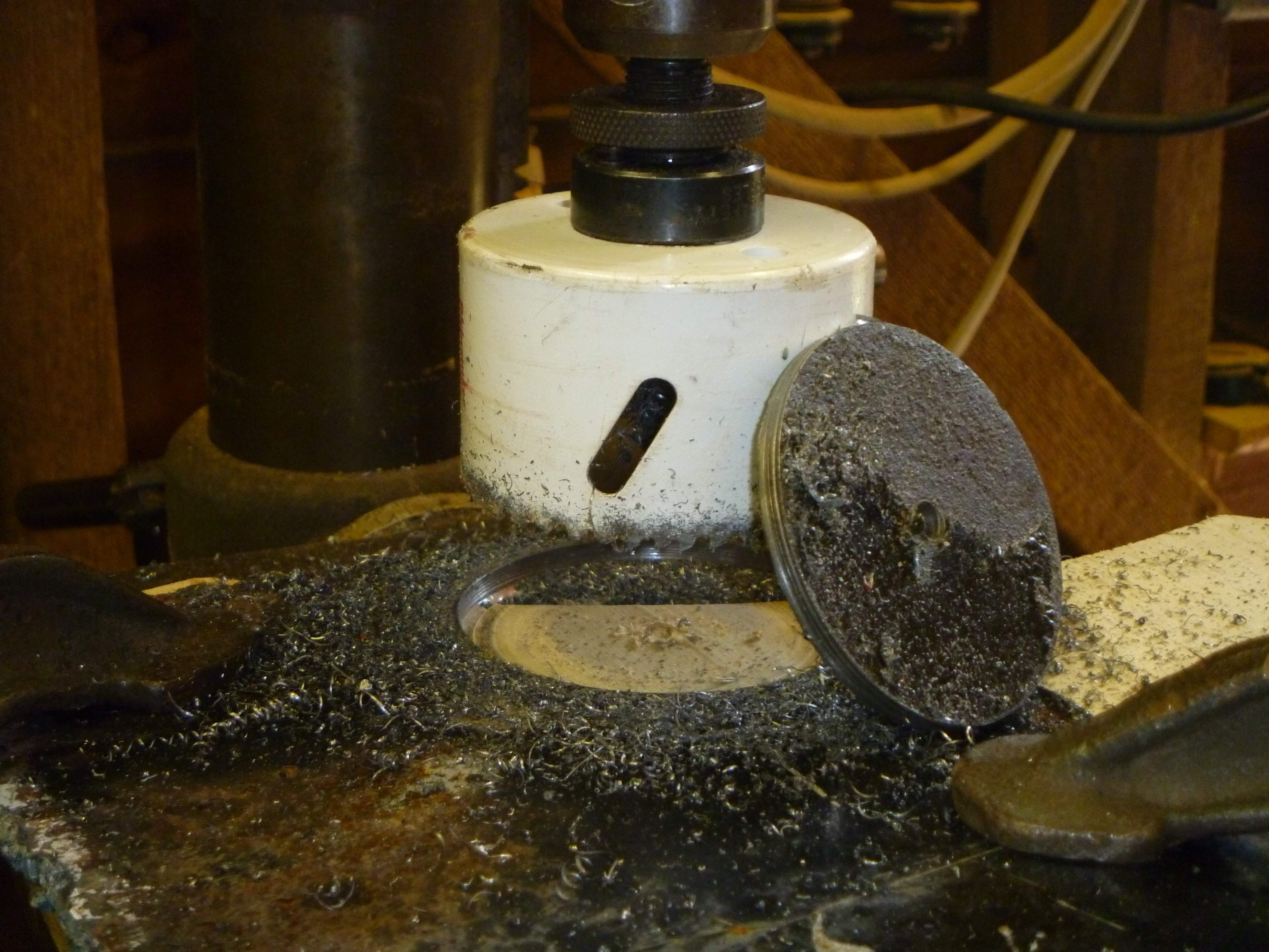

#40
I finished the jackshaft installation. The 5/8" keyed shaft is supported by two 1/2" x 1" steel bars. I get a 4:1 speed reduction giving rpms between 135 and 750. The only problem is belt slippage when sawing a 3" dia hole in steel and occurs on the smallest pulley (1.67" dia) on the cone above the large idler. There is no chatter when drilling but the slippage limits the torque; it took about 15 minutes to saw thru the 1/4" plate shown but it saws very cleanly. I've got the belt pretty tight and am afraid to tighten it more because the shaft is only 5/8"; I probably should have used a 1" shaft. The belts are old ones I have taken off old equipment so they may not have adequate friction. Would belt dressing help?
Bob
