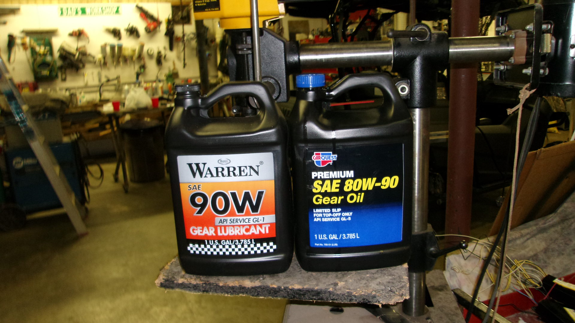

Warren is the same company that makes the mystery 5 gallon yellow bucket hydraulic fluid with 20 year out of date specifications. AP-1 on left AP-5 on right.

and your point? I didn't say it was not available ??
it's up to the purchaser to purchase the correct material. not purchase the wrong stuff then blame the botteler..
